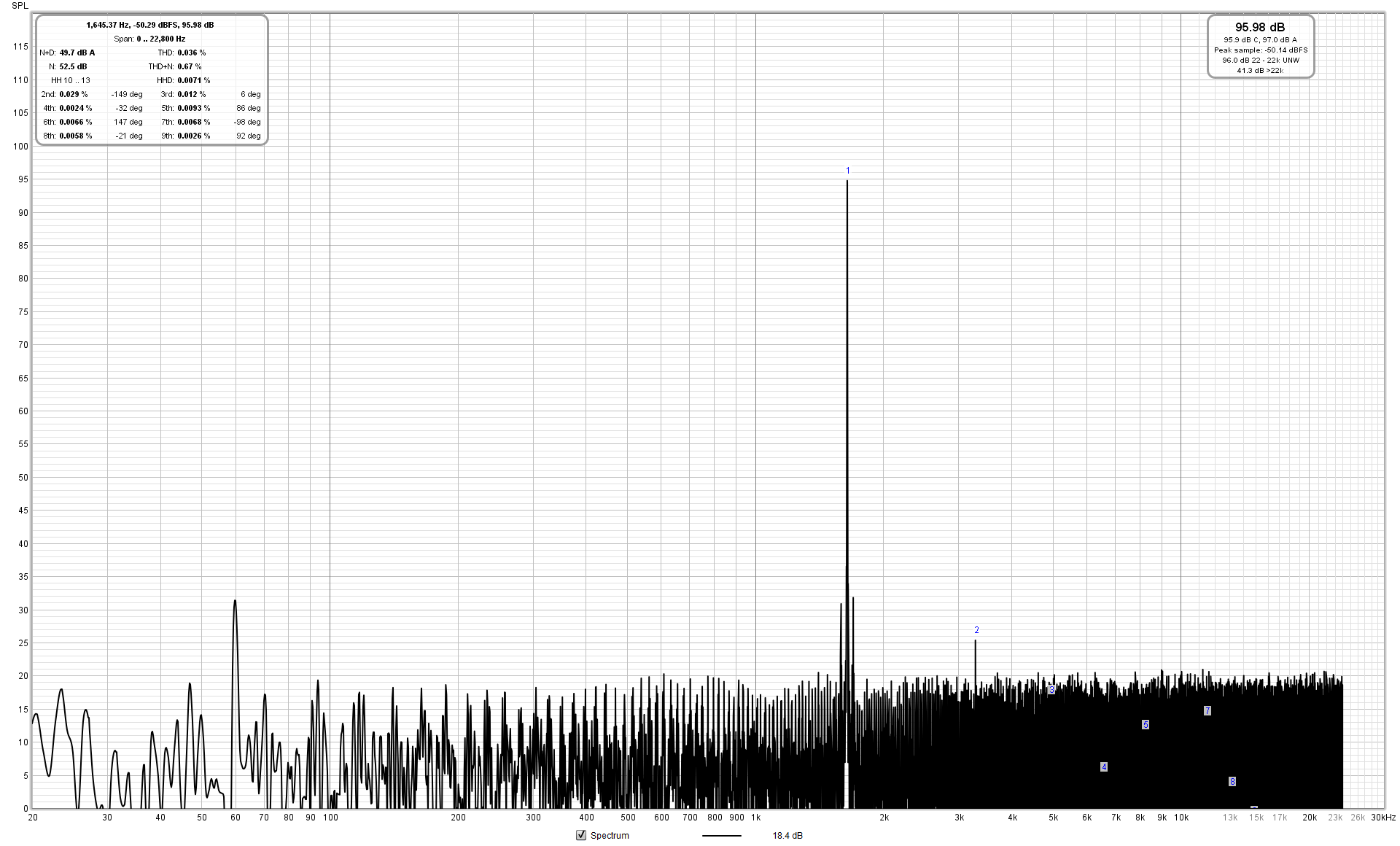

I rechecked my connection to the soundcard/PC processing FFTs. After some fiddling, I removed the plug and clamped my leads directly onto the wires. The FFT results improved... considerably. See attached.
I am prepared to accept egg on my face for however much of this problem has been caused by my poor FFT connection. Still, we caught at least one bad wire, and possibly incorrect wiring across one or both tubes.

The wiring you illustrated with the PDF is not particularly "tidy" (to be kind). Blame Heathkit and the original kit builder.I rechecked my connection to the soundcard/PC processing FFTs. After some fiddling, I removed the plug and clamped my leads directly onto the wires. The FFT results improved... considerably. See attached.
I don't know where you go with the noise floor. Is it as bad as it looks? Run the FFT with more averages.
Post #43 spectrum plot may benefit from using many averages and a longer FFT length - as that should lower the noise floor to allow the harmonics to be better observed.

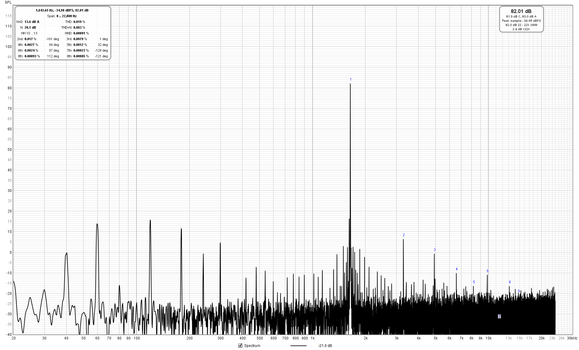

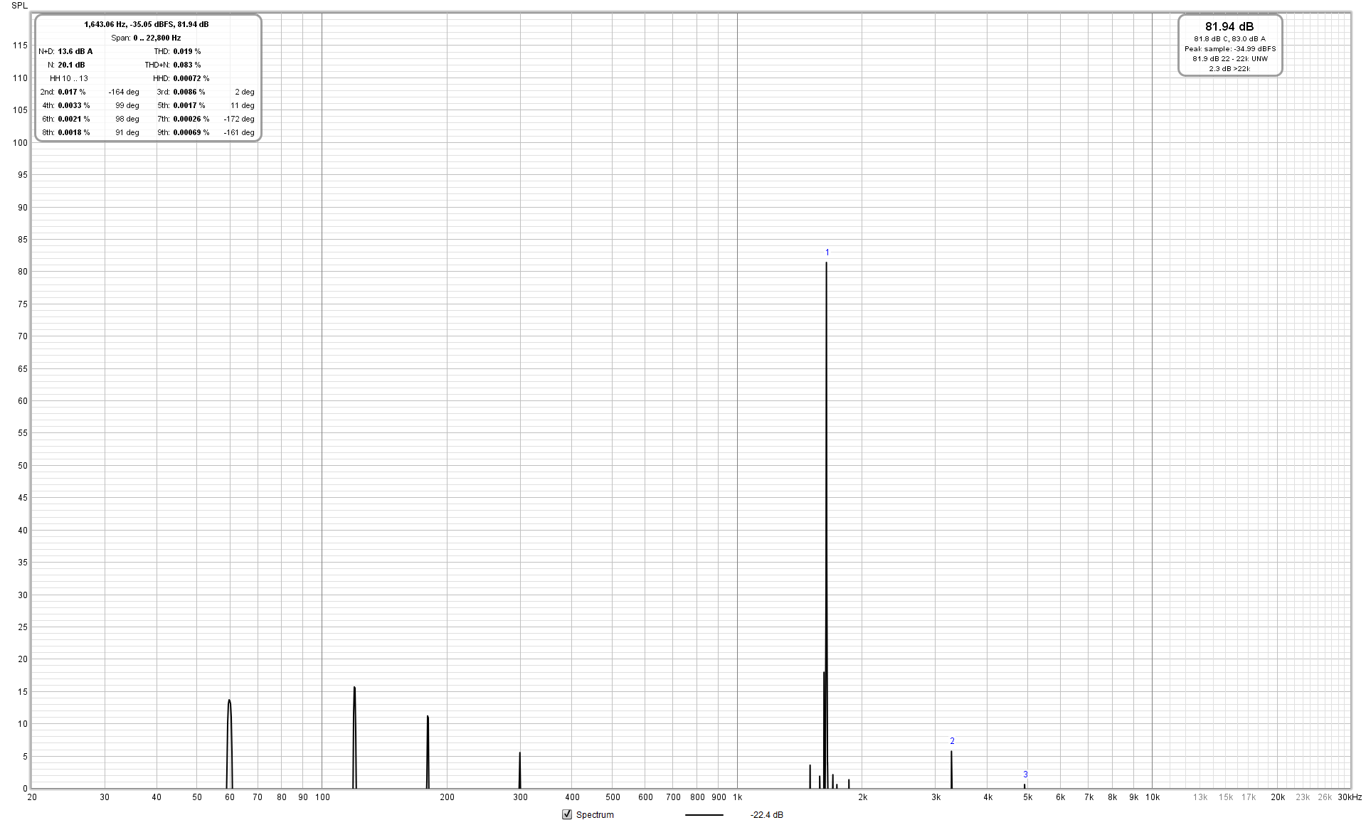

I played around with the input device settings on my laptop. Even with the input always coming from my Focusrite Scarlett, simply choosing different input device selections dropped the noise floor by 40dB. See attached. One is at the same scale as my last graph, the other has been extended to -40 to show the new noise floor.

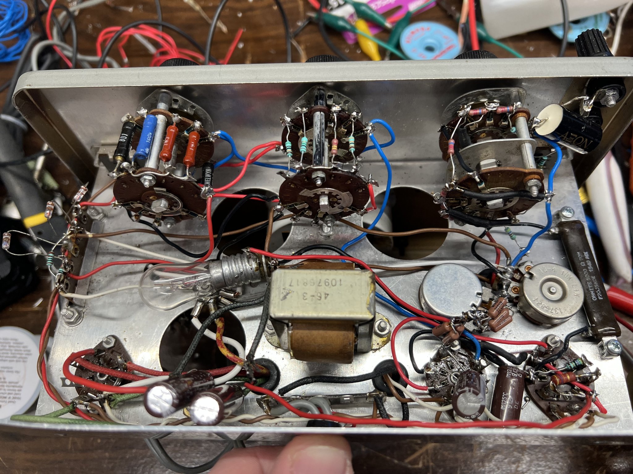

See attached for my final "professional quality" wiring job. I do think it's cleaner than it was when I got it at least.
