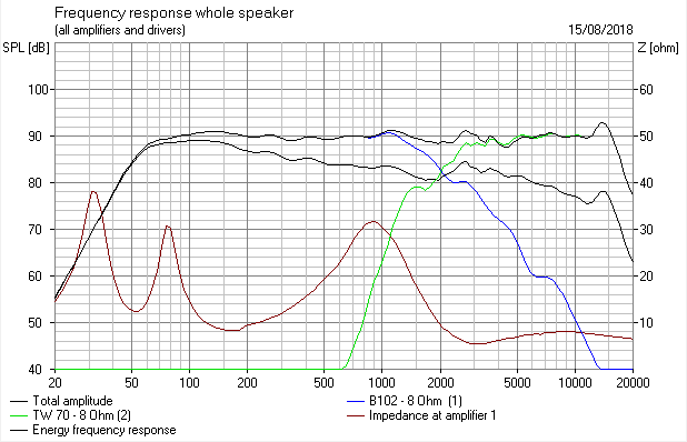

I used the B102's published specs in WinISD and got a ported tuning at about Fb = 55Hz, with a predicted F3 of about 50Hz.
You tuned it to Fb = 25Hz in a 60L cab with 25cm baffle width, or am I misunderstanding what you wrote?
I didn't know what I was doing on the tuning or box. I looked up some recommendation on the webs.
But going for your 30cm width in a tower of 65L and 55Hz tuning, it is starting to fall into place. Woofer is 20 cm from the top. Tweeter below. Is that how Zu do it?

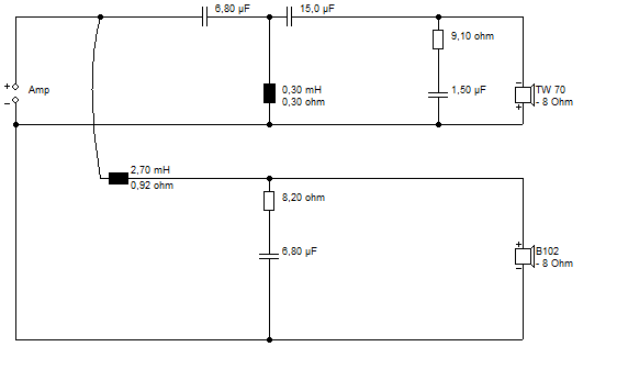

Looking through the accumulated parts, I find I have a pair of air-core 1.8mH 0.8R and a pair of 1.2mH 0.6R. Put them in series and I could get 3mH 1.4R. Is that workable, or do I absolutely need to purchase a pair of 3.3mH coils?
Wait... 2.7mH? Lemme see...
I have a pair of iron core 2.1mH and a pair of air-core 0.62mH.
I always look at a redesign when I am missing some component. Which is not to say you can't use that improvised 3mH coil.
The impedance corrected circuit that gets to much the same place on FR is below. Now I did only spend 5 minutes on that, so it's rough and ready. But I think you have most of the parts.
I might have all the parts.
I think the first thing to do is to get the woofer LPF filter sorted. Let's see if I can kang that together and give a listen to one, checking for evil peaky sounds.
I don't know if I can upload these FRD and ZMA files...but I'll have a go.
I did these with the SPL trace in VituixCAD with a png image of the Eminence plot.
Speaker Detail | Eminence Speaker
VituixCAD is not my idea of easy to use, so I preferred the Boxsim simulator which I know pretty well.
I then imported them into Software | Visaton over a similar W250S-8 10" driver in a defined common enclosure. I guessed these were infinite baffle measurements. I adjusted Fs, Qes, DCR and Qms and Vas for the Eminence.
You might try these files. Become a light unto yourself, an' all that. Default 90Hz is good for 90dB in the Visaton import dialog, I reckon. Seemed to get level about right. This comes with no guarantee whatsoever! :D
