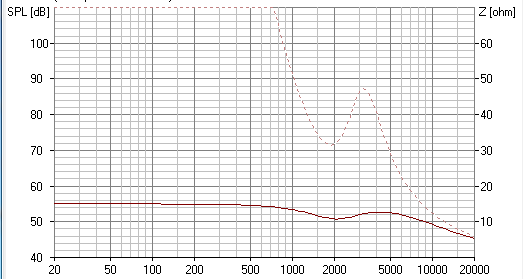

I have amazed myself and got some sort of sim of the B102 working! 😎
That is cool!
I need to find a couple of 3.3mH coils...
The 1.8mH/8.2R+12uF comes out a bit bass light on 2kHz crossover.
I think we need a bigger coil here. Here's what I get for 60L tuned to 25Hz on a 25cm. baffle width, which is a wild guess in itself. I am, of course, waiting for the horn expert to tell us how to do that part.
I don't know if it helps, but the actual cabinet in question is more like 30cm baffle width, and slightly larger volume, more like 65L.

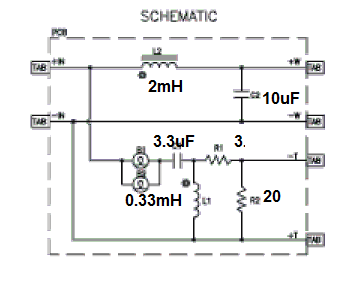

Looking through the accumulated parts, I find I have a pair of air-core 1.8mH 0.8R and a pair of 1.2mH 0.6R. Put them in series and I could get 3mH 1.4R. Is that workable, or do I absolutely need to purchase a pair of 3.3mH coils?
Wait... 2.7mH? Lemme see...
I have a pair of iron core 2.1mH and a pair of air-core 0.62mH.
I always look at a redesign when I am missing some component. Which is not to say you can't use that improvised 3mH coil.
The impedance corrected circuit that gets to much the same place on FR is below. Now I did only spend 5 minutes on that, so it's rough and ready. But I think you have most of the parts.

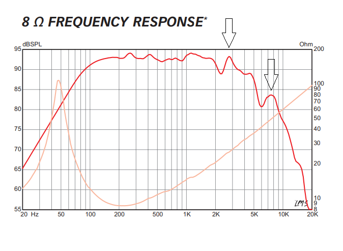

I don't know if I can upload these FRD and ZMA files...but I'll have a go.
I did these with the SPL trace in VituixCAD with a png image of the Eminence plot.
Speaker Detail | Eminence Speaker

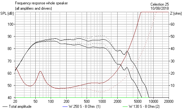

VituixCAD is not my idea of easy to use, so I preferred the Boxsim simulator which I know pretty well.
I then imported them into Software | Visaton over a similar W250S-8 10" driver in a defined common enclosure. I guessed these were infinite baffle measurements. I adjusted Fs, Qes, DCR and Qms and Vas for the Eminence.
You might try these files. Become a light unto yourself, an' all that. Default 90Hz is good for 90dB in the Visaton import dialog, I reckon. Seemed to get level about right. This comes with no guarantee whatsoever! 😀
