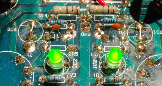

I thought about the bias of the 6N3, and tried some LEDs out in there, finding out that below 3mA they do not have much dynamic conductance. I paralleled another 100k to make the anode resistor 50k, and read the 6N3 load lines again. This tube seems happiest at -2V bias, so I picked a couple of green LEDs and used those - I get (on 220Vac input) 346V before the anode resistor, 140V on the plate (= 4.12mA), with 2.16V on the green LEDs.
I also thought about the 220uF feedback coupling cap - it just takes the DC out which yes - is a bit pointless given the toplogy so that went.
The feedback resistor is 2k, the leg resistor is 33R, I plan to add a small stereo pot to the back of the amp (maybe 1k) between the 8ohm output and ground tapping off the wiper as the feedback, so I can choose between 100% normal feedack to zero feedback at will.
Mod II Summary - 6N3 tubes:
So the sound with this new mod is particularly awesome, punchy, clear, neutral, addictive to listen to. Katie Melua (one of the few well recorded CDs today) and Lily Allen sound very very good indeed.

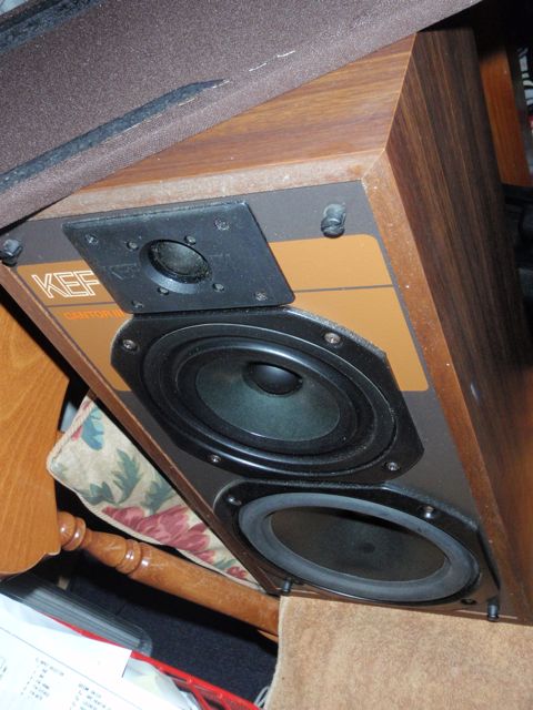

My test input is a iPod Touch plugged into the MP3 input jack and speakers are some old Kef Cantor III units which sound better than they ever have. The Peach is so peachy in fact the only thing on the list now is variable NFB.

- Change anode resistors to 50k
- Remove 1k cathode resistors
- Replace 220uF cathode cap with green LEDs
- Replace 220uF feedback capacitor with wire

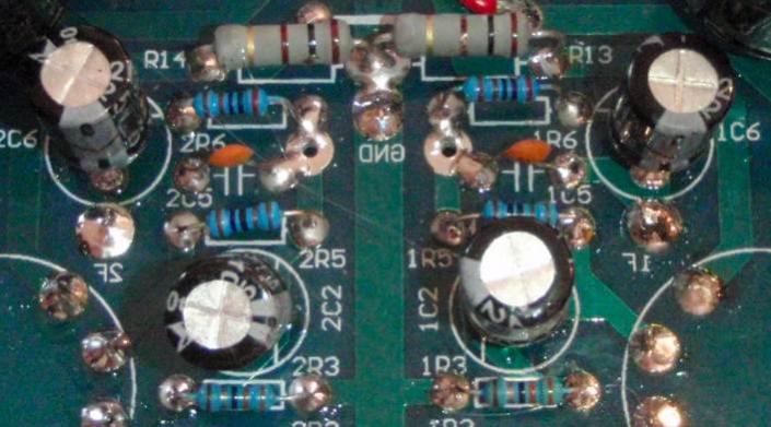

For negative feedback look carefully at the 8/4ohm impedance switch at the back, and the shielded wires running under the PSU board - that's NFB from the 8ohm tap.
In the attached photo I'm name the FB components (right side only - some text is mirrored on the PCB):
1F - the wire from the 8ohm tap arrives here
1C6 - 220uF series capacitor with 1R6
1R6 - 2k resistor forming upper part of bridge
1C5 - tiny cap straight from 8 ohm tap to bridge centre (RF/stability)
1R3 - 33 ohm from GND to bridge centre - lower part of NFB bridge
Incidental components (this is an old photo as it will match yours better)
1C2 - 220uF bypass cap
1R5 - 1k cathode resistor
R13 - filament balance to ground

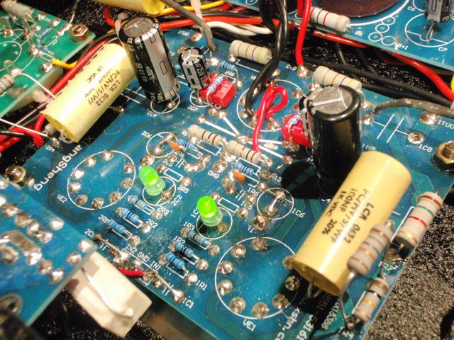

I tried a little mod tonight that worked quite well, I'm not sure it's better than before but it's certainly no worse so see how it grabs you.
I unsoldered the feedback wire off the driver board, lifted the FU50 10R cathode resistor from ground and connected it to the feedback wire instead (8 ohm tap). I had to add a full turn of each bias pot to restore the FU50 bias back (to 57mA at 220Vac). I want feedback because I want to drive regular speakers - I'm not sure there is enough but it sounded fine. Can't do A/B tests for this. Overall gain went up with this mod.
As there is enough gain on the 6N3s I decided I didn't need the LEDs anymore, so I put back the 1k resistors instead and changed the anode to 100k again. No bypass capacitor needed.
This also gives a tiny bit of local feedback or degeneration as my FB mod removes any feedback from the first two stages. Also a resistor is perfectly linear - I'm sure my LED was good, but not that good
The 6N3s bias is now at 2.4V whereas my target was 2V, but reducing the anode resistor would also reduce the degeneration so I left it.
Next stage is to remove the ECC82 bypass capacitors too, I didn't think of doing that in the workshop but I'll do it next time I'm in there. It's funny to think that I would have eliminated 3 220uF capacitors per channel by then

The driver tube cathode bypass capacitor should not be required with LED bias. From the photo I thought it was removed already. With cathode resistor it should be left in place in order to have a low impedance drive.

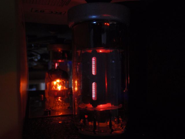

The power-on flash of the Mullard ECC82 is no reason to worry about. It is typical of many European tubes.

Thanks for the input Svein, I think I need to describe the current circuit better!
There is no global feedback now, just the 8 ohm tap feeding into the FU50 10R cathode/bias check resistor.
The driver ecc82 still has a bypass cap.
The input 6N3 now has the 1k cathode resistor. No led and no bypass cap.
Could you tell me how to calculate the feedback in dB? Thanks!

Current sink
As for sending current into the OPT - this works out as:
Speaker load (5.8R - Cantor IIIs), OPT output winding 0.8R.
At 60mA total voltage will be 0.06 x 0.7R = 42mV, giving a current of 7mA through the speaker.

OK so as I'm a bit swamped with other things to do I though I'd procrastinate on those and play with my amp a bit more.
I can't say for sure if it sounds better than my ModII stage mods, but it sounds very good with perhaps a little sweeter at the top end, although that may just be a touch less treble or my ears. Until I put a better source through it I'll not really know.
The scheme now is:
6N3 tube with 100k anode load and 2.2k cathode resistor, Vgrid = -4V. This gives is some local degeneration and stays in a good place on the load lines, Vanode is 175V. No bypass caps, no LEDs.
ECC82 with 1.5k (2.2k parallel with 4.7k) cathode resistor. No bypass caps, no LEDs. Vgrid = -6V.
Feedback wires connected to FU50 10R grid resistors. Bias 57mA.
From my Mod II stage I would expect more basic distortion (although maybe not much more as the overall gain is the same) but this moves the feedback to where it is needed - the output stage. The only way of increasing FB (from 2.5dB) here is to have a 16ohm tap or to connect the FU50 in pentode mode, both of which are options but the latter rather easier to try!
However the key with eliminating loop feedback is much lower intermodulation distortion, which is caused by temporal distortion products. I.e. in a regular amp the NFB is too late to correct fully, so the correction itself is corrected - and do it goes round spiralling into the noise floor. Even top amps regularly have the NFB look cover 4-5 stages, which is quite tragic.
This is why local feedback of degeneration was my chosen method - the bias points I chose seem to work out well in the compromise between linearity, drive impedance to the next stage and gain.
I think I need to try it with some decent speakers next - the Usher X-718 which are so much better than the Kefs it's difficult to describe. How they are to drive from my new SET however I have yet to find out . This step requires domestic integration, which means the base cover on and the amp the right way up again...
