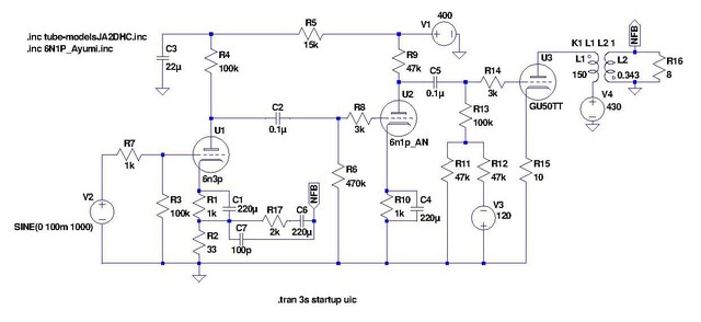

Trying to make sense of the Sweet Peach
Attached is the original schematic i found here.
Can anybody has a final updated modified schematic for us as reference?

Basically this is what I ended up with and am very happy with it
It's a significant mod though, involving a new top plate for the smaller tubes.
It's also controversial as it dispenses with the ridiculous obsession of including the phasey band limited OPT within a huge global feedback loop which IMO is the absolute last place an OPT should be.
The problem with the OPT inside the GNFB loop is the areas the need the most help are the bass and treble, which are also the OPTs points of highest attenuation, so those areas get the least feedback. IMO mild feedback is worse than no feedback. Additionally treble feedback around an item with phase delay is questionable for HF stability and therefore sonics.
So the whole concept of the change is to put a driver/pentode pair as a high gain high feedback OPT driver to drive the OPT with a low impedance and a correct waveform, and then let the OPT deal with the output itself.
This ensures fast, heavy NFB at the treble, mid and bass to _drive_ the transformer correctly, which then for my ears sounded a lot better.
The nice thing about SE amps if they're dead easy to mod, unlike push-pull which has far more components and less modding options IMO.

Finally got The Peach into pentode mode on the GU50s.
This involves driving a regulated G2 voltage of around 255V, which I tried before with some VR tubes - but every time I loaded them even a tiny bit they started oscillating - anything from 500Hz to 50kHz, which is easy to spot if you have a scope - but tricky without. Now I test everything with a scope and now it's very clean.
To stop the VR tube oscillations I used one of Wavebournes circuit ideas and put an IRF730 source follower in. It doesn't even need a heatsink and sits on a tiny bit of veroboard (the tab is live).
If you just connect up G2 you turn off the tube as well, as the usual 70V bias now changes to about 20V or so, so the peach needs the two earth side resistors on the bias circuit shorting out so one can re-bias.
With the current circuit B+ is at 420V, GU50 bias is at 60mA and there is only feedback between the GU50 and SRPP driver, plus local, no cathode capacitors are used. I still have a few electro caps to bypass but already it is showing massive promise. Pentode mode sounds better too, and I think this is because:

The tube lineup I ended up with was ECC88 (Amperex Bugleboy) input, Russian 2 x 6N2P-EV (for the SRPP) and Russian GU50 output tubes (Idling at 55mA, measuring 0.55V over the 10ohm resistors from pin1 on the GU50 bases).
SRPP precautions:
The upper SRPP triode for both channels are in the 6N2P-EV tube on the RHS powered by a floating 6V supply (Tiny potted transformer via a 4R7 ohm ceramic resistor) so as not to exceed the filament/cathode voltage. I used SRPP as it's easier than finding an anode resistor or making a current source for me, but any high gain driver would do especially as the GU50 is in Pentode mode so should be easy to drive IIRC.
The lower SRPP for both channels is on the LHS tube and uses the old heater supply as does the input tube.
