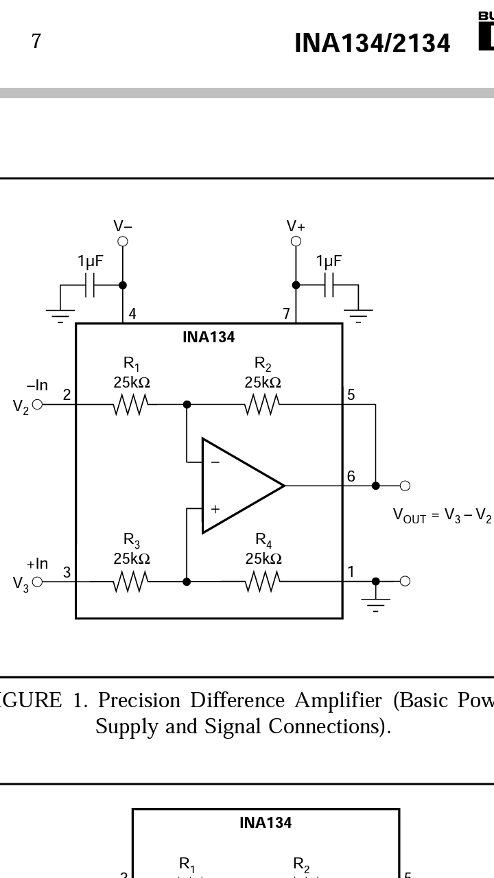

I followed the circuit diagram to a T and all i got was noise when i plugged it all in. i am running a balanced 1/4" output into the circuit and going directly into the amplifier board signal input with it.
what am i doing wrong?
I used the exact schematic on the Texas instruments technical document for line receiver. I used a 13.5 volt DC regulated power supply on the v+(pin 7)/v-(pin 4), they each have a 1uf cap going to ground...trs ring going into pin 2, tip into pin 3, tied pins 5+6, tied pin 1 to ground. Then used pin6 as the + output and pin1 as the sg into the amp board. I wasn't 100% sure where the shield should connect from the trs input. Need help with that one. Anyhow, I got nothing but noise out of the chip.

do you use a single supply? the ina - schematic is for dual supply.......

It only uses one power input to run the chip. The other inputs are the hi and lo signal inputs from the balanced output.
If you want useful advice you really have to give more details. Draw a complete schematic. Measure DC at ALL the pins of the INA. The whole power supply setup is very unclear - draw a schematic!
Where do the signals come from? Are the two signals on the inputs the same or are they in opposite phase? How is the connection to the chipamp done, what is the schematic of the chipamp? Does the chipamp work on itself, and how do you know?

Did I miss something on the explanation of what I did? I have a balanced output coming from an audio interface, of which I do not have a schematic for it, but I do know that it creates a typical balanced signal on trs with tip hot, ring cold, and sleeve ground. The hot and cold signal are out of phase as per any balanced output, then this ina 134 circuit (schematic posted) is supposed to accept the hot and cold signals, flip the phase of one, combine it with the other and noise will then be out of phase across the two and cancel out. Does not matter the details of the amplifier the signal is going into. The amp works fine on its own. It's the signal I'm trying to change.
There is digital noise on the ground coming into the interface from firewire and this circuit should in theory get rid of it just like the input on my powered monitors do.
Your answer to this question still concerns me. The INA134 is designed to run from DUAL power supplies, which would mean you should have +13.5V on the V+ pin and -13.5V on the V- pin. Or if running from a single supply you should bias the REF pin up to the mid supply point (13.5V/2) from a low impedance source (not a voltage divider) and AC couple the inputs.
An output from a DC power supply has a + and a - wire coming out of it. One is + 13.5 vdc, the other is - 13.5vdc. How would you need more power than that? Use 2 separate power supply units, run + of one to the v+ with - to ground, then the second unit run - to v- and + to ground? I'm doubly confused now!
