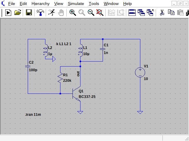

I am testing my first netlist that I created using LTSpice and its ability to export Accel nets. I converted the netlist into a ngspice file using my custom application. This is a single transistor oscillator which I designed using an RF transformer. The following code is the .cir file.

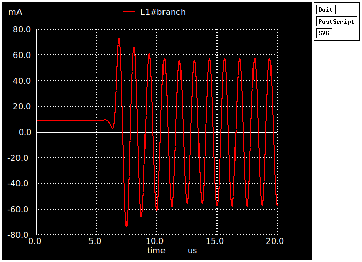

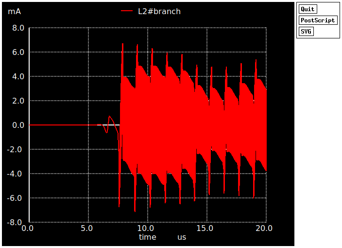

At this point I am comparing LTSpice with ngspice. Using the command "plot L2#branch" gives the attached graph. What is happening? Is this an ngspice bug? The graph implies there is a very high frequency acting on the base. I am also attaching a snapshot of LTSpice with the schematic for easy reference.
