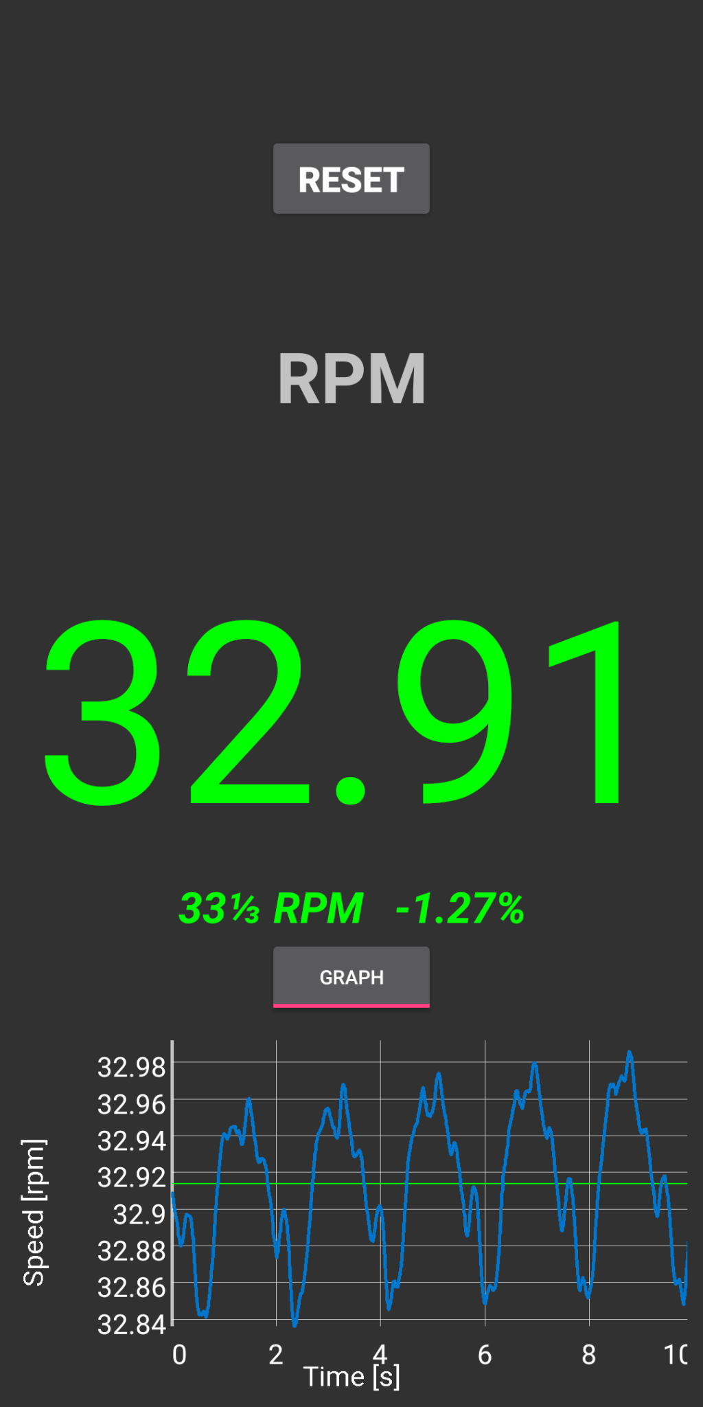

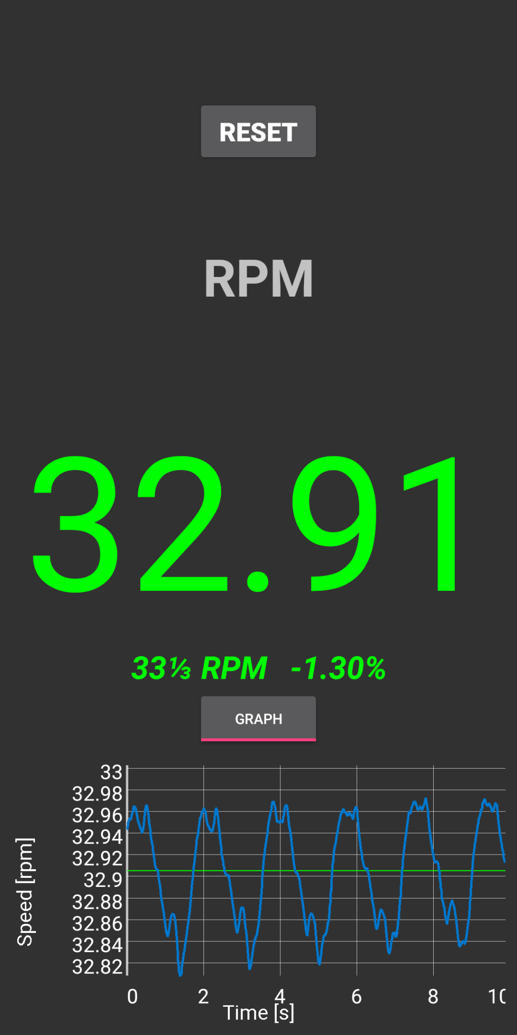

So some good news and some bad news... I took it to a hifi shop and bought a new belt. After trying 3 sizes, i went with the larger at 195mm... Though in my opinion it might still be too tight? It fixed the over speed problem... Except now its underspeed at 29.8~30rpm😅 Even at -1.5% i can still tell by ear that its slow :/ with each increase in belt size, speed increased by about 0.1rpm. Perhaps the belt will stretch and loosen up over time to make up the last 0.3rpm? I even properly cleaned and lubricated the motor and spindle... It made it 0.03% worse 😅 attached is before & after lube.
Now i'm worried that maybe lightly sanding the drive pully was enough to make it run under speed? If so, are new after market replacement drive pullies easily available, or specific to my exact platter? Maybe replaceable as a set? Or is it more likely the cheapest solution is just getting the belt tension exact? Should i go back to the shop again and pester them to exchange for an even larger belt?

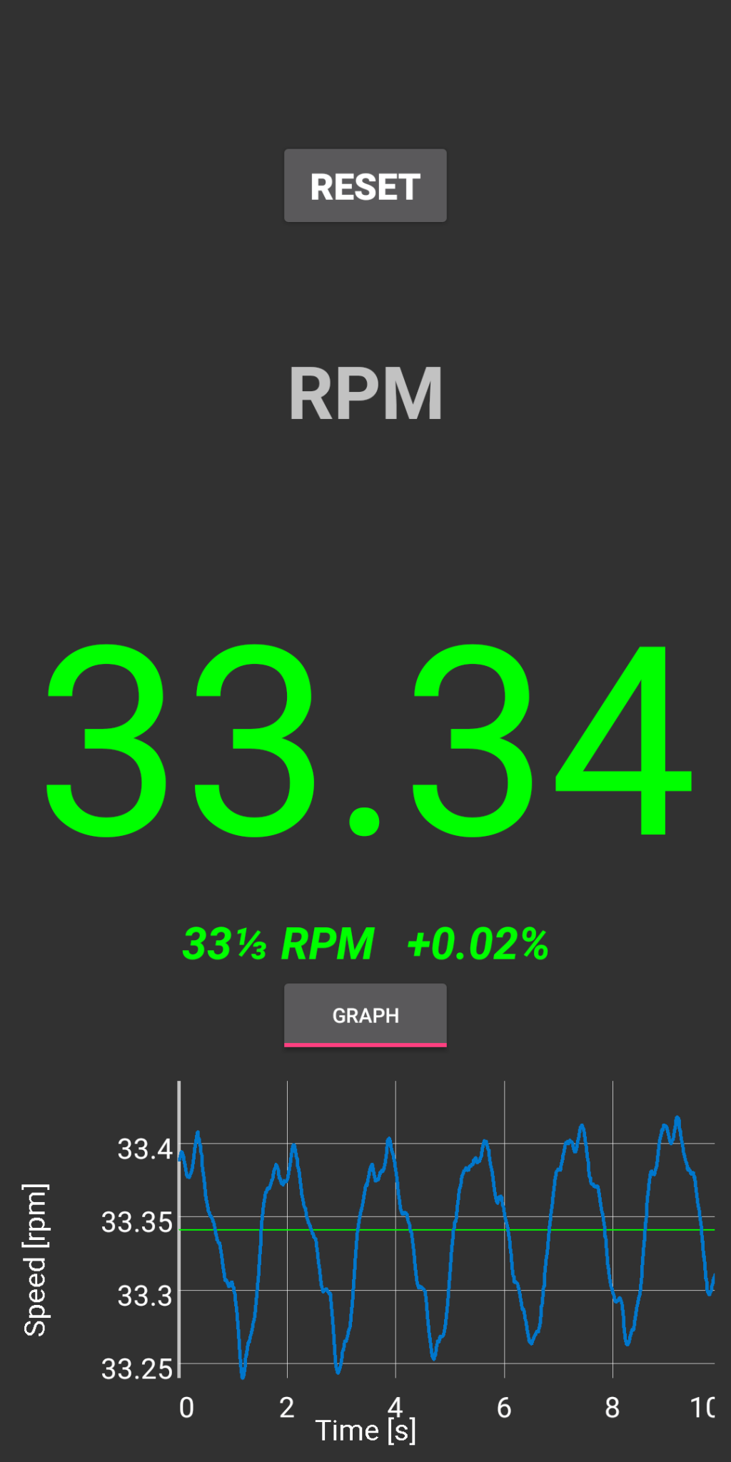

So since I knew I could still improve what I have. I tried adding a single layer of tape on the drive pully, but this increased the speed way too much. So instead i painted it with a clear laquer based varnish. Each coat gave me about 0.05~0.1 more rpms. So i just needed to give it about 5 or 6 coats. And for the last step, i sanded it back down smooth to dial it in... Time will tell how long it will last, but this will work in the short term. A long term solution i think i'll need to keep a look out for a new old stock drive pully.
Lastly, i just wanted to see how accurate my phone measurements were, so i compared it directly to the lossless flac files. I lined up the wave profile in audacity. Over 4 minutes, my recording was only fast by about 0.364s... Or about 0.15%
So i think that result is not too bad considering. Sure, the wow and flutter is still not very good, but i think its good enough. Especially considering i only paid like $70 for this TT for mum about 15 years ago... Cant see how i can do much better than that...
