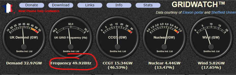

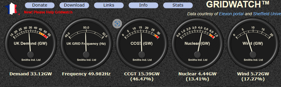

In the UK that is true up to a point, the average over 24 hours is usually very accurate but can vary significantly at times of very high demand.The mains frequency is usually pretty dead nuts on. If it's out significantly the generators at the power stations get really unhappy. I once built a clock where I used the 50 Hz mains as the time base. It lost/gained only a few seconds over the roughly six months between daylight saving time changes.
http://www.mainsfrequency.uk/fm-home
From above:
The GB mains frequency is nominally 50Hz. National Grid is obliged by its licence commitments to control the frequency within ±1% of 50Hz so it can fluctuate between 49.5Hz to 50.5Hz. However the normal operational limits are 49.8Hz to 50.2Hz.
And:
25 countries in Europe share a common transmission network that is synchronised across them all. Insufficient power generation in Kosovo, and Serbia's unwillingness to bolster capacity even thought it is legally obliged to do so, is believed to have led to the shortage of supply and so the average frequency has remained below 50Hz for some time. This has caused certain mains powered domestic clocks to run slowly with a typical error of 6 minutes since mid-January 2018.
This is the frequency right now here:
And a couple of minutes later:

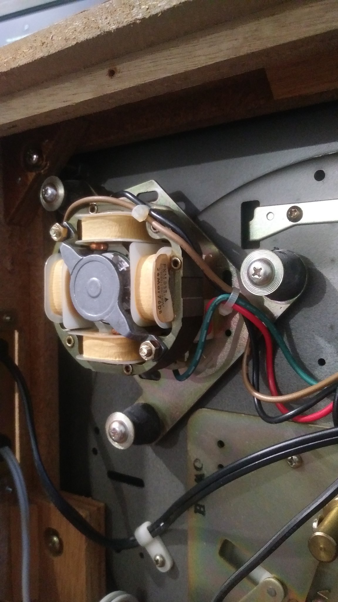

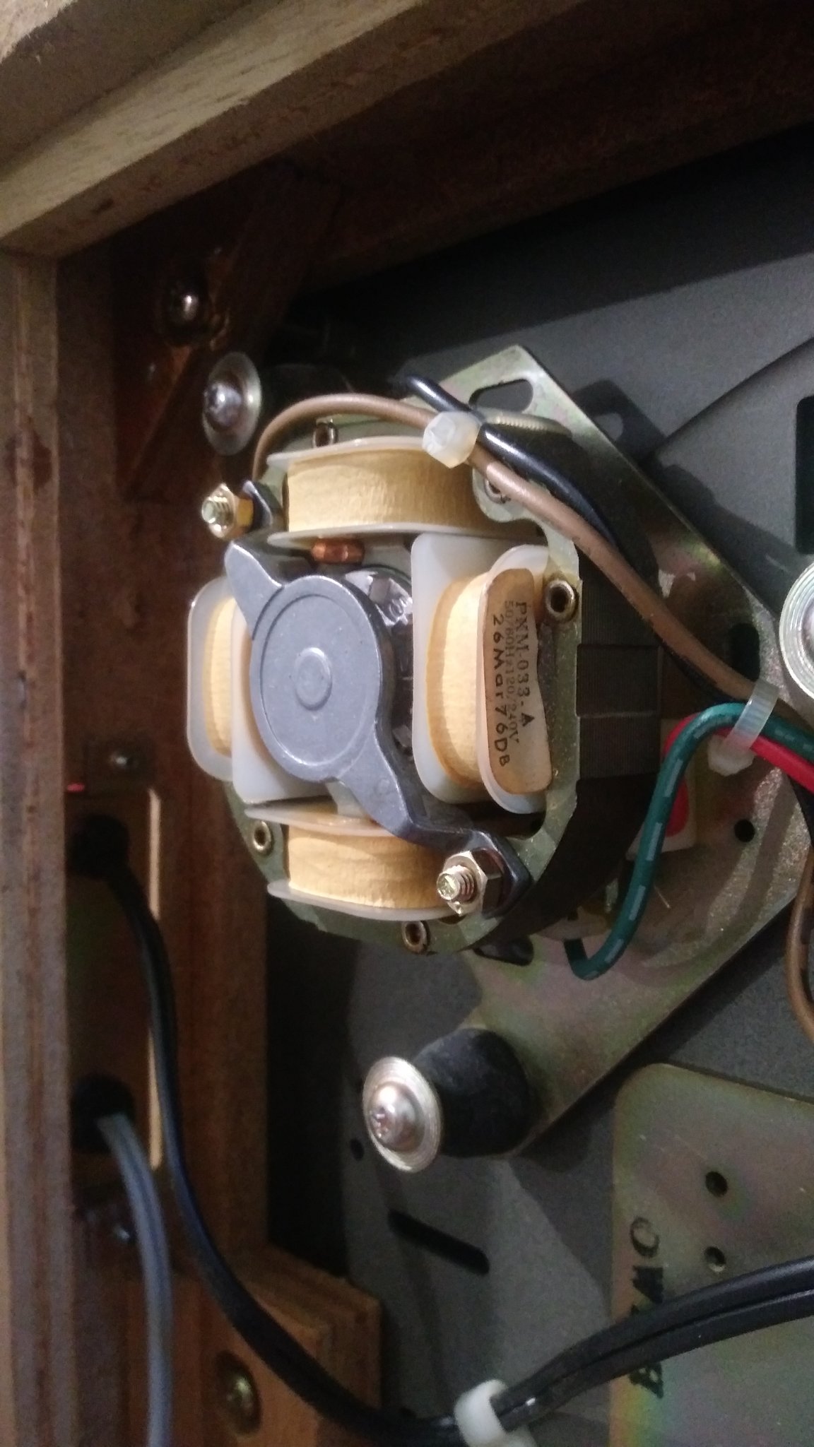

Sorry, i'll have to send photos tomorrow morning in a few hours. But from what i could see, the motor is wired directly to 240v mains. Its a big chunky boi. Outside ferrite lamination plates are like 2~3 inches wide. I couldn't see anything adjustable on first inspection.
I measured the mains freq with my multimeter. I think it was 49.9x or something. I thought close enough as its less than 50Hz anyway.

Yeah... And for a synchronous motor running at 3600 RPM with a 108:1 reduction gear for that magic 33-1/3 RPM the variation from 49.5 Hz to 50.5 Hz would result in a deviation of 33-0/3 to 33-2/3 RPM. A 1 kHz tone would vary by ±10 Hz. Is that audible? Probably if you switch fast enough between the two but for a slow variation or instantaneous "is this in tune?" test I doubt anyone would notice. Then again, I have not consulted science on this. Maybe humans have better pitch detection than I give us credit for.
For the 49.920 -> 49.982 Hz you show above I highly doubt anyone would notice a difference in pitch. Not thereby said that you could not measure a difference.
Tom
Tom

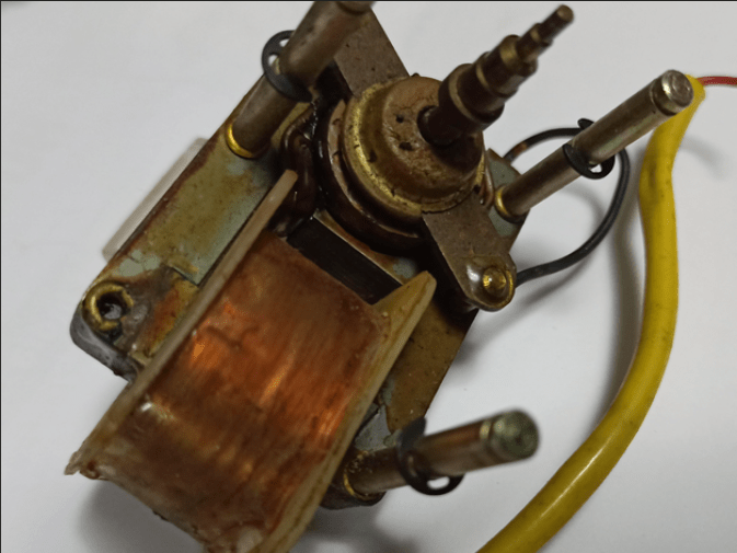

That's going to be a traditional non adjustable mains synchronous motor a bit like this one. I came across an online comment somewhere suggesting your TT could be similar to a Pioneer PL12D Speed accuracy is quoted as 1% or better. There is a manual for the Pioneer on Vinyl Engine.

Yeah mines a little bit different. The motor design is quite a bit different too (looked like it had 4x coils or something)your TT could be similar to a Pioneer PL12D Speed accuracy is quoted as 1% or better. There is a manual for the Pioneer on Vinyl Engine.
