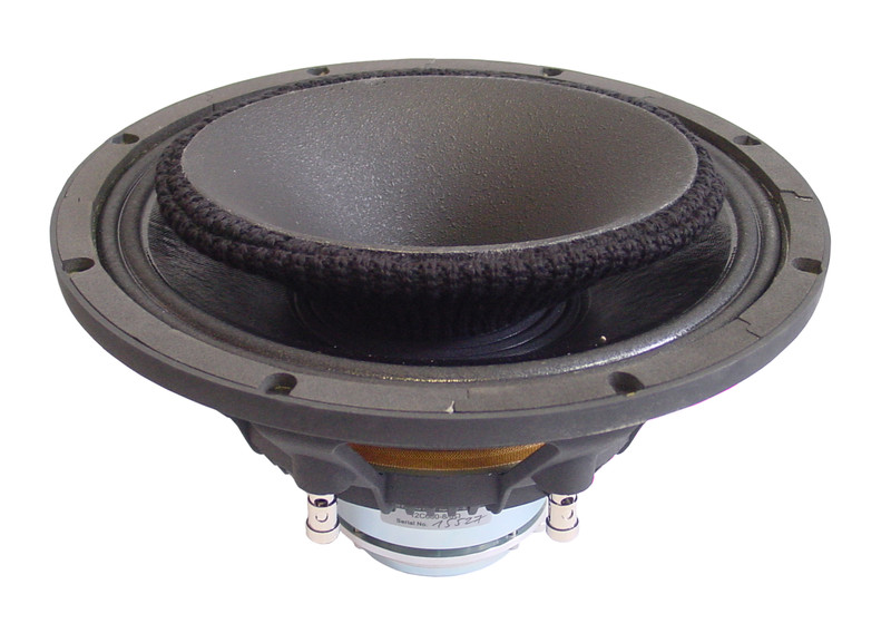

Regarding the Monacor, I'll bet one Euro, that the dip centered around 6kHz will be less, if some foam or low density paper was glued around the horn mouth.
Possibly. The 312CX has a slightly wider null than the 310 (more of a double, actually). It's not massively audible in either though to be honest, so while it's not perfect, or of the quality of, say, the Be dome Satoris, I've never felt the urge to do anything about it with either unit.
You mean, like the BMS 12CN680? 🙂Regarding the Monacor, I'll bet one Euro, that the dip centered around 6kHz will be less, if some foam or low density paper was glued around the horn mouth.
With the Monacor 312CX, the 6k dip isn't visible under angles, so I also don't think it is a concern.

No, 312CX has no horn attachment like the BMS, one would have to cut away the dust cap to really know what is going on. Some reflexion/diffraction it surely is. As Scottmoose says, it is not that critical, I have not quite so wide dip at 7kHz due to mismatched throat. I will try to fix it but it sound quite ok as is...
I say long live the undersized paper cone, 0.7g 😉
Sure, and that's why I was looking at units like from BMS or Sica, with smooth horns where you can see what's going on.No, 312CX has no horn attachment like the BMS, one would have to cut away the dust cap to really know what is going on. Some reflexion/diffraction it surely is.

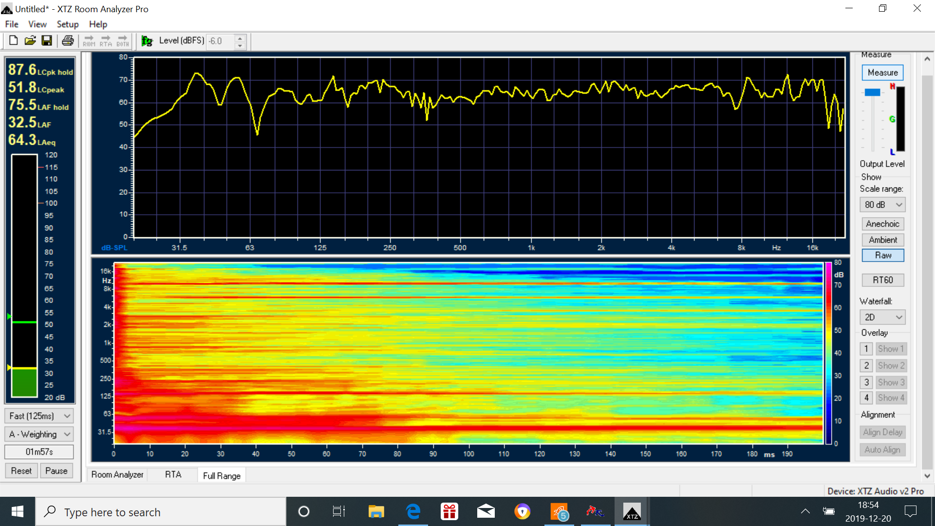

No, a Visaton 5FRX S on a 2380A copy. First try of x-over around 400Hz looked like this.
Since then phase is improved with notch of 25db when in reversed polarity

Zoom in on the voice coil on that Omnes driver and you see the step from cone to voice coil. Even it out with a ring of paper/foam and let it expand some 2 centimeters outwards, it would probably reduce the notch.
