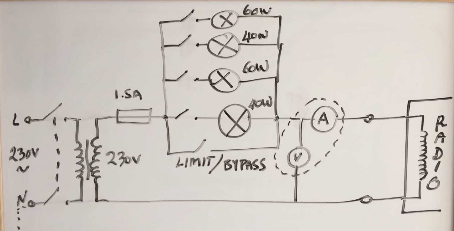

Trying to build a lamp bulb tester but been around every store possible in Helsinki area (and north of Helsinki) and don’t find anything else than LED lamps
Is it possible to buy a flood light (that usually see in construction) with either 80, 250 or 500w tubes? Those are incadecent bulbs i think right ?
Is it possible to get higher wattage bulb by serie connect say 2x80w to 160w?

I use something similar to this one:
I know there have been lots of bans of incandescent lamps in recent times, but not sure what your local regulations are.

100W should be enough?

It's Greek to me, but looks like a 100 Watt filament incandescent for a dollar.
What wattage would be good if im working on everything from 25w amps up to 500w amps?
What result do i see if i have wrong lamp? I got hold of one 100w now. But would like to get a small stock of different ones

One of these days cleaning my garage & workshop I've tossed many incandescent lamps which were replaced some time ago by led ones, but kept two 100W for repair purposes.
I did not try halogen tube lamps for DBT, but it should work. The point is limiting current and those indeed have a filaments with resistance.
I now got a bunch of bulbs. 60 and 100w. Is it possible to connect them in series? Say 100+100w and get a 200w lbt?
