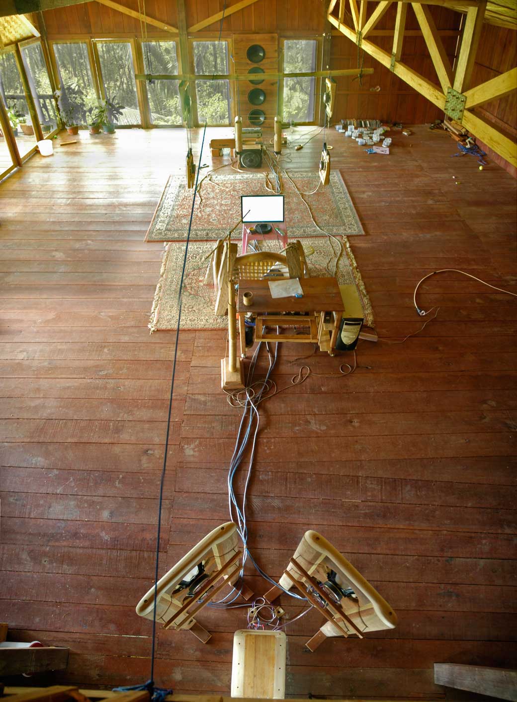

Here a system "on line", stretched on 12 meters. There is no lateral radiator.
The listener is clamped in the middle (but founds this natural), the back speakers are reversed and in phase opp. For my taste, it gives a good illusion of the event.

Nice space! But judging from the walls, it must be warm all year round there??
Perhaps I need to come and visit for a good long while?
What are your subjective impressions compared to the same system set up as well as you can for stereo? I would think that with that size space the speakers could be spread quite a distance apart and toed in at ~45degrees, aimed in front of the center listening position for best image. Have you done that or tried it??
That space is very nearly what is needed... even if the room is live, the dimensions are such that the reflections do not interfere with the main sound... otoh you need to run higher average levels than in a smaller room...
_-_-bear
You got the point, Bear, it's an almost equatorial zone. Search for Tana Toraja, it's quite a touristic place. This ambient authorizes the use of flexible boundaries (walls, ceilings, floors, all...) and then a native dampening of the low frequencies. And of course all the rest of the spectrum is very well reflected, the room being empty on purpose.
Following the distance listener/speakers, the first side wall reflections arrive between 15 to 19 ms after the direct sound, and as you said, I listen at higher levels than the average people having neighbors.
I tried almost everything that I could imagine before using a centered distribution of the tweeters (OSD...), and I can guarantee that with the same level of competency (or incompetency as well) , never a two speakers configuration can give this feeling of reality. Of course, I agree that the actual configuration is not a silver bullet. It's just my experience.
With the rear group, it becomes more complex to set up but on some records, the envelopment is really 360°. I search to emulate a flawless cross talk cancellation without processor, managing either spaciousness and accurate imaging. But everytime I compare with a simple plug in like ambio.one, this last is still ahead.
It's a long way...
