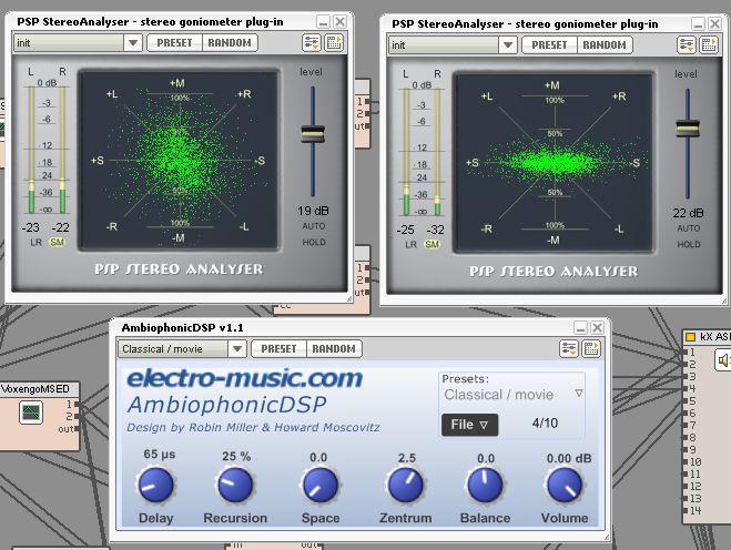

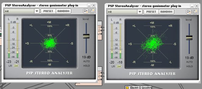

Hmm, I experience the opposite. When using ambiophonics (sorry for my typing dyslexia earlier) with headphones I experience a stuck between the ears feeling (no depth) but almost binaural because of extreme width. I was trying to listen to unprocessed binaural recordings to compare, but they do not show up like the following and sound proper on headphones of course.
Here is Lil David unprocessed (left) and then processed (right) shown on a Goniometer. You can see how it compresses everything to left and right only. Second picture is before and after using a headphone crossfeed plugin. Not much difference, but it sounds fuller in the lower frequencies because that is what most crossfeed's do, fix the response created by the mismatch azimuth angle.

What you see on an oscilloscope or a meter is the average of the direct unaltered stereo signal plus a long train of early reflections which are the crosstalk cancellation vectors. Naturally the signal goinng to any speaker is a mixture of the left and right channels but because of the delays and polarity reversals this is not what you hear. The only way to see what you really get acoustically is if you measure the signal at the listening position using a microphone at a one ear location. Then you will just see a pure left channel and a pure right channel if everything is adjusted normally. Incidentally this sort of mixing means that if you are off center you can always hear both channels in Ambio, unlike stereo where you normally just hear one speaker.
The Electro VST plug-in, has some adjustments that are not strictly according to the RACE theory and they do manipulate the sum and difference signals in ways that may not be always desirable. These controls can make the center or sides more or less prominent, are easily abused, and I don't really know what some of them do myself.
