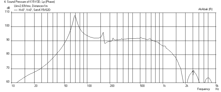

hey X - can akabak tell how the following coupler shape performs? - this is the "Dutch" K12 type with 3 rather large distributed slot vents - I think it would still tune around the same area as JEK's K12 There's no upper reflector board. There's two rear shelf boards like those of Karlson's July 1958 Popular Mechanics article.
Freddi,
From the drawing, I can't tell what the dimensions of the rear shelves are. It looks like the rear shelf port connecting the top and bottom rear chambers is blocked by a solid board.
X
X
its made in the rear just like the 1956 K12 which appeared as a construction article in 1958 - - each shelf board is 100mm wide and 150mm deep Here's the Dutch K12 article https://docs.google.com/file/d/0B1shOod … MzbEk/edit

Freddi,
Just looking at the shape of the Dutch k12 I don't think it will be remarkably different than a standard k12 as the dominant factor in the sound is the volume of the chambers, the shelf csa, the vent, and the K coupler aperture. The shape of the front chamber will not be a big change, the distributed slot vents have more impact and I have modeled that effect before somewhere in either the Karlson thread or the Kicks Butt thread.

re: venting, what are the causes of dips in the X15? - is if from too small a vent? - could the
cupped nature of its front cavity exacerbate things?
Beyma 12cx – outdoors – ground plane
X15 loaded with a familiar set of Beta 12cx indoors in a small room vs two K12s - I did not offset any trace
so you can see Beta12cx was somewhat lower in output - subjectively it played a big odaiko at startling dynamics
without a lot of cone movement.
look at the similar sized Acoustic Control 115BK – even with its vent blocked,
there's less first dip
