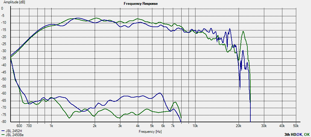

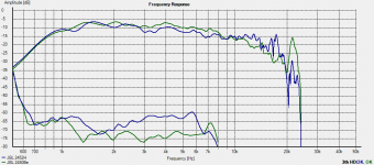

Another measurement for those interested, comparing a 2452H (ribbed titane) and a 2450SL+Truextent, both on the same PT-F95HF waveguide.
3rd distortion is plotted, and is lower that the titanium diaphragm as you can see.
A small distortion peak can be seen just above 7kHz. As it is 3rd distortion it does happen just above 21kHz, which corresponds to the big response peak (breakup mode). That 21kHz breakup also clutters the impulse response (ringing), but is of course rather benign at this high a frequency. EQ would get rid of the response peak, but not of the 3rd distortion peak (but who can hear that sort of thing anyway). Reticulated foam on the other hand would probably take care of both, so it would be interesting to try...

I am surprised that breakup seems to occur at the same frequency for the Ti and the Be. Very different stiffness to mass ratio so this seems unlikely. Could this be a measurement anomaly? due to a resonance in the microphone perhaps. Or a real anomaly but due to a resonance elsewhere in the driver, maybe a cavity mode?
The lower distortion is also a bit of a surprise. I expected similar pistonic response in the lower frequencies. Perhaps the polymer suspension really is as superior as TrueExtent claims. Very nice for you anyway.
Not sure what you are referring to here.
The Ti ribbed diaphragm has two main breakup modes that show on the frequency response and CSD around 12khz and around 17khz.
The Truextent has its main breakup at 21khz.
At it is 3rd harmonic distortion it happens at 3 times the frequency it is reported at, so it looks like it is due to breakups (more spread with the Ti diaphragm, both because of the ribs and the diamond surround I think).
There is also a substantial spike in the Ti. curve at the same frequency and the associated spikes in the 3rd harmonic distortion at 7 kHz. Seems a bit of a coincidence. You mention a CSD so perhaps it is clearer on that.
Yes of course, but there is a substantial difference even below 4Khz where neither the Ti or Be have breakup modes below 12 Khz.

In case of compression driver it is very difficult to know what is diaphragm breakup and what is cancelation of HF from phase plug /from measurement/. The cancelation is different for different phragm because of different breakup.
Yes I think it is a coincidence, and the peaks are not exactly at the same frequency.
On the CSD you clearly see two ringing traces at 12 and 17khz for the Ti ribbed idaphragm.
They both have breakups bellow those that we clearly see on the frequency reponse.
This is particularly true for the Ti ribbed diaphgram: the entier >5khz range is cluttered with small partially controlled breakups, due to both the ribs (that give a boost in this range compared to a normal Ti diaphragm) and the diamond surrounds (that allow some extention in the UHF). It seems to show in the distortion measurement also...
In comparison the Truextent Be is much smoother in this range, and does not attempt to control the dome breakups that occure above 15khz. And neother does it rely on parasitic resonances of the surrounds to extend its reponse up high. And it shows, as it drops quite a bit in the UHF (despite the higher mass breakpoint), but nothing that a good EQ cannot compensate...
It is similar to the TAD TD4001 vs TD4003 comparison.
