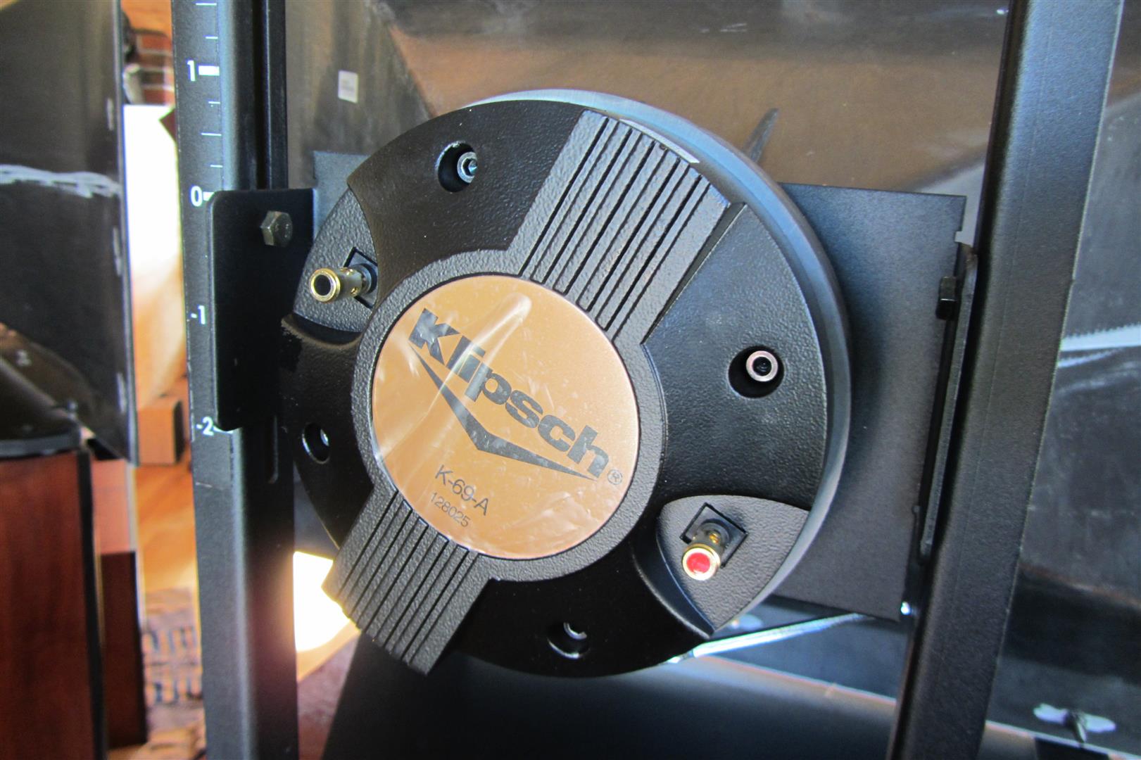

I replaced the driver in Klipsch K-402 horn with JBL 2446 with Truextent Be.
I don't know what the original driver in K-402 is. Does anybody know? Klipsch call it K-69.

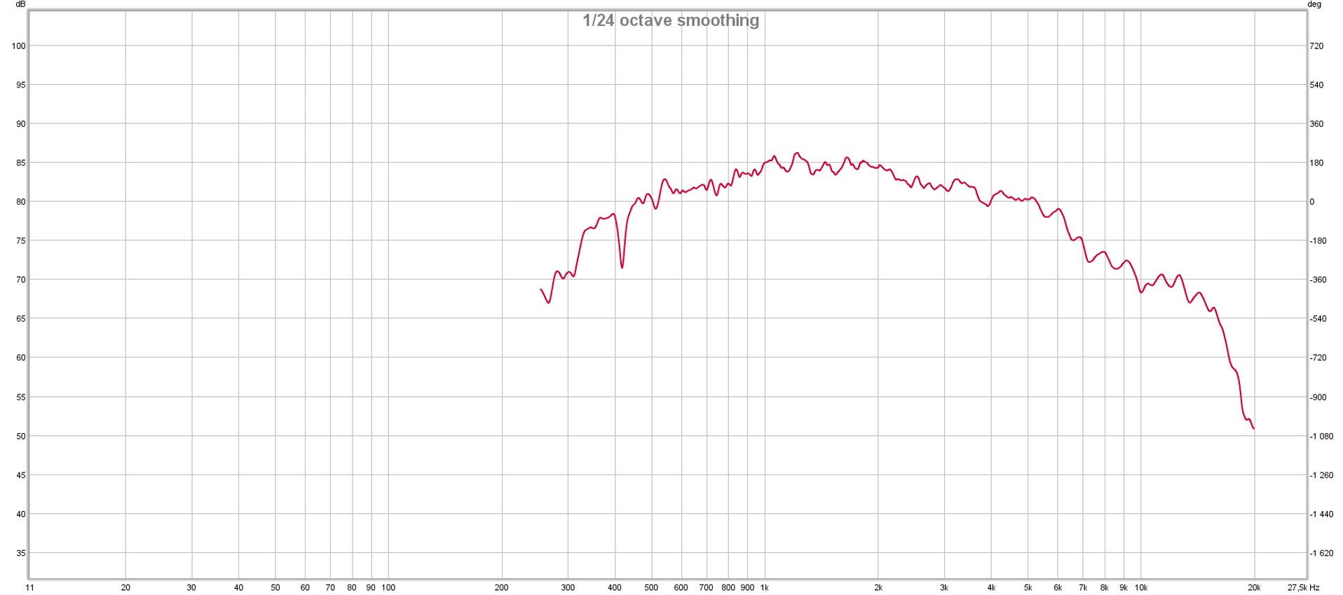

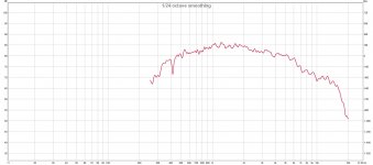

Measurement with the K-69 driver without EQ:

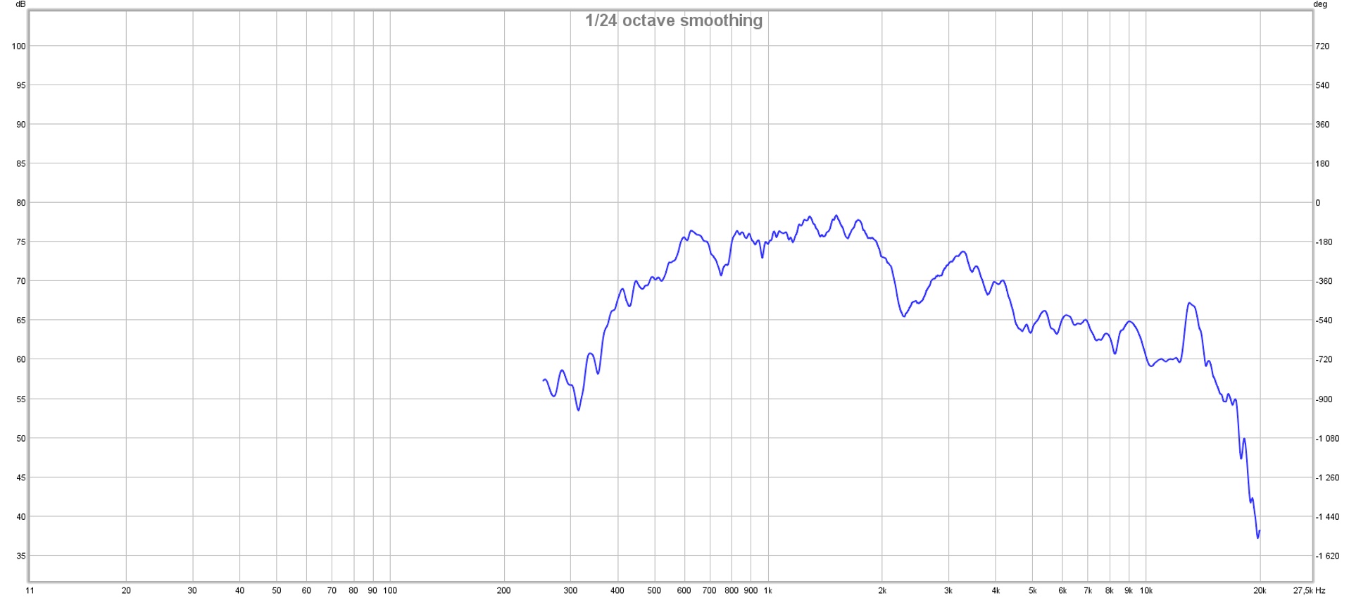

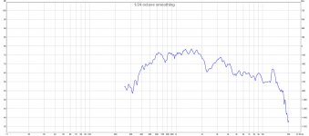

Measurement with JBL 2446 with Truextent Be without EQ (higher level):
attachment.php
I wasn't able to do a proper AB test but I felt the 2246 Be sounded smoother and less fatiguing for longer listening periods. Not a huge difference though when EQ is applied.

Good to se these graphs.
The EQ can clean up the treble, but it can also lose some subtle treble information, whether DSP or passive. The differences w/o EQ II see around 16KHz would possibly be somewhat significant to me on a transparent system on quality music with treble emphasis. But the notch around 2KHz is telling us something plus the rougher FR in general
