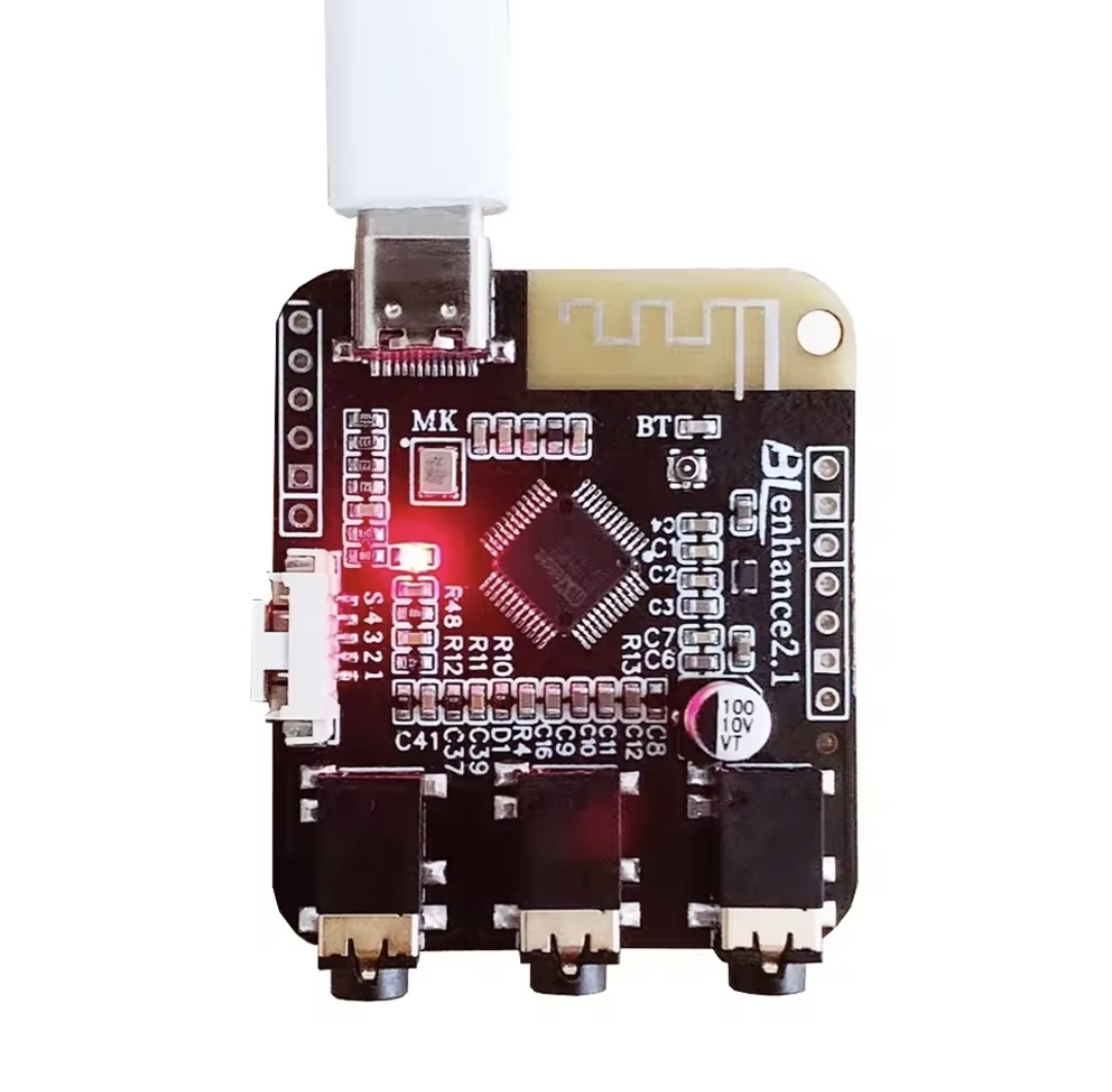

Hi, has someone figured out how to pair in TWS mode this one? I just can't figure it out.
According to some similar images, the TWS option is called by long pressing the start button, but every time I do that the board just turns off and I have to do a power cycle (I have two boards, and they do the same).
The rest of the board works fine, I can switch between Bluetooth and Line In, I can turn the volume up and down, I can apply EQ to the sub output and a different EQ to the Line Out, just missing the TWS function.

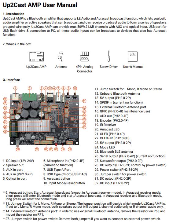

After some research, I understood Auracast to be used to distribute content to several Bluetooth receivers (a kind of local broadcasting).
I couldn't find anything about the fact that, like TWS, it also enables stereo configuration of two receivers.
Have I missed something? 🤔
No your right, I`m sure Auracast can be configured as a transmitter of only left or right but its easier to look at it as a FM transmitter (stereo) and at the receiver side you make the decision to pass the left or right channel to the dsp/amp.
Or in a 2.1 system you could have one as left, one as right, and one as mono (sub).
The Up2cast can not be used as a two way powered amp + a subwoofer out as the third line out channel with its own dsp setting according to the support.
I asked:
Hi! I just found your up2cast amp.
And I have a few questions.
Could I make a three way speaker with the sub out on a separate amp and add crossover and eq to all channels?
Can this three way then be selected as left signal only, right signal only, and mono only? In a Auracast cluster that is.
Answer:
You can switch between left and right channels and Mono channels by jumping the needle, but if you connect a subwoofer, you can't control and divide the frequency together.
