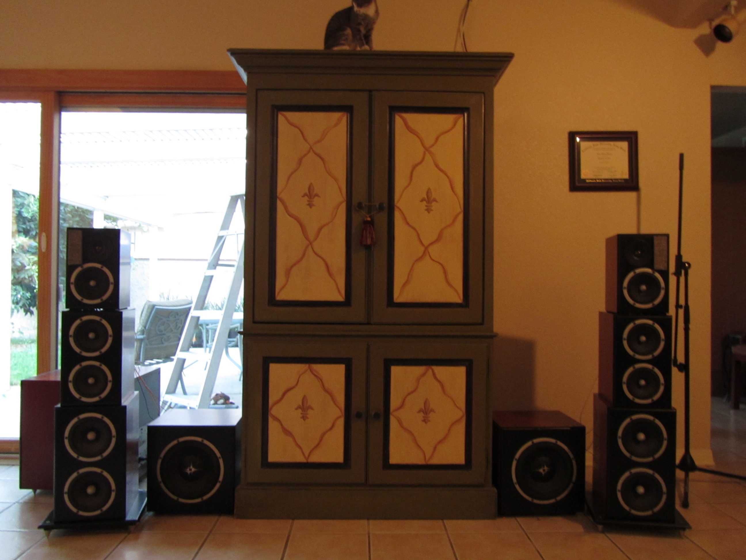

These definitely aren't KEF's. I have no affiliation whatsoever. All Peerless HDS exclusive, xxls based system. The tweeters are crossed over at 1.4 khz, 4th order. What do you have?

Don't have access to pics right now. The crossover is about 1.3 kHz. Acoustical target LR4. But the electrical slopes are asymmetrical to get the correct rolloff and phase overlap. The Deltalite is really a great driver, but 1.3 kHz is stretching it. A 12" driver is a better match for the SEOS-12. But I'm getting a SEOS-18 from the next group buy, and that should allow a lower crossover with the 2515.
I see you have a lot of cone area, which is always good. Should be a smooth, dynamic system.

Crossover points are 50, 100, 200, 450 and 1.4k. The idea behind the driver count is to have total flexibility when it comes to flattening the in room frequency response without putting too much strain on any one woofer. Distortion is obviously very low also. I managed to get a hold of some rare 4" hds exclusive mids.
http://pas-bg.com/Peerless/Peerless Data Sheet - ID 830881.htm
The 5.25" midbass' in the top units will be replaced with these for obvious reasons. The distortion above 400hz with these 4" units is also pretty amazing.

I'm also going to use them between 600 and 2khz. Their efficiency sucks, but I'm all active so it doesn't really matter.
