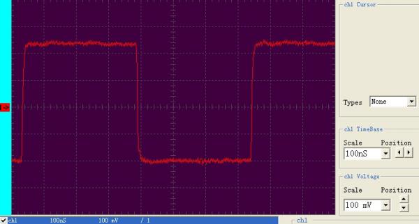

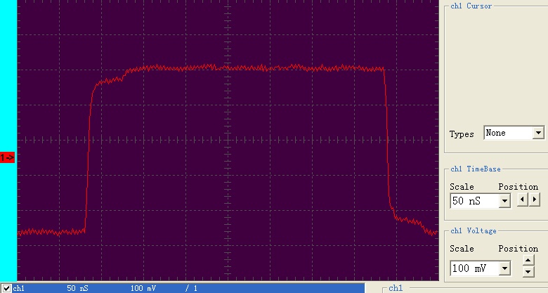

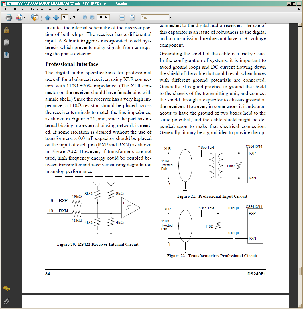

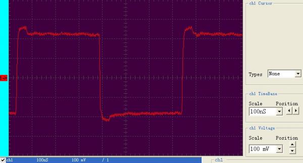

If you are using CS8416, please beware of Schmitt triggers on input. They will screw your input signal. Use driver circuit between your input and input of CS8416
Example with Schmitt triggers OFF
...and with Schmitt triggers ON
For Jundac DAC, change those 50R BNC's for 75R BNC's.
Interesting graph, where was it taken?
And will a decent receiver chip really have trouble with that little leading bump? It's pretty small.
I don't see it, the eye pattern will clearly be just fine in both cases and the edges are still plenty fast.
Schmitt is a red herring as far as the edges are concerned (which is what matters for clock recovery in most schemes), so I am far from convinced that it should be making any real difference.
it won't have any trouble, it will decently translate into jitter
best
it is not bump, but rest of the signal that gets attenuated after 40nS because od Schmitt trigers.
40 nS means approx. 4 meters of digital cable. With shorter cable situation will be worse.
OK, can you explain how this translates into jitter? Like Dan, I am under the impression that it's the edge, rising or falling, the makes the difference.

1) the bump affects the timing of the slope
2) the slope is input for the clock recovery circuit
3) the recovered clock is used for DA conversion
cheers
If your analysis is correct,then the triggering is extremely slow, even for CMOS.
Plus, Schmitt Triggers (inside the IC's I know) involve positive feedback, so how can positive feedback lead to attenuation?
While I agree that attaching Schmitt Triggers to a SPDIF input is a bad idea, but I suspect not for the reasons you mention.
