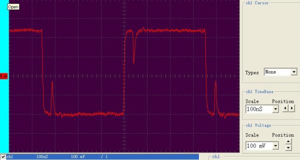

Yes, it is very robust and you can use almost any wire you want, even speaker wire But please be prepare to take the consequences, your signal will look something like that or even worse

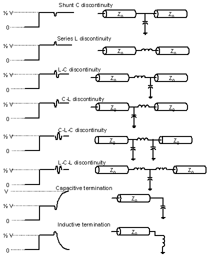

S/PDIF is not audio signal, it is RF transmitter. Coaxial cables are not just audio interconnects, they are Transmission lines with Characteristic impedance .
If anything in not OK (wrong cable, wrong connector,..) reflections will occur. You will not have multiple signals, but you will see spikes up or down on original signal. Or you will limit bandwith.
For the non-believers: just take the test and put a BNC T-connector on your S/PDIF and introduce an increasingly capacitive or inductive load on the receiving side, deliberately destroying the matching impedance and listen.
Did some SWR measurements on S/PDIF transmitters and receivers. It's enjoyable. Increasing the return loss to 25-30dB by proper matching made quite a difference.
And oh, short runs are even more sensitive than longer runs as a lot of attenuation will make the transmitting side happier. Now, go figure how to make insentive S/PDIF's
