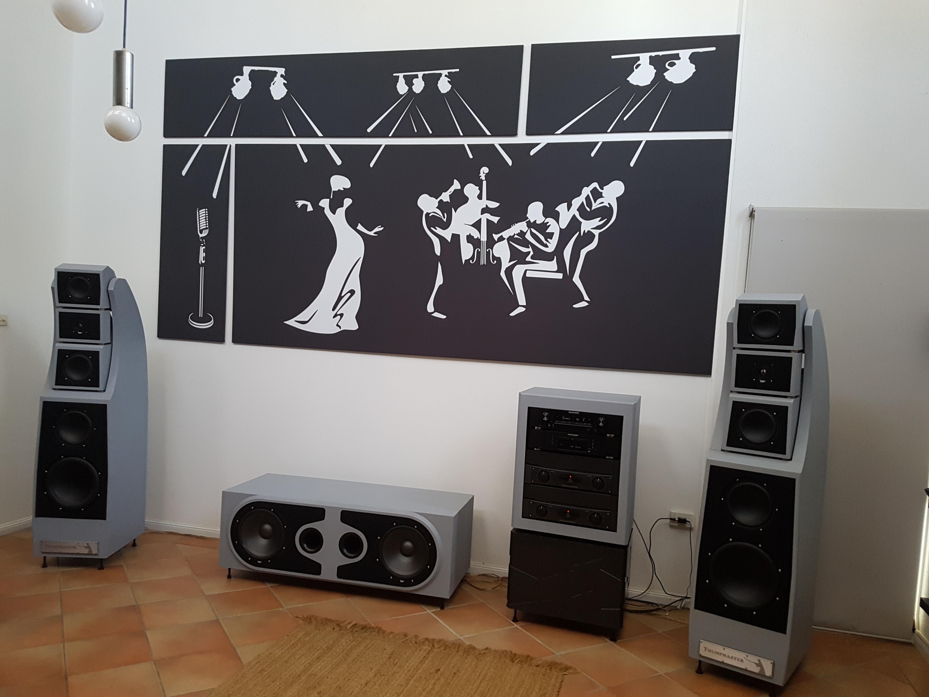

I had a similar problem, so I made these, there is a similar but different large artwork on the opposing wall, Heavy canvas on timber or aluminum frames, I was going to put accoustic panel behind the canvas, but they solved the problem as they are..
