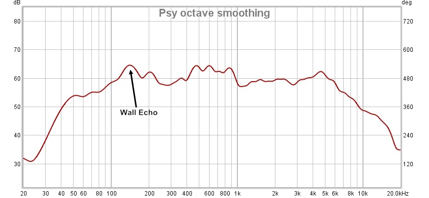

Troublesome wall echo

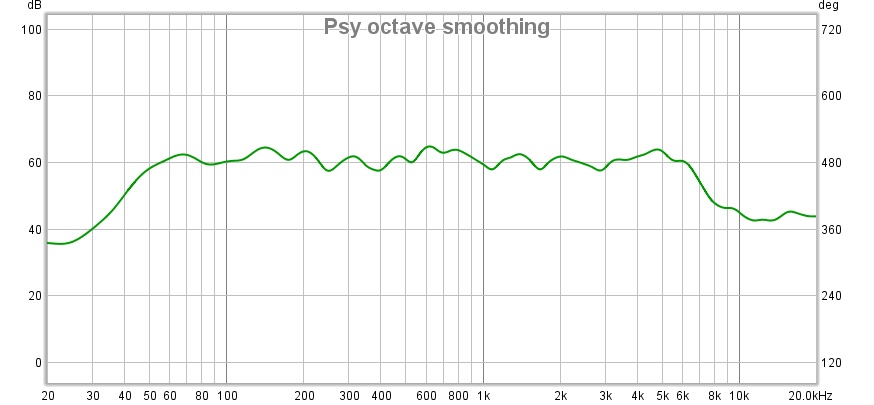

Douglas, here's the one on the opposing wall, that wall is rendered block and was a bit of a problem , the problem still exists but is dramatically reduced..
Nice!
Reduced, I would guess by the surface area covered with canvas.
You will always have some echo between parallel walls, it's basic physics. The goal is to get it down to bearable limits.
To give you a hint how bad that wall at my friend's place was... they would be over by the balcony door (far corner of the room) talking and someone in the living room would look at the kitchen wall thinking they were over there. Yikes
