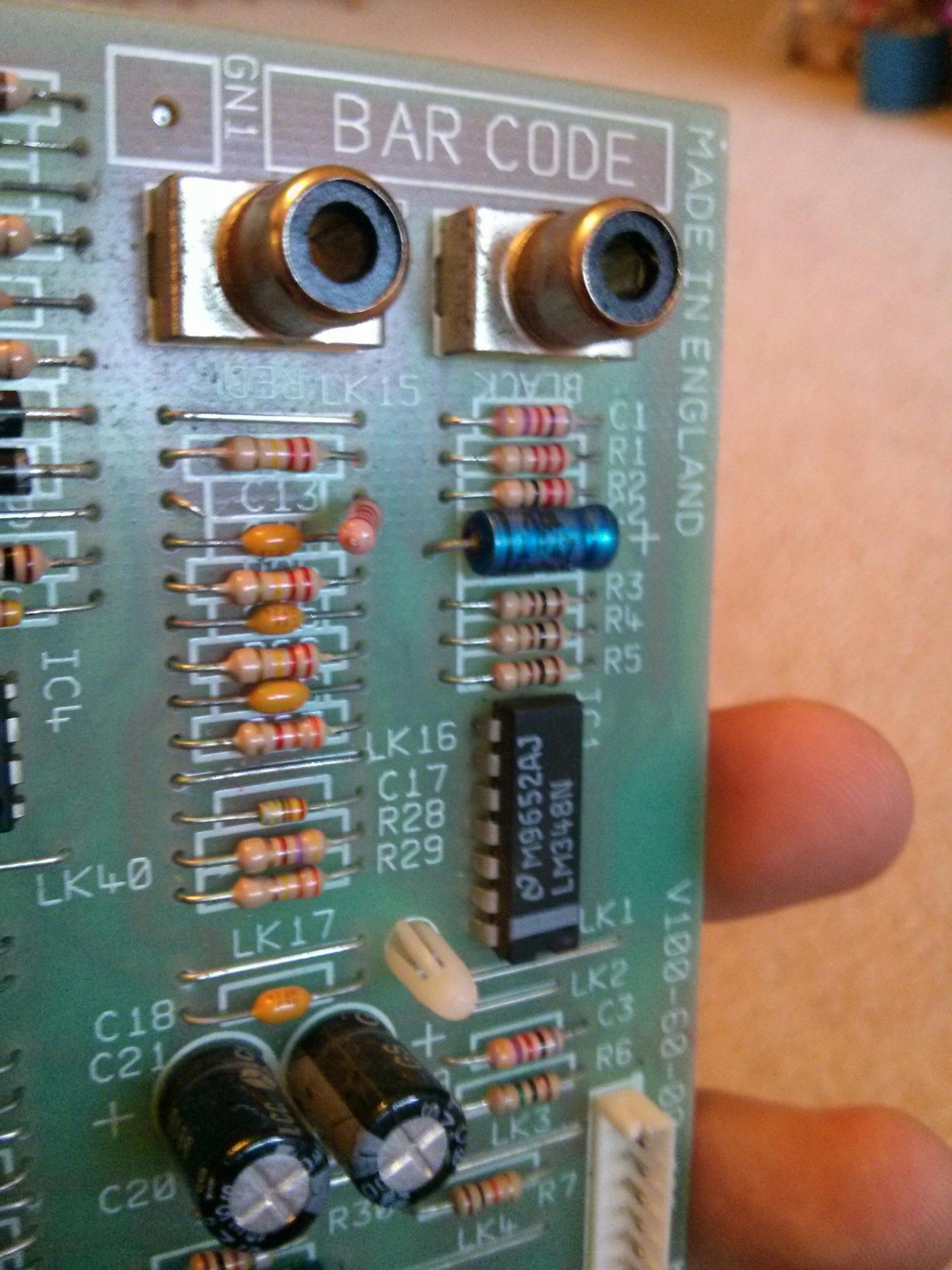

Finally had a chance to put some time into this. Went to desolder C13 and had a fun surprise: C13 had been replaced by a 222 ohm resistor (see attached photo). I guess that's where the 213 ohm resistance between the tip of the red RCA plug and chassis ground came from. I should've seen that earlier. In my defense, some component names are hidden under the components 🙂
Clipped one end of the impostor C13 resistor and checked for reverb. Still have the same issue: no reverb on either channel. No buzz when I touch the tip of the red RCA I do hear crackling when I rotate the clean reverb control knob.
I also looked around the circuit a little more and noticed a few more instances of replaced components (see C42-45 of attached photo).
But as Enzo said, there must be another issue, correct? Otherwise the reverb should have returned when I clipped C13.

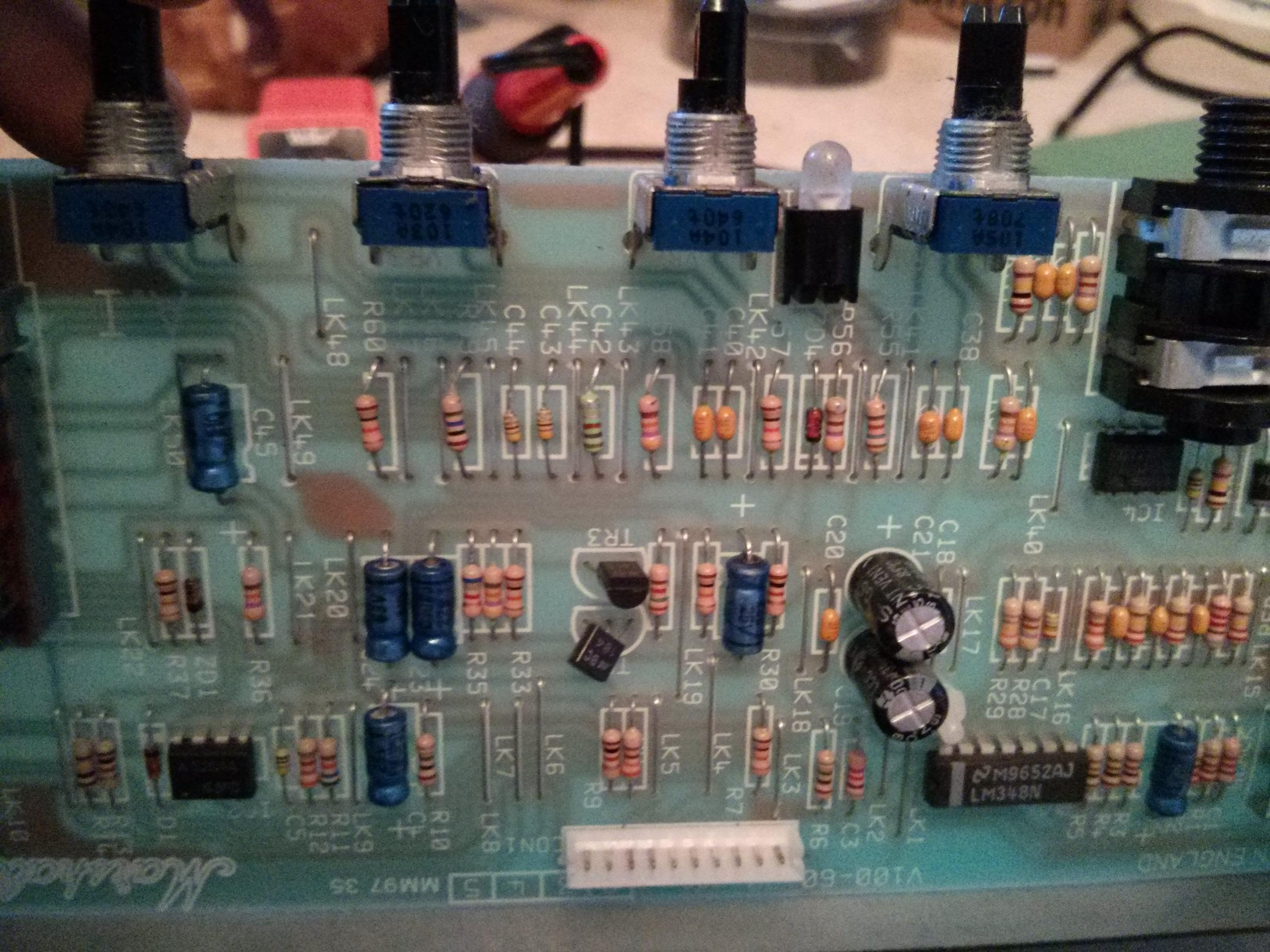

Post 57, 58 - Test of rca cable.
Let's go back a few steps due to the new findings with "C13".
Check if the red rca cable is fine. Measure continuety between the tip and the wire end at the pcb side.
Recheck the junctions of C14/C15/R25.
Touch with a screwdriver if you have a buzz at:
pin 12 - IC1
The junction mentioned above
The connector PH2.
Of course, you have to mount the pcb back in to the chassis and power it up.
No need to fix all the potentiometer nuts or these from the jacks. Just a few so the pcb will not "fall" in to the chassis.
There are these 3 or 4 plastic pcb holders; click them into the pcb.
Reconnect the ac wires if you disconnected them.
Come back with the results.
I know it's a lot of work; but that's the only way to find out what can be wrong.

"C13" is out of the way, whatever it was it is not needed for the circuit to function.
Isolate the problem. When you touch that tip, is ther signal at pin 14 of IC1d? If feeds pin 6 of the ribbon to the main board. It might clear the op amp, but not make it through the ribbon. Over on the main board, you report turning the controls makes noise, so IC2 ther probably works. Touch pins 2 or 7 with something metal and see if noise results.
