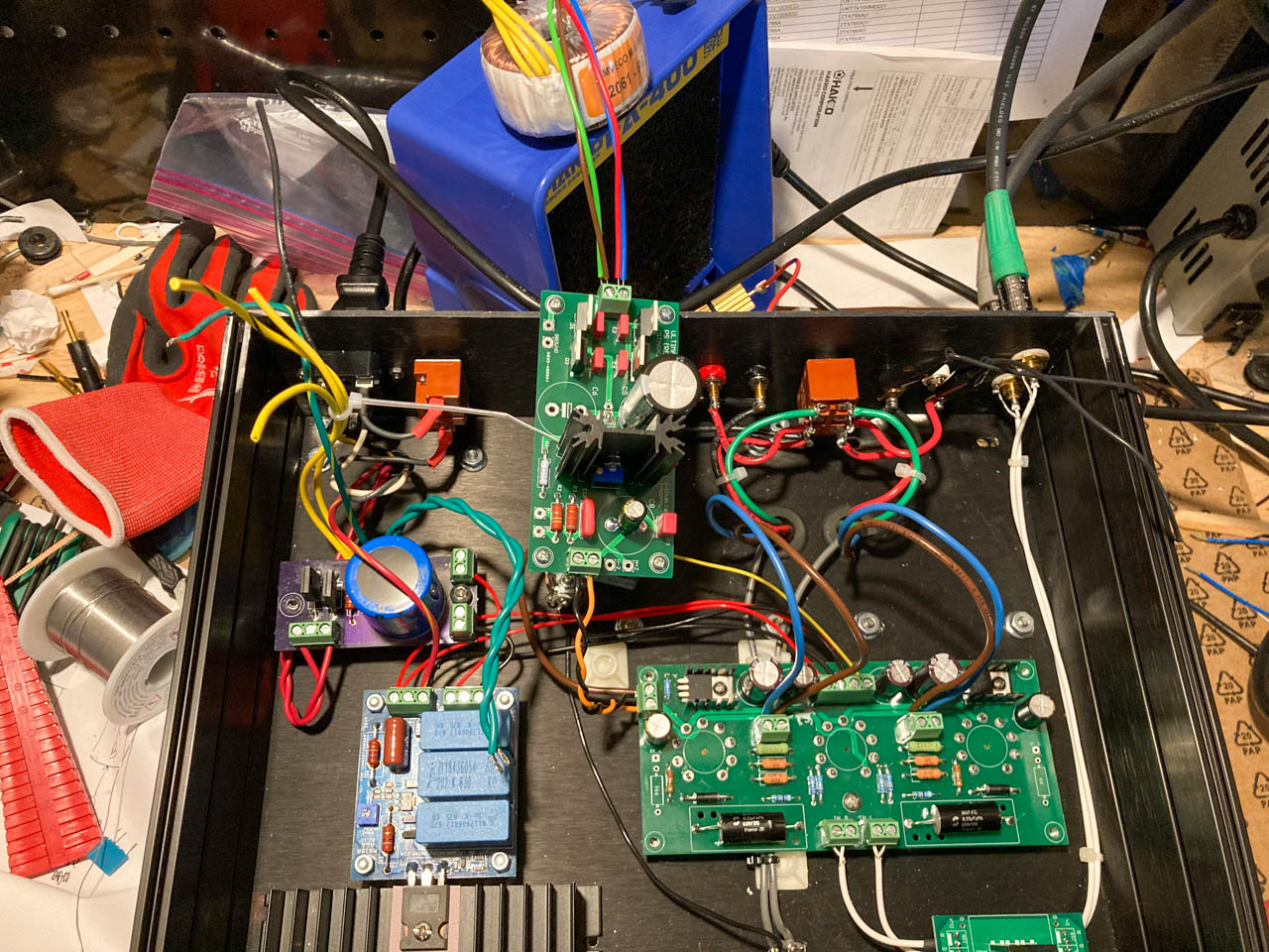

Okay some better progress here.
- AC heaters from separate toroidal transformer -- no spikes but still some background noise. Again, this is likely a non-issue with speakers, but with headphones noticeable
- DC heaters from separate toroidal -- reg outputs 6.3VDC, dead quiet background.... issue resolved from my perspective.
- DC heaters from 6.3VAC tap -- same quiet background :up:. Issue though is that I'm only getting 5.8VDC from the reg. The 6.3 winding is rated at 6A (PT is Hammond 270HX) so I don't think that is the issue.
The diodes there are ISL9R860P2 so I think they may have too high of a forward voltage drop.

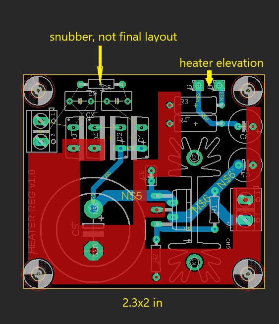

I have a draft PCB for DC heaters with the same MIC29502WT LDO.
This board is more compact, uses a large snap-in cap and will incorporate quasimodo based CRC snubber instead of the cap per diode. I think I'll finalize this PCB and this will be the long-term solution.

Yes I'd certainly have enough DC for only the driver, but that would require butchering the PCB and I don't want to do that as of yet.
That said, there should be enough for the whole amp.
Each EL84 is 750mA, and the 12AT7 is 300mA. Total of 1.8A AC
Rectified to DC requires 3.6A.
The PT is rated at 6A so I think that should be more than enough headroom.
The MIC29502WT has a dropout voltage of 350mV at 4A, so I would only need 6.65V DC from the 6.3VAC tap, or even 6.3VDC and lower the DC to 6V which is fine too.
I think the issue here specifically is that the diodes I used in the PCB have a rather high forward voltage drop.. should have used Schottkys
