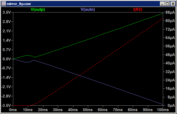

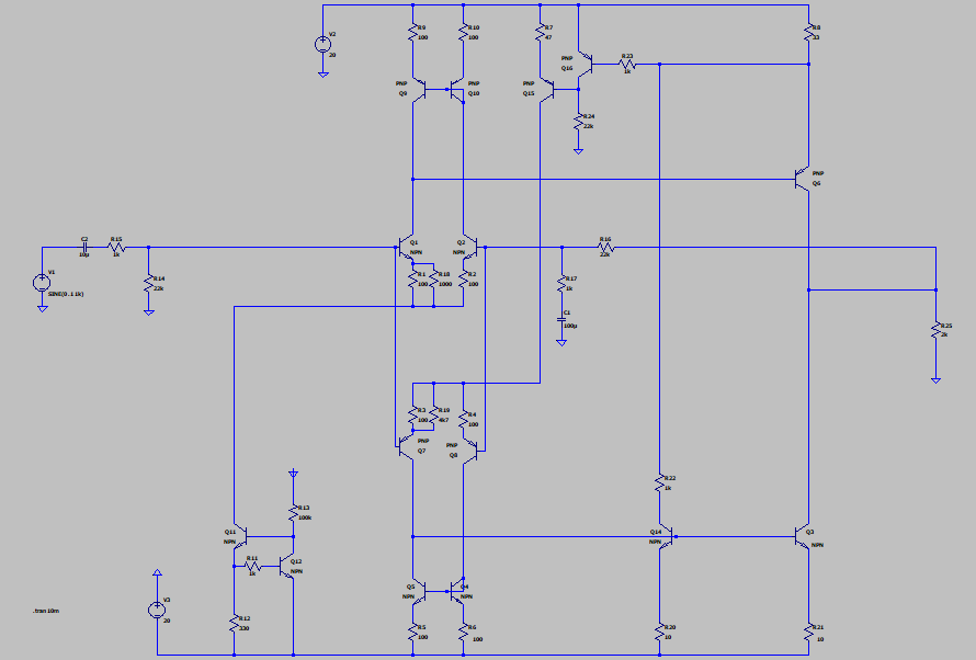

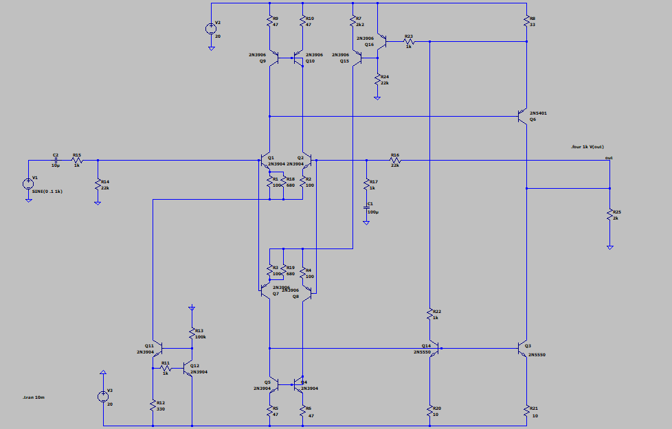

I don't get it. I added a VAS and I cannot get the CM to misbehave. Even when ramping up the PSUs:
attachment.php
Using 2N5401/5551 doesn't make any difference. I fail to see how the LTPs fight each other. What am I overlooking?

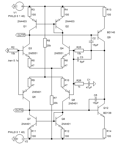

As in previous schematic, you need 47-100K resistors between Q3-Q4 and Q5-Q6 collectors.
My sim doesn't seem to need them. What would be the point? Why does the Real Life LTP refuse to start up properly but the sim works just fine? Or rather, how can I get the sim to misbehave?

Doesnt this just defeat the point of having the current mirrors?
I'd like to know how they wouldn't function as mirrors to begin with. Was 47k added to balance them? Could they be so far out of balance that the VAS has no base current? Wouldn't that initial imbalance put a large DC offset at the output? Wouldn't the LTP then put that back in balance?
Suppose you want a VAS current of 10mA and the VAS transistors have a Beta of 100. That means the Diff-amps have to provide 100uA to the bases from the positive sides of the LTPs. But there is no mechanism that creates that current difference in both LTP at the same time. The NPN LTP needs a slight negative offset and the PNP LTP needs a slight positive offset to provide 100uA outputs to the VASs. Normally the DC offset adjusts until the VAS current matches the current source opposite the VAS. But here the DC offset reduces one VAS current while it increases the other but there is no mechanism that adjusts the total /average. Resistor loading works because the VAS emitter resistor drop plus the VAS VBE adds up to the LTP current times the loading resistor. In simulation, transistors always match perfectly, but that doesn't happen in real life. You could use a POT instead of one set of LTP degeneration resistors to adjust one LPT offset to match the other. You could use that POT instead of in the usual idle current VBE multiplier POT. Adding resistors to the current mirrors creates an offset that feeds the VAS base currents.
This is similar to the reason you can't parallel two op-amps without resistors to separate the two outputs. They are rarely exactly the same temperature and offset etc so there will always be a few uV difference that they will fight over, except in a theoretical simulation. The resistors limit how much current it takes for both to have their own way.

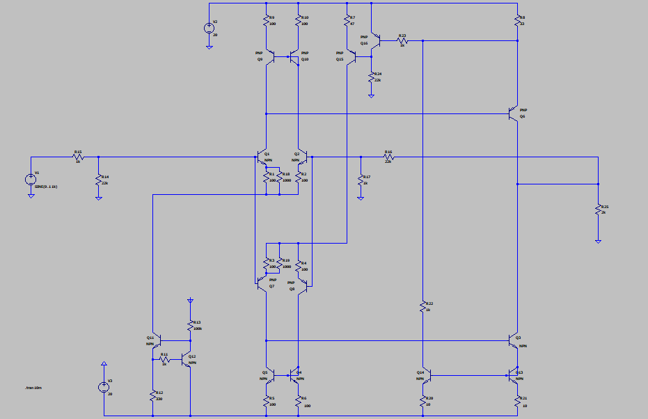

And now for something (not really) completely different.
Attached is a symmetric IPS where the VAS current is regulated. The two VAS currents are summed and control the current constant for one of the LTPs. Both LTP have a deliberate offset that increases the positive side of the LTP to provide the VAS base currents.
