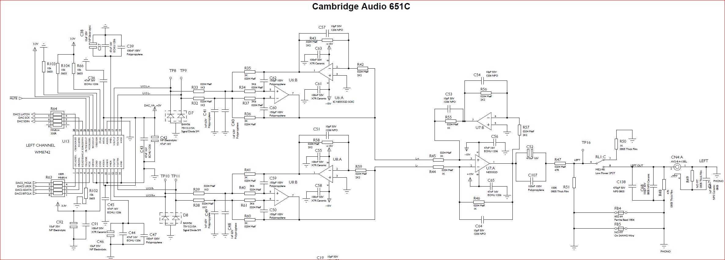

I'm trying to fix above Cambridge Audio CD player.
The initial issue was the CD tray not opening/closing normally. The whole mechanism has been replaced and now works perfectly.
The next issue is quite puzzling, at least to me, not being an expert in this field.
The digital output works fine.
The analog output sounds like a 'bathroom', output is lower and appears to be distorted frequency-dependent. Also, it feels like the sound is not in phase. I.e. using a Hifi News Test Disc the announcer's voice is not there in analog out, while it is loud and clear in the digital output.
I've read most if not all diyaudio messages related to similar Cambridge Audio players. One issue that came up was with the quality of the capacitors over time. To achieve possible sound improvements and fix the issue the elco's on the DA board were replaced.
No luck.
I’ve verified the voltages on the DA Board are in accordance with the listed voltages in the service manual.
I've not seen any messages on blown DA convertors/opamps, so I'm tempted to exclude that as an option?
I do not have crackling/loss of sound. Both channels appear to misbehave in the same fashion.
I've measured the resistors around the opamps; these seem to measure as expected.
Yet, it would seem to me, as an amateur, the issue must lie somewhere in the summing of L+ L- and R+ R- and filtering/feedback subsequent to the DA convertor?
Can anyone shed some light on this issue?
How to get the core issue? What am I missing here?
Thanks in advance,
Bruno

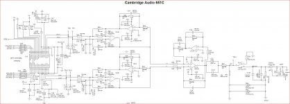

Ok. Is L+ equal to L- except in reverse phase?
What does the circuit behind the test points do?
In the referred message it is stated: "It seems they are using what's basically two "superbal" input stages (Self, Fig. 12) to combine N and P output for each DAC channel, and then another to combine both channels out of phase." Can you explain in layman's terms?

To be completely honest, I'm not sure what's going on. It appears, from the schematic, they are using both sides of a stereo DAC chip in each channel, getting two sets of differential signals and combining them into a third differential signal than combining it into a single ended output. It's one of those "Why the hell would they do that?" circuits and I'm not sure I can trouble shoot it without getting it on my bench... and maybe not even then.

I would expect the audio on those test points to be 180 degrees phase shifted, one with respect to the other.

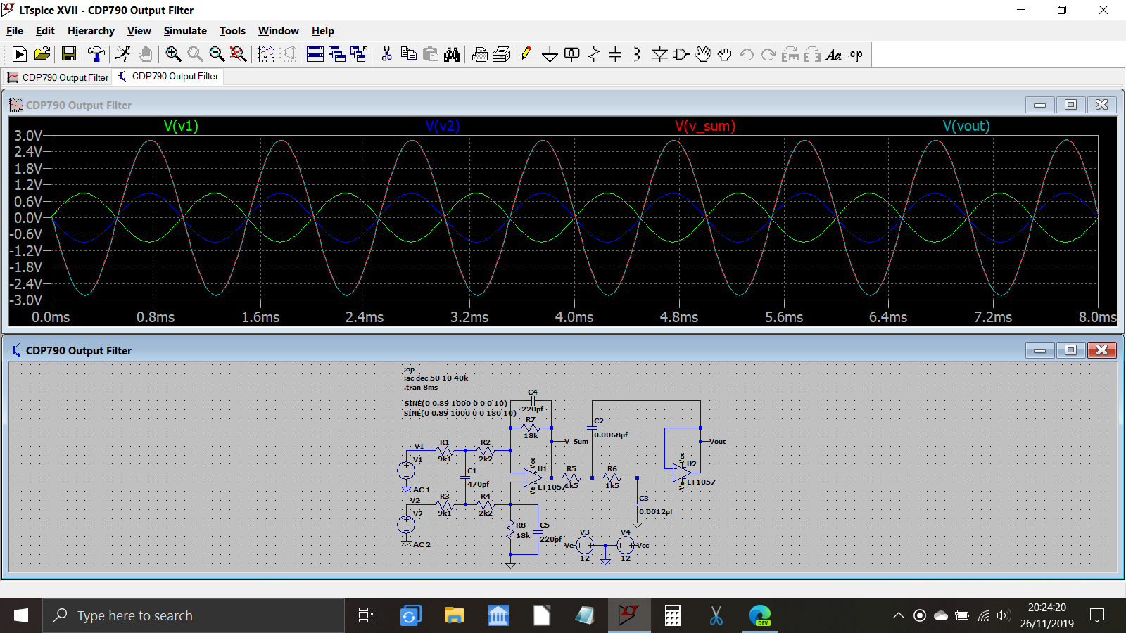

This is a not totally dissimilar circuit from a Sony player and this shows the phase relationships and amplitudes.
When you play a mono test track on your player the two channels should of course show similar phase.
Opamps play by exacting rules and in your circuit I would expect to see ALL pins apart from the supplies to be at near zero volts DC.

I've used a test CD with several sine wave (1/5/10 kHz) tracks to measure at various points in the circuit.
At TP8/9/10/11 the same wave form is shown. I see the wave form before and after R44/45. Hardly any signal is found at C57/C52 and TP16.
Question: I do not see any/180 degrees phase shift between TP8/9/10/11? Could that be caused by the measurement process/oscilloscope i.e. me?

I've purchased the Hantek 2D72 a 2-channel digital oscilloscope. I guess that should work, at least once I receive the 2nd probe?
That aside; given the measurements above wouldn't it be logical to assume the failure is to be found in the circuit behind R44/R45? Also, couldn't I just measure AC V between R44 and R45 to determine whether the signals are in and out of phase?
Once again, thanks for your help.
The fault may very well be after R44/45... and something I've thought of that I should have mentioned at the start is to check that the grounds of the RCA output sockets are OK. If the print is cracked and the ground floating then you would get these symptoms.
Assuming the grounds are OK then we do need to look with the scope at the phase relationship of a mono signal. Given that audio is (in the scheme of things) very low frequency you should be able to use ordinary wire to connect the scope to the circuit.
You could certainly look at the outputs that way and then work forward. For a mono signal each trace should match the other, and if the scope has an 'invert' function for the second channel (which inverts phase) and also an 'add' function (which adds channel 1 and 2) then you should see nothing but a straight line as the two signals (one inverted by the scope) add together.
