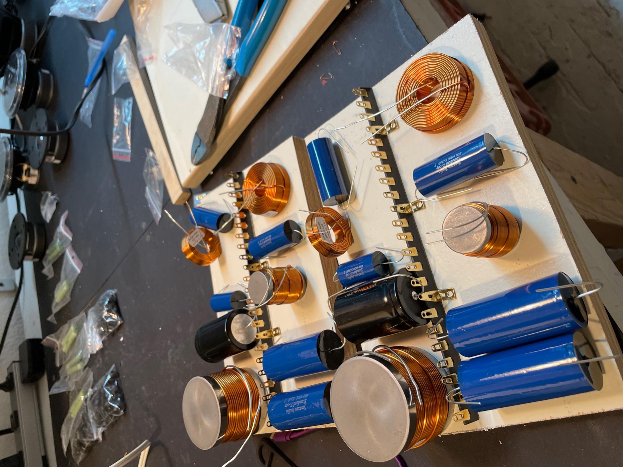

I recently purchased this kit from Jantzen. Currently building them.

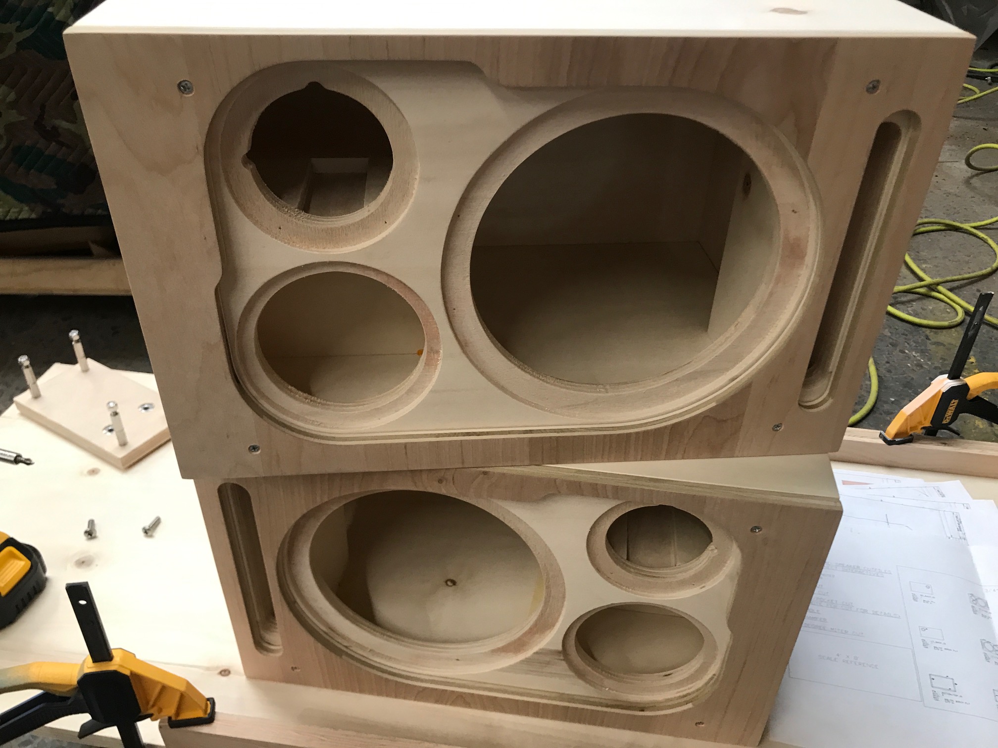

Boxes!
I finally got the boxes made! But unfortunately, due to a recent move I no longer have space or these speakers. Also due to the COVID situation, I need to free up some funds.
So.... I will be putting the whole kit up on swap meet in the next few days. I have all the drivers, crossover parts etc. It pains me, but alas, such is life with DIY.

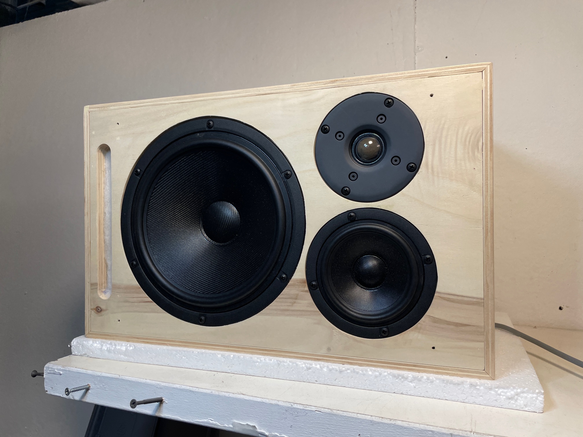

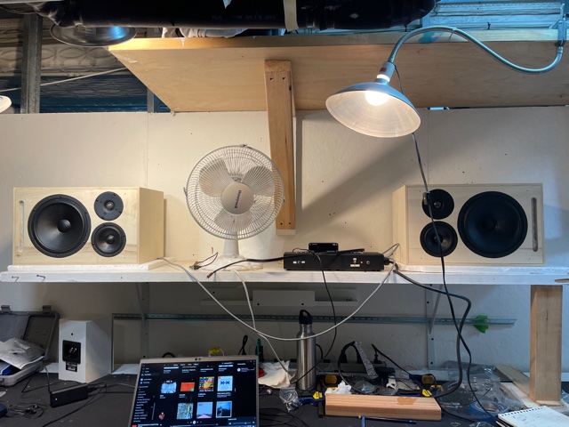

FINALLY Finished
So, I allocated some space in the basement, and decided to keep these speakers. I FINALLY put them together. Can we give awards for slowest DIY'ers?
I have to say they sound really really good. I had gone the small two-way speaker + subwoofer route for the last few years, so I am not used to hearing music straight out of an 8" woofer, in a 3-way configuration no less, and let me tell you it sounds full, and nice.
Highs and mids also sound great. I don't have the time and inclination to measure them right now, so will just enjoy till I get the bug. Building speakers is a major pain in the butt, so glad these paid off.

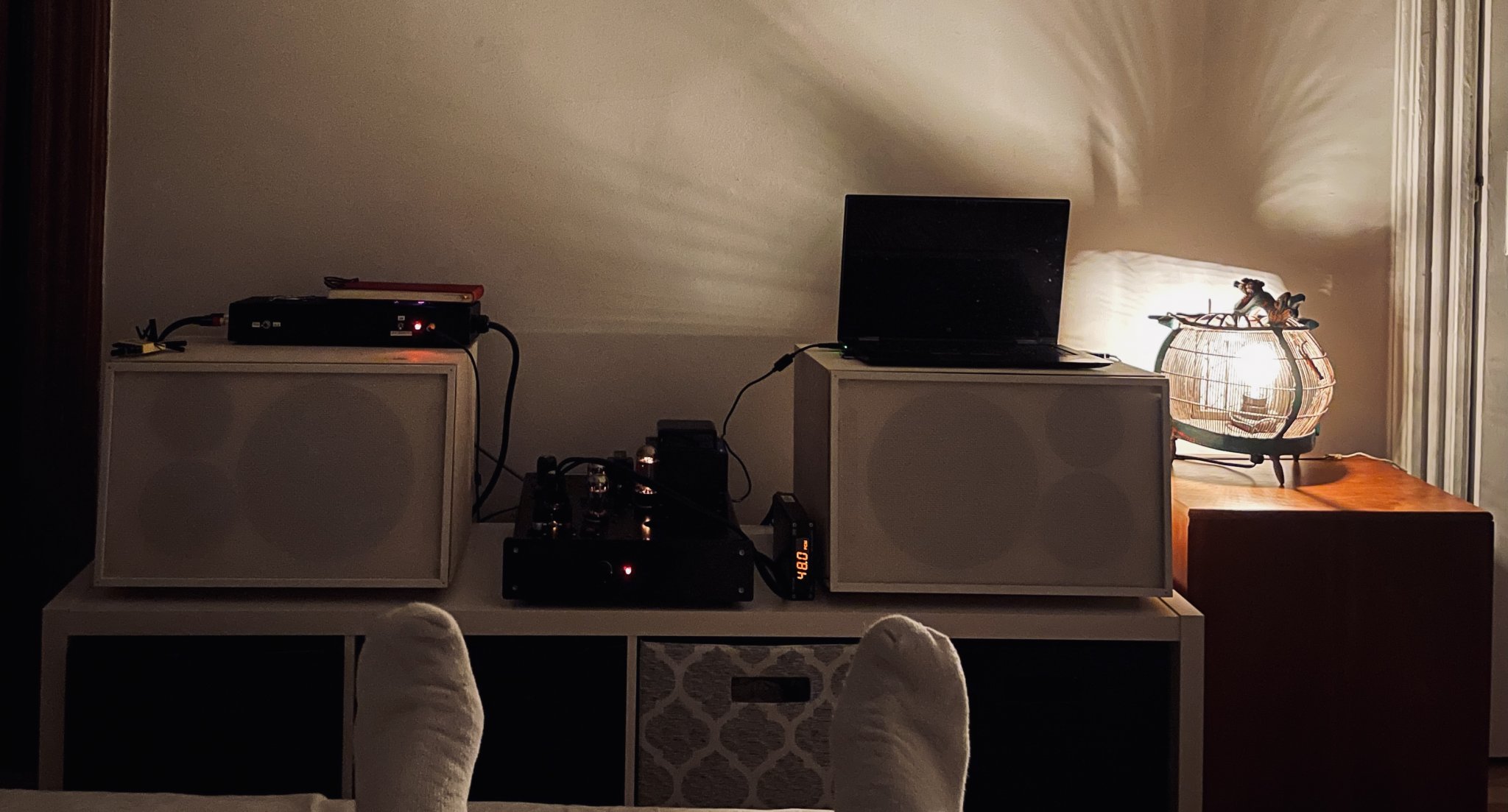

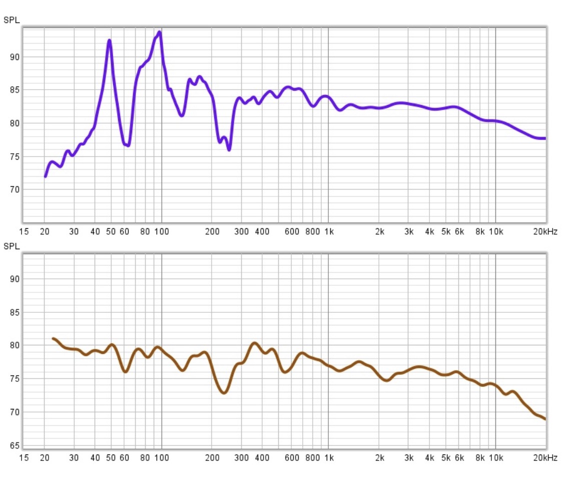

Just capping off this quiet little thread. Made some space in a second bedroom- this setup is probably the best I ever had. Salas 6V6 preamp going into a low gain modified Hypex 120w amp, Troels BS 3WC. Then Eq’d just slightly (knocked the room mode peaks down with EQ APO), and an old REL strata iii picks up for just that bottom octave.
Wow, a long journey but this sounds seriously ******* amazing. IMO I’m not sure how we used to do without Eq’ing down below 200hz. Really finishes it off.
Some before and after REW measurements attached from the listening position. Purple is straight, brown is light EQ below 100hz, with the REL added in. Not much I can do about the suckout at 250. Some of the discrepancies between the two was just because I took a bunch of measurements from slightly different locations for each run and averaged.
Anyway, no more measurements and fiddling. Pretty much dialed in.
