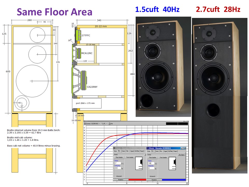

A couple pics comparing bookcase and floor speakers with the same footpring. The low inductance on modern 5" midrange allow "crisp" mid sound with 180 degree polar dispersion up to 2.5kHz, plus a smooth slightly lower crossover frequency to an 8" woofers, and this often simplifies the baffle step compensation.
