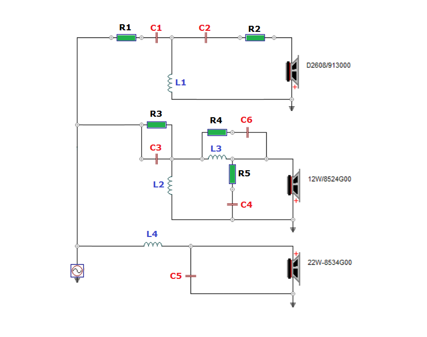

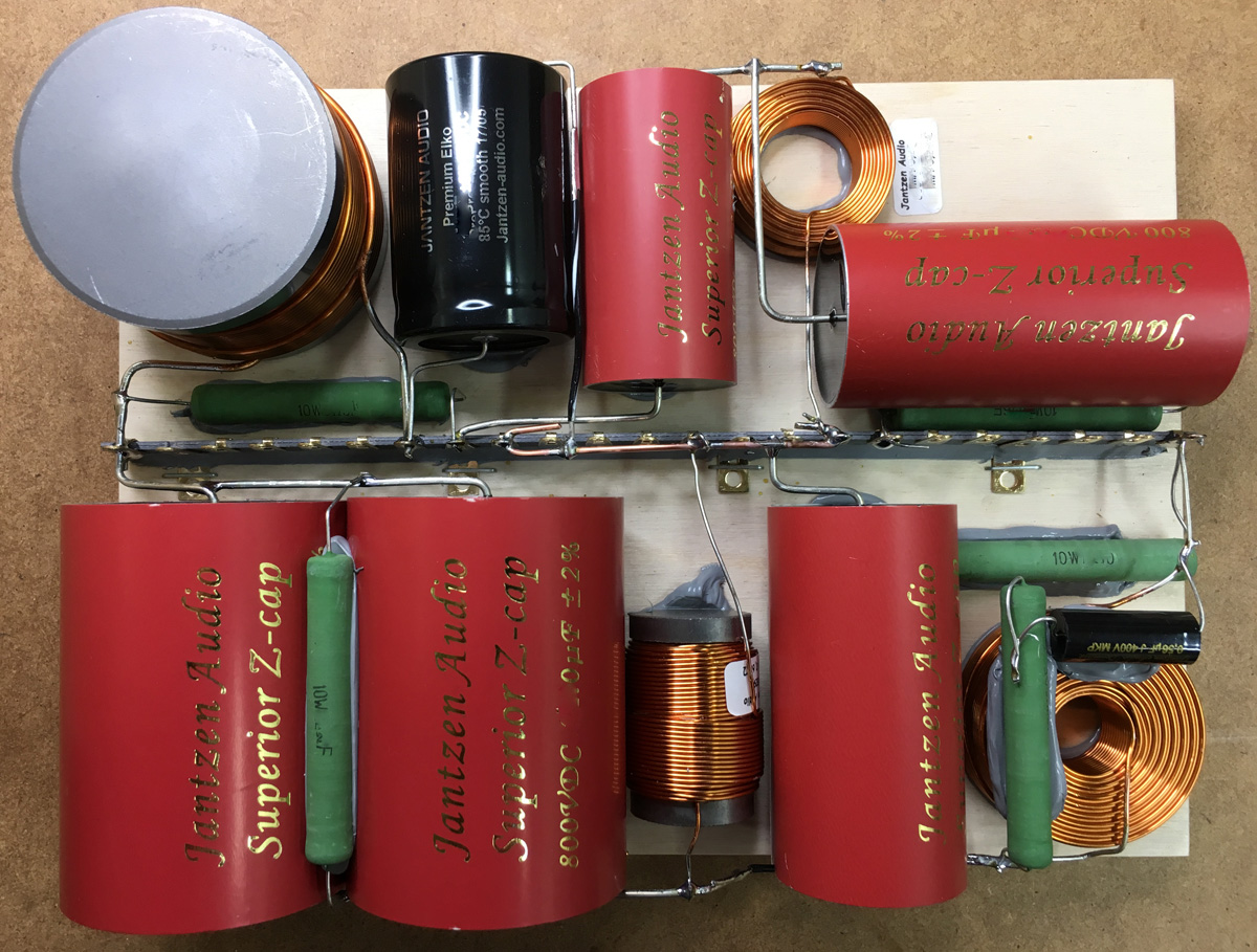

S P L U T T E R ! . . . 15 crossover components ! ?
WOW ! 😱
FIFTEEN crossover components in a bookshelf speaker. :nod:
B&W manage with 4 components in their 2-way DM602s ...
... and they sound AWESOME ! :cheerful:
I'd stick to a 2-way & keep all the extra resistors, inductors & capacitors to an absolute MINIMUM. 😱
Less is more ? 🙄
Nar ... MORE is better ... right ? 😕

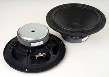

Less Gold Lettered Capacitors & BIGGER Magnets ?
I think I must be missing the point ? 😕
Why spend a million bucks on 'needless' ? expensive crossover components ...
... & end up with an 8" driver, which looks as though it has a pretty darn tiny magnet.

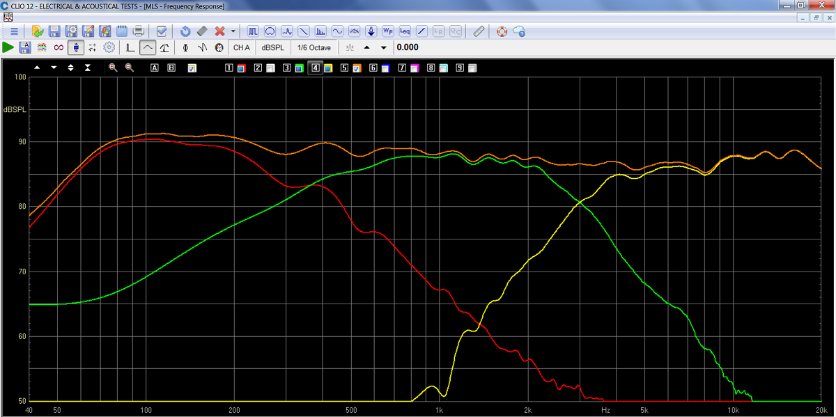

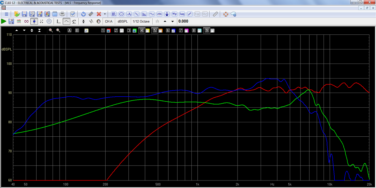

I also don't exactly get WHY one would want to try & merge the performance of these 3 drivers together ? 😱
attachment.php
It kinda looks like you end up with a really weird spaghetti junction of overlapping frequencies. :hypno1:
attachment.php
That ^^ looks CRAZY to my simple minimalist mind ! 😱
& so the SHARPLY defined 2-Way was invented. 🙄

I don't see what your problem is.
-15 parts in a 3-way is actually quite decent. This is because you have a 3rd driver that requires 2 xover filters in addition to the other 2 with theirs. On the principle of a 2-way with 4 parts, means the 3-way would have about 12 in theory.
-Fewer parts or more parts than average does not mean the sound will be better or worse. Resistors are not bad, and they are inexpensive. "Minimalism with respect to necessity", which means you should have what is required, but as simply as needed to get there.
-Tiny magnets? That is your basis? Some of the best bass was from tiny magnet acoustic suspension designs where the enclosure did the majority of the suspension damping. That is an 8" driver, and I would not call that a tiny magnet. It is enough Bl apparently to do the job, and SS does know what they are doing.
- Why do you pick the drivers you want to use? Because you do. Let's not belittle someone's project because you don't see the merit here. Most drivers' overlaid unfiltered responses will look like that, and the last graphic in post #7 actually looks really good. These are the filtered responses and the sum. I think you self-destructed for no particularly good reason.
- Yes, the xovers do have a bit of bling. Troels sees merit in using more expensive xover parts, as well as being a kit designer for Jantzen-Audio. They supply him the parts, and his builds are at least partially paid for by Jantzen-Audio due to their business relationship. However, 5 resistors in a network does not mean it is a fool's errand. My best floor-standing 2-way has 9 resistors in the network, 5 of which are in the tweeter's circuit, and you wouldn't know it listening to them.

Thanks for sharing, tech looks solid both in theory and supported measurements, go right ahead you may learn something new hopefully pleasant. Although it does seem to some bent on keeping it simple that the drivers are overlapping and two way may have been good enough however decoupling the mid-range from the room and woofer at around 308Hz and excessively damping the mid-range compartment may give you a solid sound stage. The designer may have his own reasons for also crossing over at 3000Hz using the current slope. Am more draw towards 2000Hz at this time. There are also many techniques of improving the design further but it is solid as it is now

There are very sound reasons for using three, rather than two, drivers, and Troels has explained this many times on his website. The main motivation seems to be to merge the off-axis responses more smoothly between a woofer big enough to produce decent bass, on the one hand, and a tweeter physically small enough not to beam excessively. You also avoid the ragged upper end of most woofers bigger than about 7".
Alex
" ragged upper end of most woofers bigger than about 7" "
Hi Alex.
This is very true, from what I have learned looking at zillions of frequency specs. for woofers & listening.
There are few 8" woofers that can do that.
The Scan Speak 'possibly' can't ... I haven't seen the specs.
The 'Volt' 8s are one of them that easily CAN.
Come with an ENORMOUS 3Kg or so magnet.
Very light cones.
X-over at 3 KHz without a worry in the world.
And a pretty handy super-LOW resonant-frequency thrown in.
Importantly they 'play GREAT' for every genre of music.
