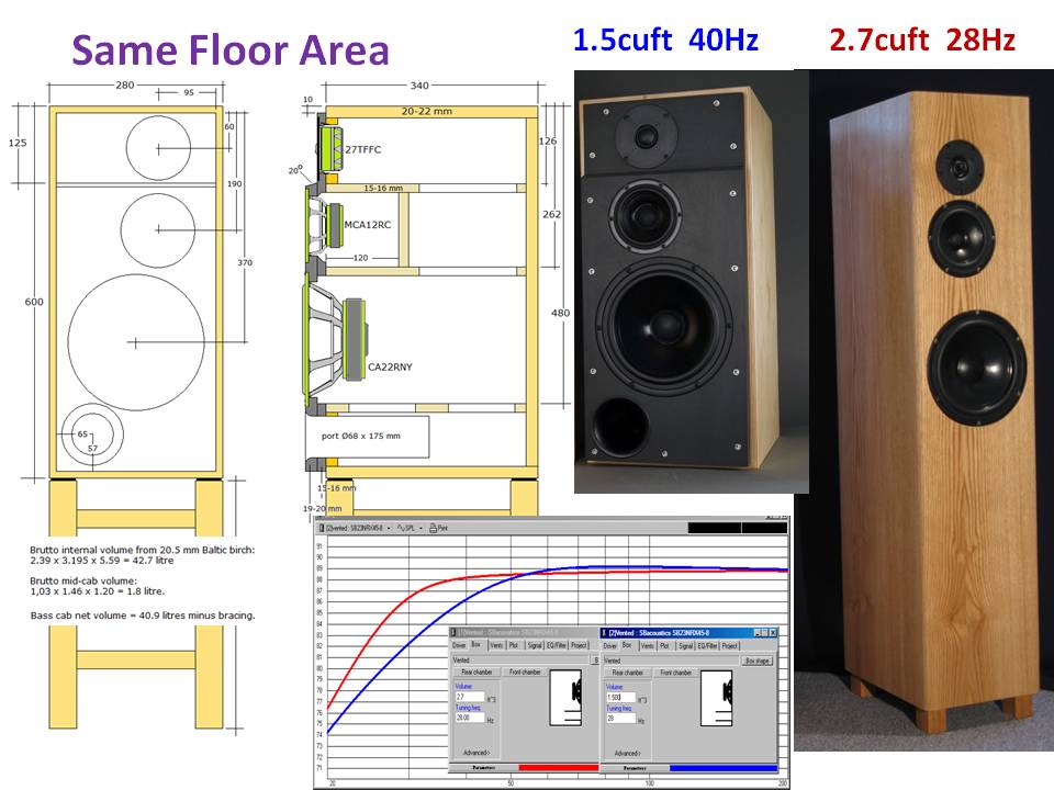

The reason why I decided to go with the 3 way bookshelf is the size of the room where I will be putting the speakers, which is small: 4mtrs X 5mtrs. I'm thinking a 3 way floorstander with a big enclosure for woofer will dominate & excite room modes more.
Troels Classic stand-cabinet with ~1.5cuft has F3~39Hz. For the same floor area, a floor-cabinet with 2.7cuft produces F3~28Hz with the same SB23NRX45 8" woofer. No crossover changes are neessary.
If your furniture style supports a floor standing cabinet, you can get the deep 28Hz bass the 8" SB23NRX45 woofer is famous for in no extra floor area. Low A on a piano is 27.6Hz.

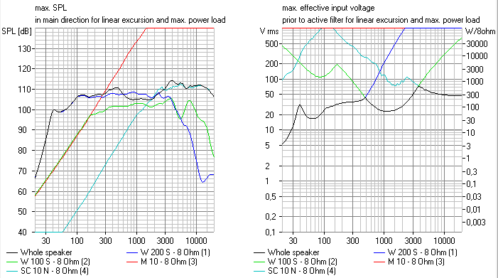

In the case of the SEAS-3-Way-Classic, it is that the goodish underhung H1304-08 MCA12RC midrange is overworked on power handling, as illustrated in Boxsim's estimate below.
One obvious way to do that is to double up the midrange units in series, which Wharfedale did in their splendid room-filling E70. Simple filter conversion of doubling coils and resistors and halving capacitors in the mid circuit for the same SPL with a mere quarter of the individual excursion. Quite how you layout the drivers is moot. I'd favour inline MTM here set off to the side, rather than Wharfedale's sideways offset. Since 3kHz is 5 cms half-wavelength, hardly an issue.
As for bass, you could certainly do closed box (Qts = 0.5) with a suitable driver, but the H1288-08 CA22RNX (Qts 0.41) is not far off anyway.

Hi Linesource, do you happen to have the plans for that floor standing cabinet in the pic? thanks.
If you want to construct a floor-stander using Troels Classic 3-way crossover you would maintain the width and exact driver location on the top portion of the front baffle, and extend the height such that the tweeter is at ~39" ear level. The cabinet depth can also be changed to achieve your volume goal. Change port dimensions based upon a WinISD simulation.
The pictured speaker is from post #26 build of the "Astasia" described here on diyAudio.
