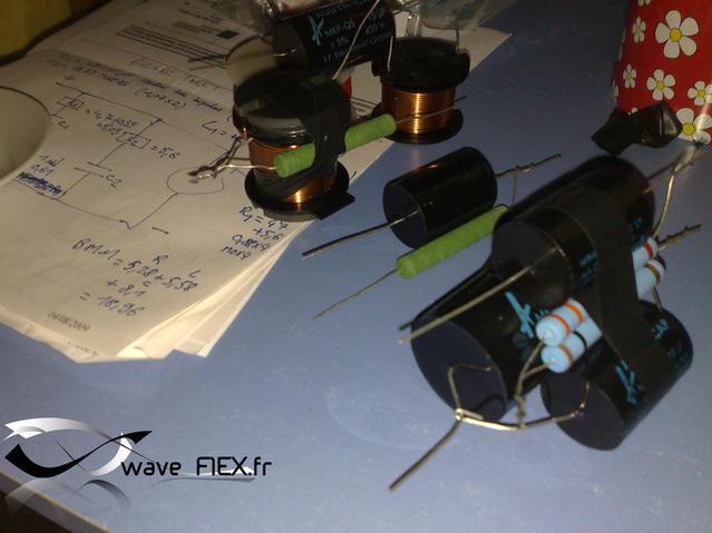

Installing the woofer x-over: 4 neopren pads between the coil and the bracing to minimize vibration and some tape for securely holding the wiring
First test of the x-over before closing the bottom of the cabinet
