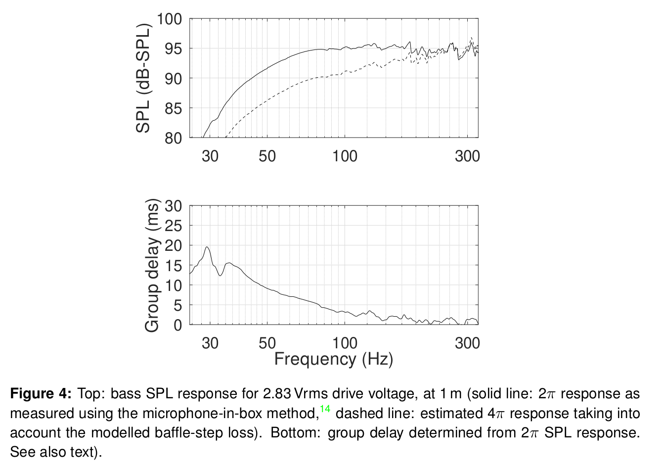

Well, someone has to be the first to find out, that there's remarkably little bass coming out of this 100 liter cabinet despite the expensive 12" woofer! 😀

To shine some light on the bass tuning, here's the measured SPL curve of the Faital 12PR320 (no xover). The box volume was pretty much the same as Troels design, and port tuning was very similar too.
You'll have to consider the baffle-step compensation that is needed to get the bass response right, and what this means in terms of overall system efficiency that is left after baffle-step compensation.
Edit / notes:
(1) Measurement method: R H Small. Simplified loudspeaker measurements at low frequencies. Journal
of Audio Engineering Society (JAES), 20:28–33, 1972.
(2) Baffle step was calculated by Tolvan Edge

That is typical of pro type woofers.If you want sensitivity you have to sacrifice some bass extension.But it is really not that bad.Minus 4 db at 40 hz minus 5 at 30hz. I would much rather have that than the typical small woofer based boom box which has big port /resonant frequency based lump at say 50hz just to achieve minus 3db bass of 30hz.

Well the alignment above shows much worse extension than that Troels is depending on room gain to get him where he wants to go. Nothing wrong with that and also nothing wrong with adding a sub for the really low stuff.

Those figures I quoted are from the updated information and are without room gain.I agree that with room gain the lower bass would be more extended.

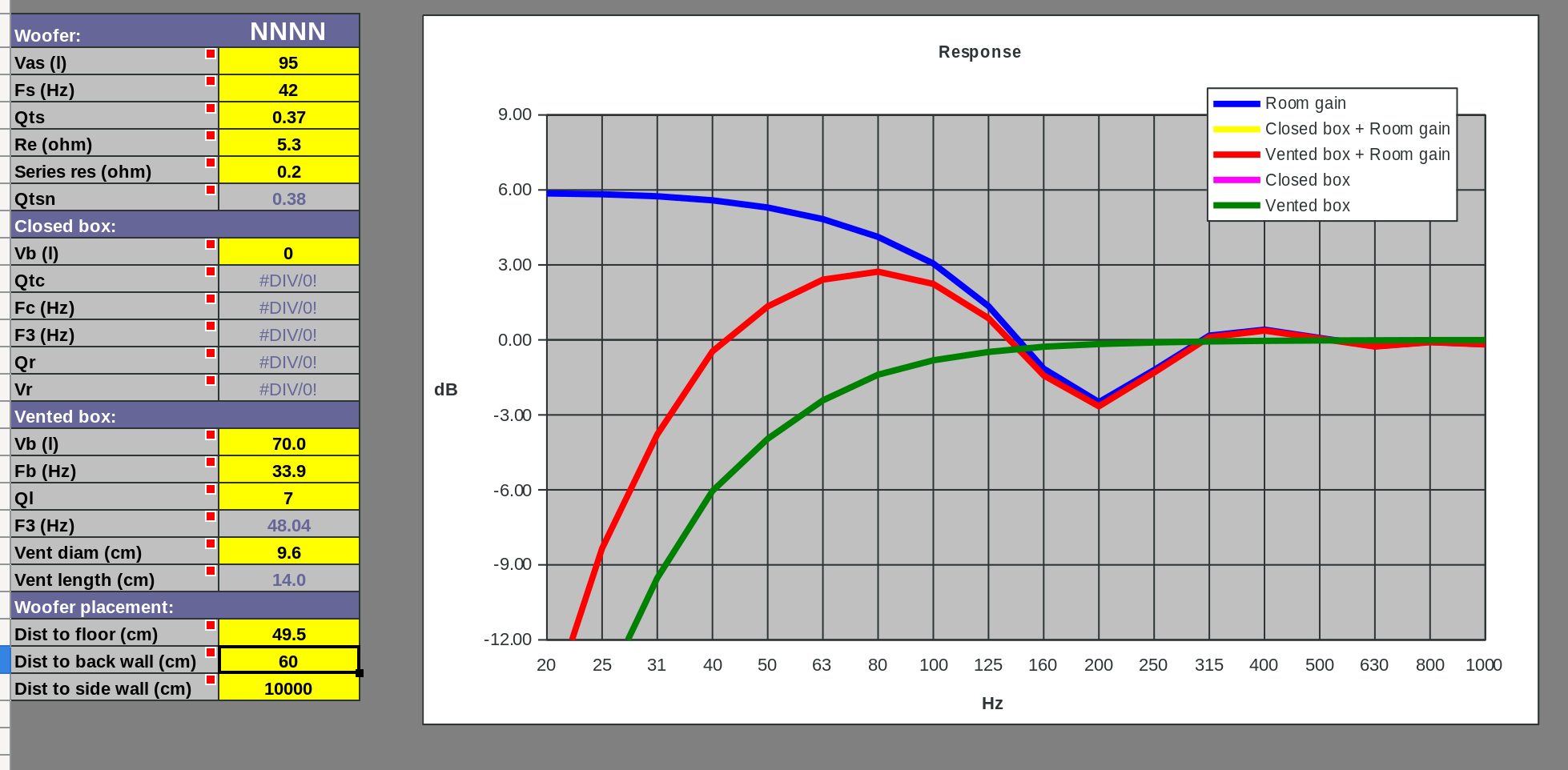

Room gain may well be part of the equation with many speakers. However, I don't think that Troels design is suitable for near-wall setup because the bass reflex ports are at the rear. I would therefore not count on a lot of room gain.

Near-wall and direct-to-wall placement is different in my view, the latter maybe problematic because of port breath restrictions from a too close wall, but my guess is that a 15-20 cm from the wall is enough distance for this speaker.
Anyway, you can place the ports on the front with a little effort.
^I just had a look at the bass boost from the room using the same tool that Troels uses (you can download it from Troels' website). I don't know what parameters he assumed for his curves, but here's mine. I assumed 20cm between the rear of the loudspeaker and the rear wall (as suggested by YSDR), and the woofer elevated from the floor as it would be with Troels stands (parameters as shown on the attachment). The curve looks a bit wild, and very different to Troels' curve. Also, the plain "no-room" curve is different from that shown in Troels' figure. I don't really know what to make of this.
The room curve shows a boost below 130 Hz. However, the baffle step starts at 600 Hz or so. The room boost will therefore not work well to compensate the baffle step loss between 130 to 600 Hz.

Your simulation not looks bad at all, it's within +/- 3 dB down to about 30 Hz with the room gain.
