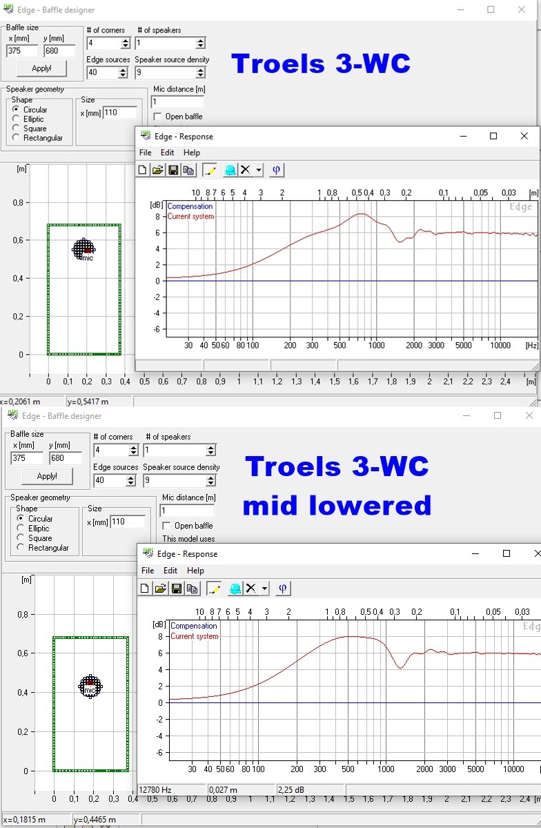

To me it looks like mid-on-top just makes cabinet construction easier
Midline positioning makes edge interferences symmetrical, and they are not in tweeter range anyway in this case.
Mid on top and running to 2,5kHz with LR2 is where the sound comes from!
That's a good point. But why did Troels make a chamber for the tweeter? Isn't the tweeter sealed anyway? The tweeter chamber sort of defeats the "make it simple" argument.
The symmetry of the edge diffractions is exactly what one would want to avoid. Off-center placement would help spreading the diffraction effects from the left/right edges to different frequencies, so they would not add up at the same frequencies.
Also, the tweeter will have much less beaming than the midrange. It will therefore "see" the edges more than the midrange, resulting in more diffraction. Can you do the Edge simulations for the tweeter?
he posts a horizontal dispersion plot which looks more than acceptable to me. perhaps this is why he kept the tweeter on the centreline.
The plots show the horizontal dispersion in a relatively narrow window of +/-30°. In this rather narrow angular window dispersion is largest between 2 kHz and 5 kHz. I can see why dispersion is less below 2 kHz, but I don't understand why it's less above 5 kHz, since the the x-over is quoted as 2.5 kHz, so the tweeter should be dominant from about 3 kHz and up, and there should not be much beaming. Maybe the x-over overlap between the midrange and tweeter is a bit larger than one might think?
