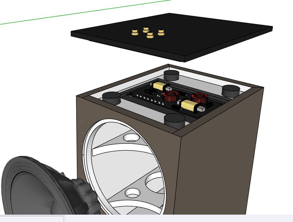

maybe with the idea below, separating top from bass using Iso PucksHighly recommended but how to do it with aesthetism ?

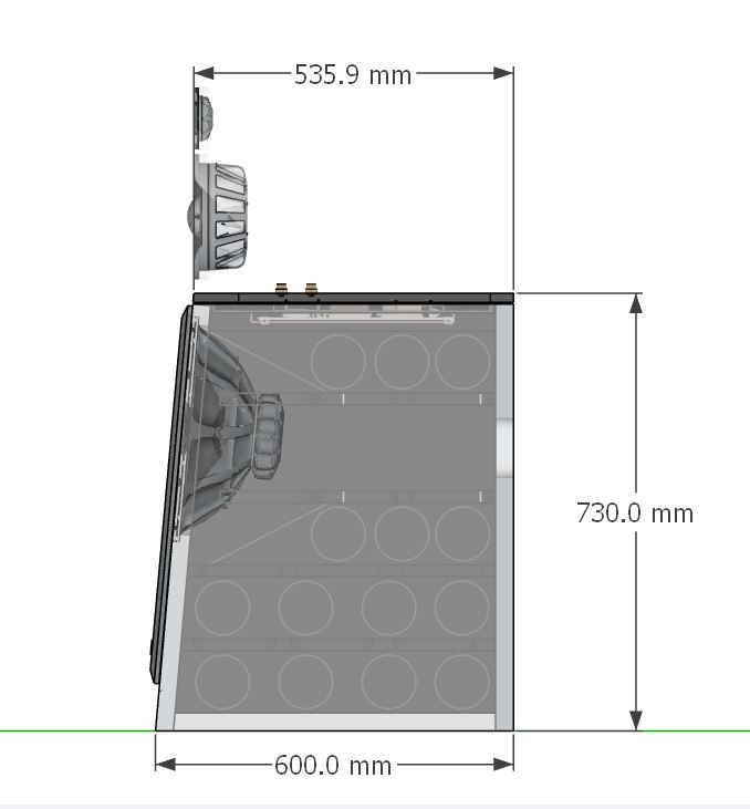

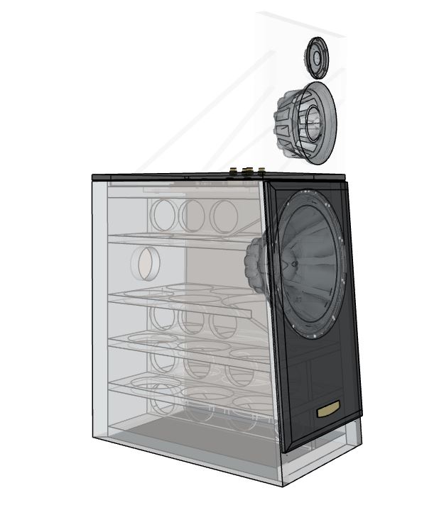

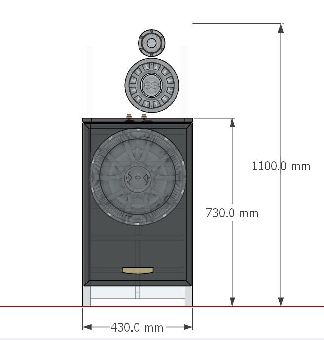

Probably last plans.
The cabinet will probably be out of panzerholz 30mm. And bracing will be 20mm plywood Beech.
The speaker is a bit bigger then I thought it would be...
You could add a lateral vertical brace between the woofer and the reflex hole (going from left to right side walls).
Only problem is to fix the brace on to the back of the driverThe best way to rid of the ring is to use a brace between the cabinet and the back of the driver itself. You'd only need one and it can be acrylic as well
Thanks zman, I like the idea. I thought about it like tensioning a bow with a string. Intresting stuffThe brace can be fixed to the front baffle and to the top of the lower cabinet. The driver magnet should be touching the brace and you can use a hard foam that compresses slightly to create a tight fit between driver magnet and brace.

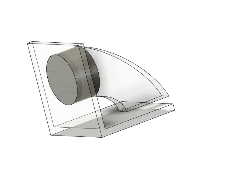

Why not use glass and ask a glazier to cut the various shapes? I know of at least one in Poland that offers a cnc service along with various finishing options, though I haven't used them so I don't know what it would look like in practice. But I think I'd prefer the feel of solid glass rather than acrylic.
I agree with you on higher percived quality.Why not use glass and ask a glazier to cut the various shapes? I know of at least one in Poland that offers a cnc service along with various finishing options, though I haven't used them so I don't know what it would look like in practice. But I think I'd prefer the feel of solid glass rather than acrylic.
Two problems to this idea.
First is precision. I dont trust to get a perfect fit. I have a glass group that can make it but they dont work presice enough.
Second is price.
I will search in this direction though, Thanks!
forget to uploud the first sketches. Eventually an easier approach, not so sure about winning any beauty contest.
Nice thing is that it is easier seperating the mids and highs.
