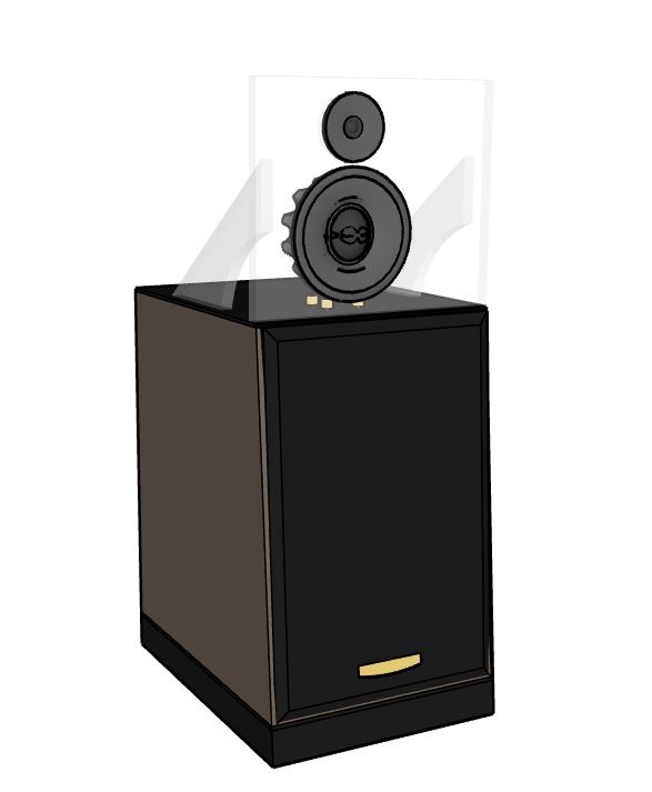

and our different take, using brass and Acryl Glass.

Troel's cabinet design is 500 mm deep for the section housing the tweeter and mid-range; I am wondering if reducing the depth of this section to the thickness of the acrylic panel will have an impact on the mid-range vs the original design.

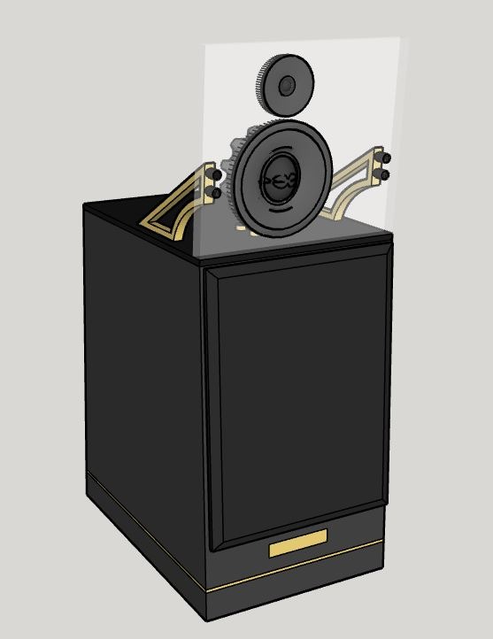

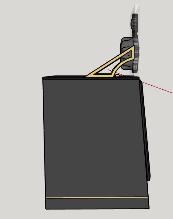

You are absolutely right about the ringing like a fork- will have to think about a better solution... maybe something like this? Althou intrusive

Looking good 👍🏻Here you go with a take on your aesthetic using acrylic for the sides.
I would only use acrylic for the tweeter, the mid is likely very heavy and even your latest design risks ringing because the panels are not constrained on all edges, neither are they braced.
Make sure you buy polycarbonate sheet with good UV protection. It yellows very quickly if its not treated and becomes brittle. Acrylic isn't so bad that way but it also yellows.
That would probably break the visual effect too much, I agree about the vibration, needs to be better braced.would only use acrylic for the tweeter,

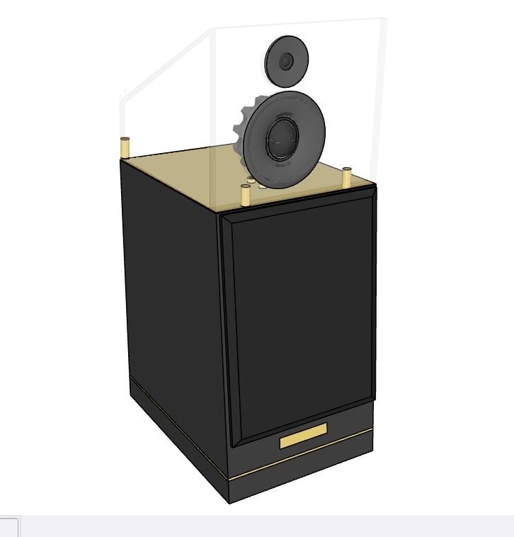

Here is the last incarnation
Good to see that the OB flexing and squirming,
Fixing the edges with a heavy mass in the holes in the middle just makes the problems different.
I would suggest a single brace just off-centre that also supports and bracesm the magnets, particularily that of the midrange.
You moght also consider isolating it from the woofer enclosure (which could also be better braced.

I didn't know Acrylglass was not ordinary acrylic, which cracks easily.
I would brace as high as you can to the front panel.
Would be difficult bracing this strange driver, but I totally get your point... needs more thinkingwould suggest a single brace just off-centre that also supports and bracesm the magnets, particularily that of the midrange.
A very elegant and easy solution would be to make the acryl baffle wider, bend the edges back (heat). You could do that on all 4 edges. Such a rounded edge would also create less edge diffraction.
I will have to find someone that can pull such an operation. I can only assume that bending 30 Poly or plexiglass is not an easy taskA very elegant and easy solution would be to make the acryl baffle wider, bend the edges back (heat).
