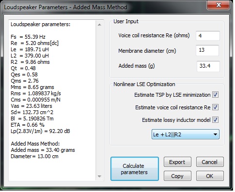

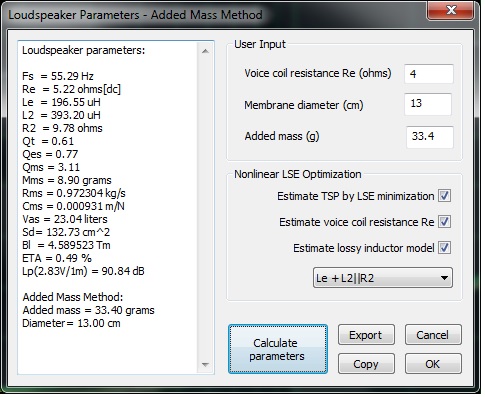

I measured the TSP of a C17WG from the Dali 104 some time ago, and added two different magnets (one bigger and one smaller). Below is what I got. Not a very scientific test (quick and dirty) but it indicates the Q and what happens with added magnets.

With that high QTS and small cabinet for the drivers the port will not give much output anyway so stuffing the port will not make much difference. You would need bigger cabinet or heavier/more stuffing.
The Dali 104 cabinets are very resonant and not braced. The walls should have asymmetrical ribs (stiff glue) and bracing (soft glue) together with damping pads.
Added magnet is a good idea (Troels did that). The stuffing in Dali 104 is something different: Acoustilux along the walls and around the upper 6,5" while the lower 6,5" are not "dressed" and breathes more free against the BR-port. For the Living Voice they did lower the xo- frequency relative to Dali 104. I may suggest that the Vifa Xt25TG30-04 will be very appropriate (fs=436) for this purpose, even frequency response and nice waterfall. While refoaming the C17WG, you may also add felt to dampen the pole piece. I'll do that as the dust caps are broken and need to be replaced. I bought the surround and dust caps from Speakerrepairshop as Cbarth refereed to.
Yes, or extra magnets to lower the Q.
