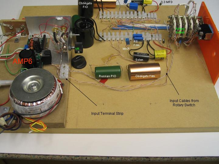

Test Bed
This is a picture of the Test Bed I am using for the Coupling Cap Test.
I have labeled the various caps on the test bed, and the major components external to the AMP6. Just above Vol (Volume Control) is the sleep toggle for the AMP6, which is not labeled..
All of the cabling is CAT5 and the leads to the caps are all the same length. Thus, any aboration due to the length of the wires is the same for all caps under test.
I regret not having posted tests results of late. Other demands on my time - family, work, etc. have gotten priority over the tests. I will be posting results of test conducted on a pair of film caps over the next week.

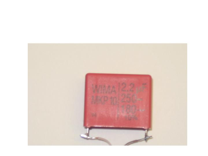

WIMA 2.2 MFD Review
The following only applies to the burned-in (BIC) WIMA MKP-series 2.2 MFD capacitors as compared to other capacitors I have tested. I also have a set of MKP-series 3.3 MFD WIMAs I will write up only if there is a significant difference over the 2.2 MFD caps.
The WIMAs yields the broadest soundstage of any capacitor I have tested. The sounds seem to emanate from a much wider field than the speakers by at least a meter or so. These capacitors also yield the most body – not presence. Bass just sounds much fuller and acoustic string instruments just have a woody tone. Although, there is more body the presentation is not artificial. The bass sounds balanced and is not so pronounced as to be distracting.
These capacitors play much louder than any other capacitor I have tested. For those that may have concerns about the Tripath amplifiers being able to drive or play louder; then the WIMA is the cap one should choose.
The WIMAs have a certain holographic effect especially on the Mark O’Connor Hot Swing Trio CD. The effect of the violinist swaying back and forth before the microphone is surreal in its life likeness. These capacitors did everything all the other caps did “just” a little better. Only the Auricaps sounded better on large symphonic works. The hall on Pictures at an Exhibition sounds considerably larger when played through the the Auricaps. The WIMAs have a much broader soundstage but the depth is not a great as the Auricaps.
I would use the WIMAs for rock, blues, pop, and any electronic based music. This is not to say that these caps are not to be used for classical recordings. I just think that they are better suited to chamber performances or smaller works over symphonic works. On symphonic works thes caps place you one or two rows back from the orchestra – up close and personal. The WIMAs will just move you so much more than the other caps. If you want to become physically involved in the recording this cap is the one. There is some overall sibilance on female vocals compared to the other films but not as much as the Solens. The sibilance would not be noticeable at all if I had not tested other caps.
The WIMAs are physically large. Not as large as the Obbligatos, but not as small as the Solens, Auricaps, or Radio Shack films. The electrolytic capacitors are microscopic compared to the film caps. These caps should fit on a TA-10.1, printed circuit board but will pose mounting problems for everthing else.
The Auricaps sound somewhat more refined to my ear. This is a personal taste “thing”. I just prefer the overall presentation of the Auricaps. It sounds that the Auricaps just has more air around the performers. The Auricaps are more “relaxed” or laid, back. The performances played through the Auricaps just sound more alive to me.
Detail wise the WIMAs leave nothing to the imagination. These caps deliver everything in a big way.
The BIC WIMAs measured 2.23 MFD and 2.29 MFD. These caps are 10% tolerance 250 Volt units. The MKP series also comes in 5%tolerance. Cost vary widely depending on tolerance, voltage, and distributor. Select a distributor from http://www.wima.com/EN/distribution_int.htm or perform a web search.

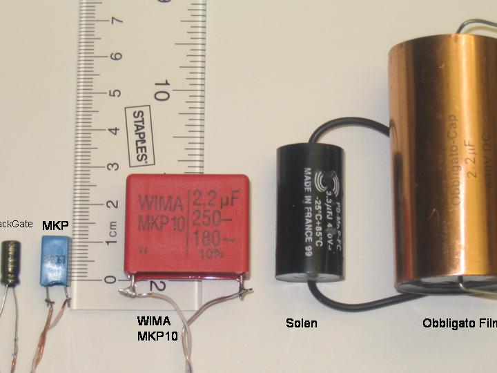

Film Caps
The attached photograph is of a few of the caps that have been tested. The Blackgate was included for the purpose of scaling the relative size of the various capacitors. In addition there is a ruler in the photo.
