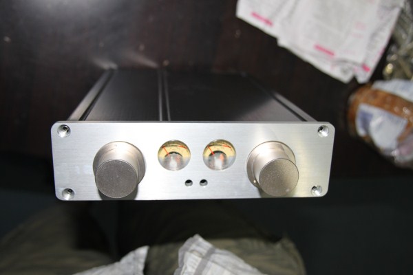

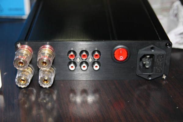

Hi there,
Im working on some cool stuff now, new housing for my own amp using my own PCB's.
i might sell it also if there is interest for it. i want to make something like i have running now, a TA2020 MKIII with my valve amp ( running 24/7 now in test phase ) and a SMPS to power it. and i add 2 VU meters for fun
ill show a photo.
Greetings!
Arjen

Hi there,
This amp can be equipped with TA2020 or TA2024, witch ever you prefer
the price indication is around 120 Euro, i hope i can get that price down, but it depends on quantity and my negotiation skill in Chinese ;-)
for that you get a fully finished amp with 3 channels input valve pre-amp, MKIII board and 3.5A SMPS powersupply inside.
i hope it will be done around 2 weeks from now.
Greetings!
Arjen Helder

Hi Arjen,
what kind of preamp you use? CF? Tube? PS voltage?
I like to use your old green boards (modified) with different tubes headphones amps, gain is too much, but I like how it sound.

Whelibob,
Yes, i do not sell kits, just fully finished boards.
Zigis, i use a double triode 12AU7 valve for this, the amp was designed for me by a friend that used to design for Siemens ( 20 KW FM transmitters, enz )
Its more a Valve Buffer, it does not amplify, it changes the sound so that it has that tube warmth and smoothness, making the TA amps sound like a valve amp.
the plate voltage is made with a cascade and a NE555 IC, very simple, no noise and a band with or 253 KHZ at -3DB, so, plenty!
the NE555 works at around 40-50 KHZ switching frequency.
the plate voltage is around 40 volts, more than enough since i don't want gain!
the tube board only needs 12 volts, the NE555 works off of that.
Greetings!
Arjen Helder
