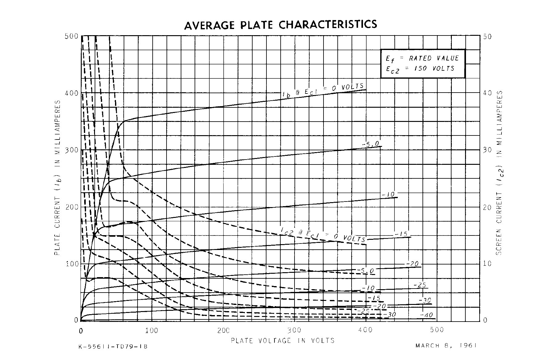

Triodes Have Similar Damping Factors & How the Output Transformer Will Further Reduce That
You can see that even the 811A with just 8dB CFB will get around 2 DF as measured by my friend Michi:
Good for your friend Mitch & his prize winning amps, But your example fails the test in regard the points
of my original post. In several ways.
The 811A is not a common audio tube. Other than as a PP Class B modulator.
No mention at all in regards Class A operation in the RCA Transmitting Handbook.
There is a short form sheet recently from Amperex on the 811, close enough.
In this cct the 811A is running Class A2, not covered at all in my piece.
Doesn't tell us what % of the signal from the OPT is fed back to the 811A.
The NFB to the input can be set to any degree desired long as phase shift is looked after.
So can be used to push the 811A real hard. Just another way to lower the DF.
None of these factors will change the impedance put in the path of the signal from the 811A to the lautsprecher.

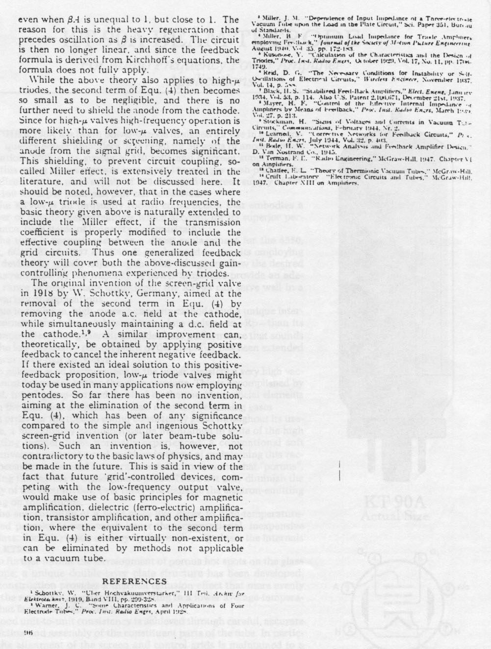

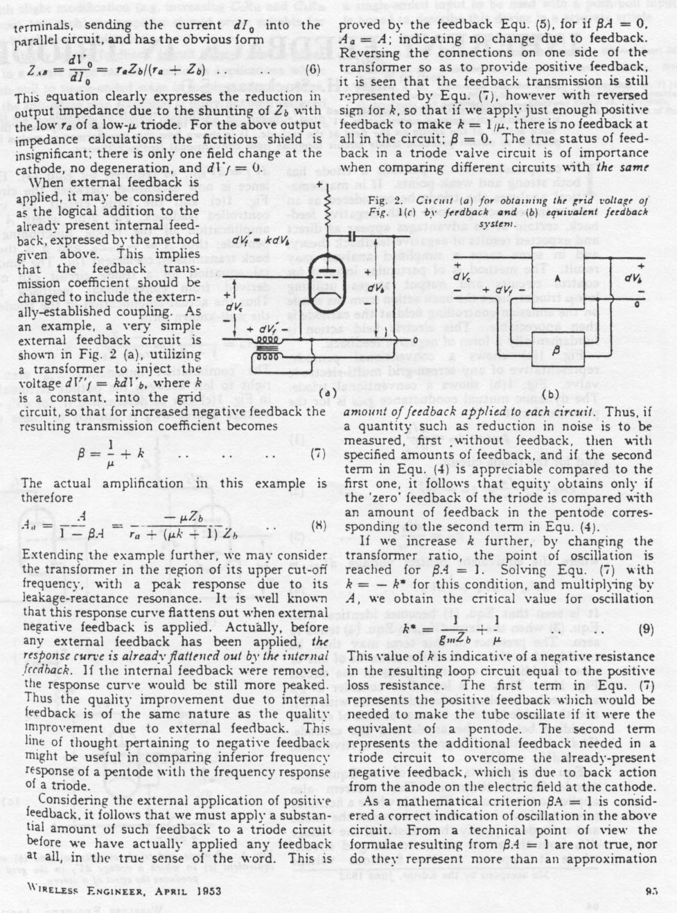

A pentode with CFB (or Schade fbk) is effectively behaving like a triode. Or the other way around, there was an old article showing that the triode can be (mathematically) derived from a pentode with internal feedback. Not surprising. Feedback in the real world is everywhere. Just need to use the best type for the job at hand....
Maybe this one. 😀

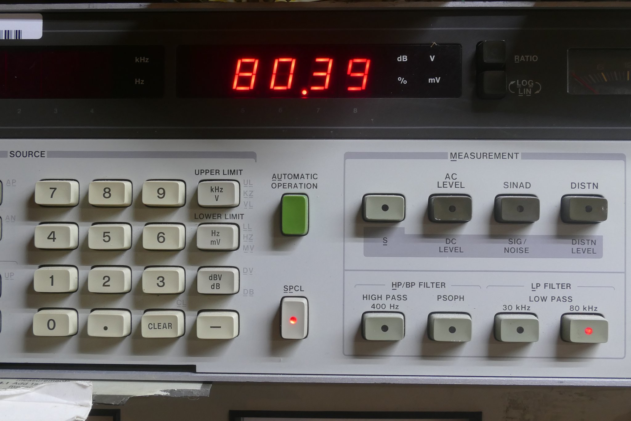

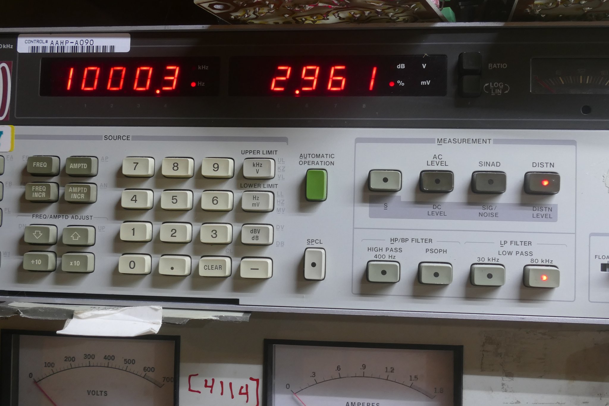

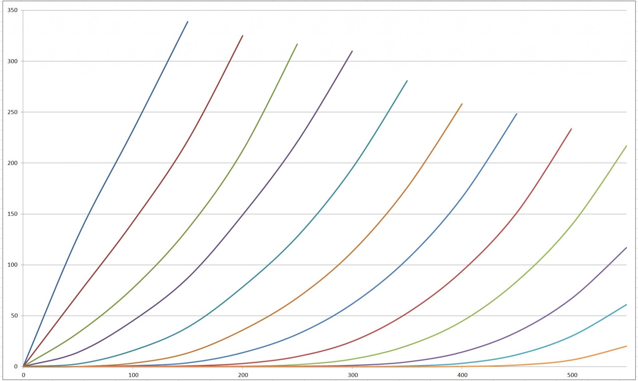

Want to make triodes out of pentodes, add a mosfet follower to feed the cathode and tie a resistor divider from plate to grid to ground. The first picture shows the pentode curves. The second picture shows the converted curves with the same 150 volts on the screen grid. These curves were taken by hand using old analog power supplies and cheap DVM's that's why the spacing isn't exactly perfect.

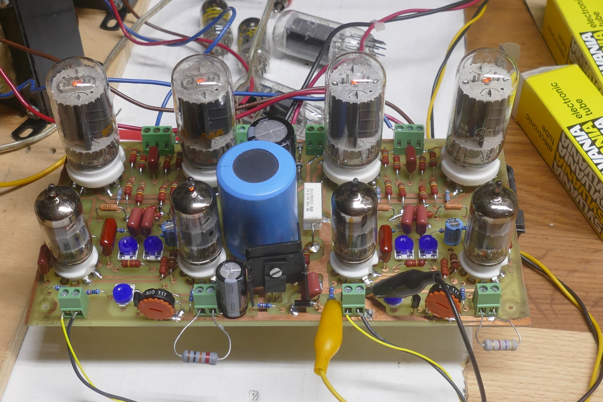

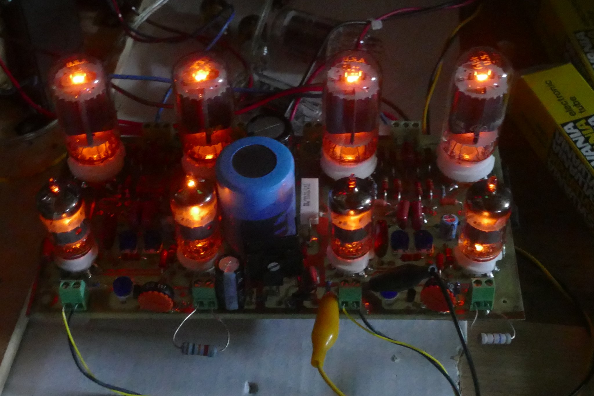

The last 4 pictures show a test amp running two pair of these 6GF5 tubes in "triode mode" for 80 watts at 3% THD. No feedback is applied other than the direct plate to grid local feedback in the output stage. The output impedance was somewhere around 1 to 1.5 ohms and much of that cane from the guitar amp quality OPT's that I use for tests that could end badly. This amp still works though.

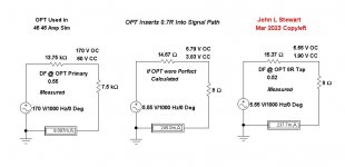

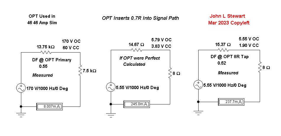

After all the noise, here is another calc of resistance inserted into the audio path by the OPT. One of the original intents of this thread.
This one is the OPT used in the Sims for the 46 46 A2 Amp in the other thread. Looks like ~0.7 R on the 8R lead.
I've been on DIY a few years now, I don't recall anything like this being covered before.
The target efficiency of 85% is met, check the power into the OPT at the final 46 plate vs power out at the load.
This information is primarily for Newbies & Lurkers, And others if they wish.
Not for all the 'Know it Alls' here on DIY. 😀

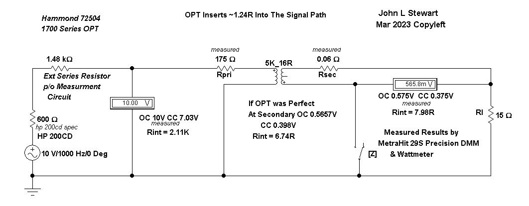

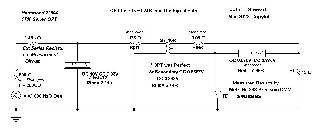

Here then yet another flight into the World of 'Where Are We Now'.
This is a never used Hammond 1700 Series OPT I boght circa 1960. Still in the box with the packing.
These were offered as a good alternative to the Partridge OPT recommended by Williamson for his Amplifier.
The actual voltages & resistances have been measured using a MetraHit 29S precision DMM & Wattmeter.
https://www.gossenmetrawatt.com/english/produkte/metrahit29s.htm
In both calcs & simulations its good to see the estimate of the source resistance is close to the actual numbers for the 200CD & Series R,
I will leave it to the mathematically inclined to check my work. Hope I didn't screw up! 😀

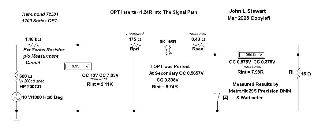

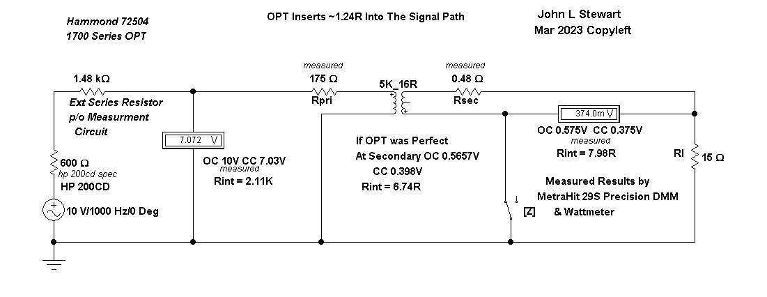

Here are the Sims corrected, the 16Z tap on the Hammond 1700 Series measured 0.48R DC.
The measurement this time is 4-terminal to eliminate lead & contact resistance,
The current source used is a small CC PS I built circa 1970, about 400 mA max.
It is very useful for low resistances & non-linear devices such as diodes. It was run for about an hour to stabilize before measurements.
Test current was 206.7 mA, voltage across the 16Z winding was 99.0 mV. So R of the wdg is ~ 0.48 R.
Good to see the Sim calcs are close to the actual measured results. And THX again to gorgon53 for checking my work. 👍
