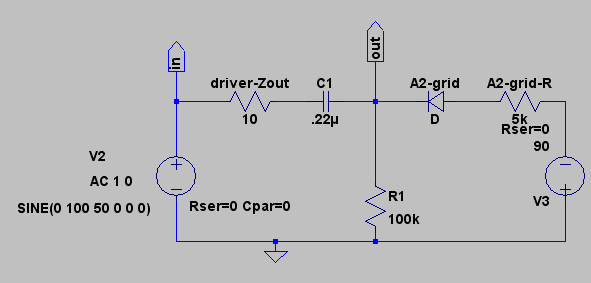

Just LTSpice. I'm at work and don't have access to the files but the circuit is simple. An ideal AC signal source drives a resistor (R1) and cap (C1) in series. R1 represents the driver's output impedance and C1 the coupler. The load is a diode, resistor (R2) and ideal DC voltage source in series. The diode is of course the grid under positive drive, R2 the grid impedance under positive drive (estimate from data sheets) and the DC voltage source set to the output tube bias voltage.
The resultant distortion spectrum when the AC source is set higher than the DC bias voltage is amazingly similar to what I see when using tubes. Comparing distortion profiles when playing around with R1 and C1 is highly educational.

Indeed, in case of class A push - pull output stage audible differences are like "Ultra - linear is louder than triode one".
ilimzn said:...so you get a operating point shift and distortion - the size of the cap really does not matter in principle, it only changes how long it takes for the operating point shift to occur and return to normal once overdrive is removed...
I thought so too but it doesn't appear to be so. The coupling cap is an impedance in series with the Zout of the driver. If the driver is a typical R loaded plate with a Zout in the Kohms, the cap isn't nearly as critical. If however the driver is a low impedance follower of some sort, the cap becomes a major factor because it's the primary impedance facing the output grid. In part this has nothing to do with shifting operating points since the phenomenon is clearly visible in the circuit below which contains no tubes. It's entirely due to the physics of a non-zero impedance voltage source driving a diode junction. Changing the cap from the shown 0.22u to 47u drops THD almost 40 dB for a constant Vac drive.
rdf said:I thought so too but it doesn't appear to be so. The coupling cap is an impedance in series with the Zout of the driver. If the driver is a typical R loaded plate with a Zout in the Kohms, the cap isn't nearly as critical.
Agreed, of course - there is simply not enough current to change the charge state of the cap. In most cases any blocking distortion that arises in such designs is simply cured by increasing the capacitance, as clipping is generally short term. Besides, the coupling cap already forms a high pass filter with the grid leak, so should be dimensioned for it's turnover frequency to be well into the infrasound range.
Of course, due to it's impedance becoming lower. The charging of the cap is a rectification thing, so 'nearly DC', not harmonically related, not steady state and will not show in a THD plot. However, if we were only monitoring AC grid drive, which is what your circuit demonstrates, what you say is certainly true - the AC voltage of course gets majorly distorted by the ratio of the follower + cap impedance to the non-linear grid impedance in A2.
That being said, the actual DC at the grid obviously impacts how an actual tube will behave, meaning, the operating point of the tube shifts towards cut-off. The thing is, because music is a complex and very 'peaky' signal, by increasing the value of the cap you ot only reduce it's impedance compared to the grid impedance (which you need to do anyway), but you also make the time needed for it to charge and discharge possibly long enough so that operating point shifts become small enough under real input signal conditions, to make the design perform adequatly. In other words, the 'evil day' is postponed till a condition of more long term or harder overdrive happens. Because we are not talking about a single stage in a real amp, further trouble may well occur in the other stages which makes the point of shifting bias obscure - as always, it's a question of balance.
While I don't disagree with what you're saying I have to stress again the distortion in A2 sims is strongly correlated to the composite impedance driving the grid. Getting rid of the cap and increasing the drive 'resistance' has the same result. And while blocking is a consideration it's one which to an extent can be tamed via grid chokes (not without their own issues.) Ultimately though there's little distortion benefit to a very low Zout follower drive stage when coupled with a small value cap, even with a time constant in the infrasonic. The cap's impedance apparently becomes the dominant factor determining distortion under A2 conditions.
This has been an interesting discussion and I'm looking at factors that I didn't consider earlier.
It all started because I saw a post suggesting that a low Zout using a MOSFET follower will help driving the 300B better. So I assumed that adding a MOSFET follower after the second stage on the JE Labs circuit will work better ! Now it looks like there is a lot of disagreement about this.
Mainly because of the coupling capacitor which is there in many circuits .
The consensus seems to be that with a higher Zout in the driver stage and using a R load on it , the coupling cap has a lesser influence in the performance. Right ? If so then a CCS on the anode of the driver should be a shade better still.
I can't see a clear conclusion from the discussion . It appears that the standard R loaded driver would give a better performance (?).

I haven't followed all the arguments in this thread but I don't understand what coupling caps have to do with a source follower driver.
The circuit I'm used to seeing is a source follwer direct-coupled to the grid of the OP tube. The MOSFET is capacitively coupled to the previous stage and its gate is negatively biased. That sets the voltage at the source and, thus, the OP tube grid.
Putting a coupling cap between the source and the OP tube grid seems futile, because it would take away most of the benefits of a low impedance driver.
Precisely so, that would be the way to do it. However, Ashok posted a schematic on the top of this page which started the discussion of what happens when you try to drive A2 through a coupling cap, as in that schematic the coupling cap is between the follower and output tube grid.
Ha .........now we are talking ! The cap should have been moved to the gate of the MOSFET. That should settle the need to remove the cap from the source of the MOSFET and dc couple it to the 300B. OK , so I think I'll go ahead and try that .
