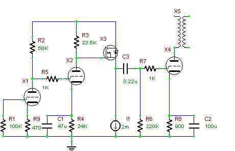

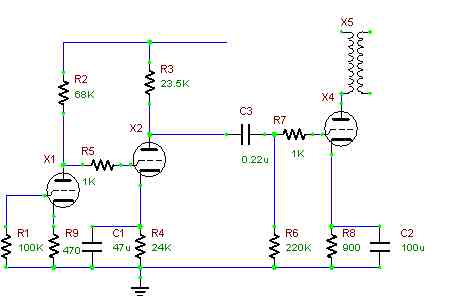

Re: MOSFET driver for 300B
No, since the grid current charges the coupling capacitor.
ashok said:I've attached the JE Labs 300B SE circuit with a MOSFET driver in between. Will this work well ?
Miles Prower said:

Hi Ashok. Hours of simulations strongly suggest the largest distortion creating components of your circuit will be the coupling cap and grid stopper. To my surprise it has nothing to do with tubes and is solely related to a non-zero impedance driving a diode. That's when the 'tubelab' light came on in my head. If the sims are representative of reality, ditch the grid stopper and go direct coupled CF if at all possible. The distortion reduction in A2 isn't subtle.
