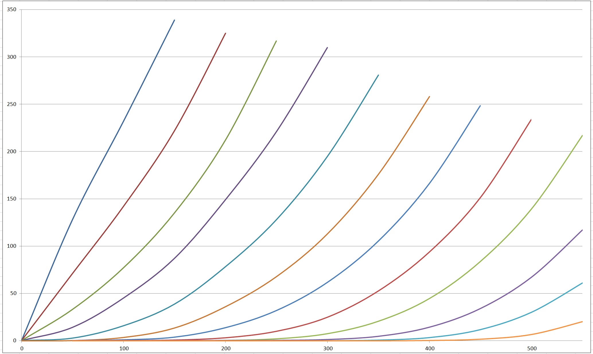

So, what configuration makes curves like these with a 15 watt sweep tube? How many sweep tubes can eat 550 volts in triode? The voltage is only limited by my Fluke 407D power supply.
Note the data behind these curves was generated with old vacuum tube linear power supplies and Harbor Freight meters, then plotted in Excel. The inconsistencies between the left set of green and purple lines are caused by inaccurate voltage settings.
More details to come after I have built a few working amps. So far I have not been too successful with two tubes actually exploding. After shelving the project yet again, I discovered the stupid math error that caused the shattered tubes....pesky decimal point......24 watt tubes (6DQ5) do not like dissipating 200 watts, not even for an instant.

My first guess would be an R divider from plate to cathode driving a Mosfet follower, which in turn drives the screen grid at some % of plate V. A sort of reduced voltage UL mode, looking like a triode, to be compatible with the low screen voltages of TV Sweep tubes.
It would be nice if some way could be found to reduce the rollover of the resulting triode like curves at the HV end.
