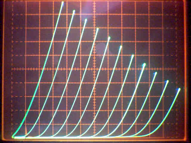

Then there's the perfect triode, an old low gm pentode wired in triode mode:
http://www.diyaudio.com/forums/tubes-valves/170746-could-perfectly-linear-triode-10.html#post2257342
That 6SN7 looks like it gets beat by any old pentode.
If you want to see great triodes, they are high current rated (big flat cathode) sweep tubes wired in triode mode.
