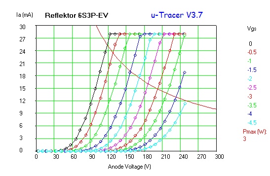

6S3P ~ EC86
Very different features.
EC86: mu = 68, gm = 14,5 mA/V, when Ug = -1V, Ia = 20 mA, Ua = 175 V
6S3P-E: mu = 50, gm = 19,5 mA/V, when Ug = -1V, Ia = 20 mA, Ua = 140 V
Indeed, this is one so those so called "internet" equivalents just like this 6N1P that is touted to be a 6DJ8 which it is not etc.
It seems that there's quite some to sample variation with this particular valve type. Then there's this 6S4 too which is also quite similar....
Has anyone traced the curves of various 6S3s ?

Here is a 6S3P-EV that I traced a while ago:
I need to redo it now that I am sure the tube can take 300v.
I've added to the simulator 6S3P-EW triode. It's a very interesting tube. I have a large tube collection but I do not have that in my resources 😡. I would like to share three observations.
1. The 6S3P tube has an extremely favorable characteristics for modeling. This is due to the fact that for the zero grid voltage, anode curve is similar to the curves for negative biases (even for very small anode currents) - there is no trace of saturation phenomenon.
2. In the manufacturer's datasheet I used for traversing data there is probably a mistake. For the anode voltage 150V and grid bias -1.5V datasheet says that S = 19.5[mA/V], mu = 50[V/V], and Ri = 5K. This is not possible if only taking into account the formula that mu = S*Ri. The simulator gives the correct values. Please check it out.

Rotaspec, how many tubes did you sample?
I had trouble finding two equals within a batch of 20!

It shares this characteristic with the EC86 and ECC88.
I looked into this when searching for a better valve to use as a MC level amplifier where Vg = 0 (i.e. cathode is grounded).
Another very interesting one for this kind of service is the 6N1P.
