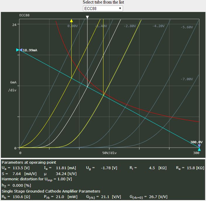

I am afraid that the problem is connected with the schematic diagram (wrong supply voltage - 250V), not with the triode simulator. It is impossible to have high supply voltage 250V, load resistance 2K5 and anode current 60mA. Look at the manufacturer anode characteristics od 2A3. When you have only 100V on the anode (250V - 60mA*2k5 = 100V) and bias voltage -45V the anode current is much more less than 60mA.
I thing that voltage 250V should be applied directly on the anode of 2A3 (point marked with 2 on the schematic diagram), and supply voltage should be around 400V (250V + 2K5*60mA = 400V). See the attached example.
The schematic isn´t wrong. The load specified is that of the reflected speaker through the transformer which corresponds to the AC loadline and pivots about the operating point (250V 60mA), while the DC loadline is an almost vertical line corresponding to the DC resistance of the output transformer (Because of this one can assume Vp=supply voltage)
Your program is excellent for designing resistance loaded stages, but in most cases it would not work for designing output stages due to the limit imposed on the plate voltage. Bear in mind that during half the cycle of a wave, the output stage will swing a voltage higher than the supply voltage due to the AC and DC loadlines being different.
In the image, line A-B represents the AC loadline while line Vq-Q would represent the DC loadline for a transformer with 0 DC resistance (perfectly vertical), when the grid swings 15V negative from the operating point, the plate voltage becomes 300V which is more than the DC supply voltage of 250V.
Once you wrap your head around this concept I´m sure you´ll understand a lot of things that would otherwise not make sense.
I managed to get zero distortion!
Yes, you are absolutly right 🙂. This "phenomenon" results from the finite accuracy of graphic method of distortion calculation. This is not Fourier Transform !!!, but computer simulation of old method used by engineers half century ago. In simulator accuracy is much higher than in manual method, but still finite.
In your example, lengths of sections used in the calculations are practically equal. This is evident even from the drawing. Therefore, almost zero distortion associated with the second harmonic. In fact, the graphical method of calculating distortions is associated with the cases that individual harmonics may even be negative (there are many examples in old books). No wonder that under certain conditions in the vicinity where the sign changes (- to + or + to -) the evaluated values are close to zero.
We all need to be aware that the results of graphical operations on the graph depend on the accuracy of the mapping of tube model. This is why I reccomend to verify presented tube characteristics.
Thank you again for above example 🙂.
