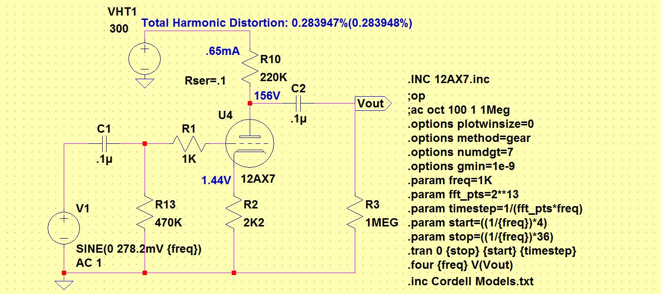

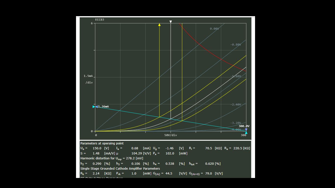

correspondence between GSMOK load line calculator and LTSpice prediction is pretty good (save for the THD figure, that is completely off)
