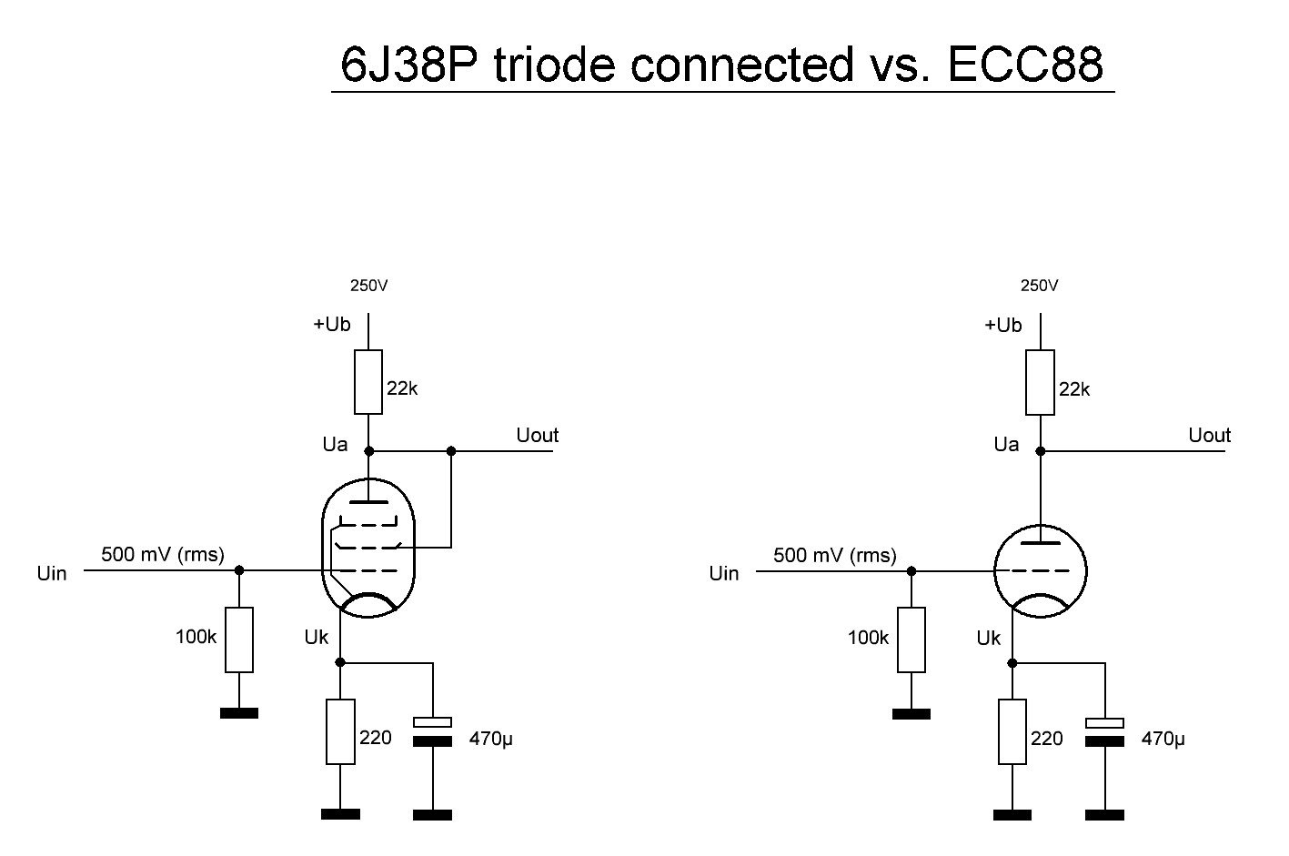

I made a comparison between 6J38P and several ECC88-types.
I also included 6N1P-EV, 6N5P, 6N6P-I and 6N6P though these are known to have different specifications.
Attached are the test circuits I used. Supply voltage was fixed 250 V and AC-input voltage 500 mV (rms).
Test results are in the attached pdf-file.
  • 6J38P triode connected vs. ECC88.pdf

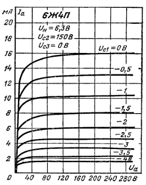

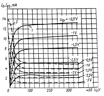

Ef183 is a remote cut off pentode, maybe not great for Audio……
Remote cut off pentodes are great for audio if to use them at relatively high current, they are even more linear than similar sharp cut-off pentodes at the same current. Atteched: 6BA6 and 6AU6 (6К4П, 6Ж4П)
