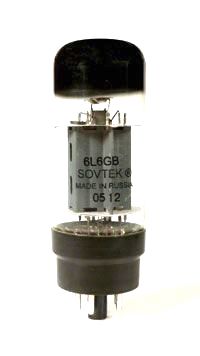

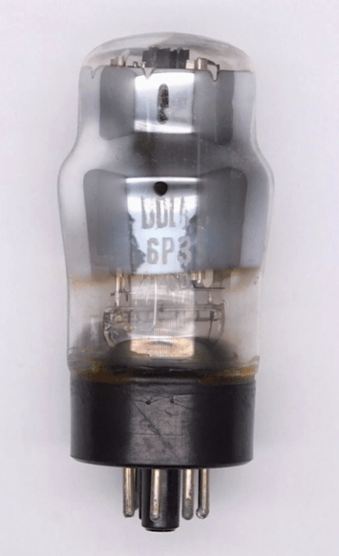

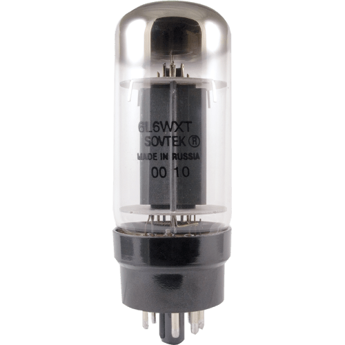

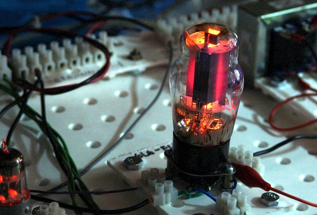

Currently trying out a pair of Sovtek 6L6WXT. Not the 6P3S you liked - it has a staggered black base not a straight one. This sounds like the best yet. It's a lighter sound than the 6P3S-E but with good piano and tone, and doesn't seem to have any rolled off highs. Promising. All the 6L6 types I tried had better tone than the EL34 in triode. It looks just like the 6L6GB. My pair are older than the current ones.In order of my preference from back then, I liked:
- 6V6GTA/B - Sweetest sound in triode. Low power limits its usefulness.
- 6P3S - The Russian 6L6GB clone with the larger octal base. I thought that sounded something like the 6V6GT types. Still not a lot of power, though.
- EL34 - Good compromise between more power and that triode 'sweetness' we like (or think we like).
- It was a tie between 6L6GC and 6550A, depending on which brand, etc. They sound pretty similar, but of course the 6550A will get you more power.
- 6P3S-E - The Sovtek '5881' from back in the day, with the wafer base and the thick glass. It sounded a bit dull and less 'detailed' than an

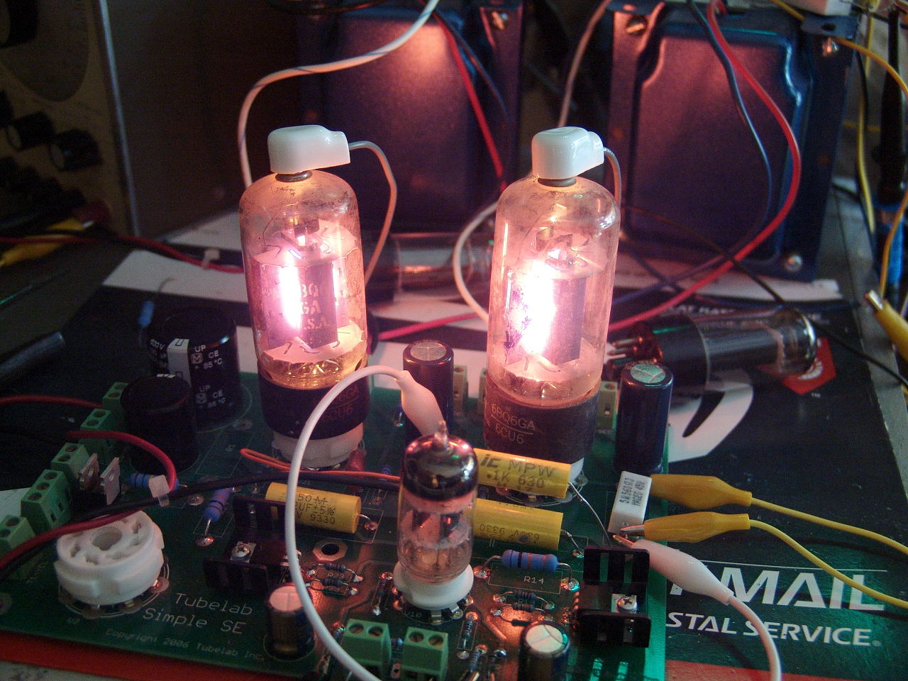

FWIW I have found there to be such wide differences in sound quality between different tubes of the same tube type I’m not sure I could make a generalization about a certain tube type’s sound. I have been using a variety of 807 tubes in my amplifier in both triode and ultralinear. There’s no way to confuse a Cossor vt60a with a Sylvania 5933 despite supposedly being the same tube type. That also applies to the Russian made “Feranti”, Fivre, and French Mazda 807 as well. Let’s pile on supposed 807 analogs like the RCA 6bg6 and STC 5b/254m sounding different as well.
So yes, I have heard differences between running Sylvania 7027a (in a 6bg6ga bottle), Chinese el34, 6ar6, and Sylvania 6v6 as well but at this point I’m of the opinion that different tubes sound different because they are different tubes. I mean they are literally different. No two tube manufacturers made tubes the same way, even for the same tube type. And while the curves of the same tube type are supposedly close-ish it has never been clear to me how the curves look translates to how the tubes sound. Or if the curves can capture “the sound” at all. I try not to engage in audio woo too much but I wonder how two tubes made with different materials and different shapes could ever result in the same sound even if they look similar on a scope.
Indeed - tube inner structure is not surprisingly the major factor in sound differences, rather than the logo on the bottle. With 6SN7s I prefer all the angled plate versions whatever the name on the front is. This runs counter to tube folklore which differentiates between RCA, Sylvania etc.
So on to my last tube test - the Ruby labelled 6L6GCMSTR. This was similar in general sound to the 6L6WXT+ Sovtek, but a bit inferior across the board. Less clarity, slightly more wooden piano, slightly more shut in and a little coarser.
So out of my EL34 types and 6L6 types the best one was the 6L6WXT+ Sovtek. My pair are several years old, but still the current model available from several sources since they're used in stage amps. Price from Hot Rox is £35 each including tax in the UK. They are described there as ....
"Modelled after the vintage RCA 6L6GC "black plate," the Sovtek 6L6WXT+ features larger plate dimensions and improved grid structure for increased power handling capabilities. The 6L6WXT+ also features mica spacers with metal springs to eliminate tube rattle and microphonics. The Sovtek 6L6WXT+ yields a 20% higher output than the Sovtek 5881WXT and offers superior tone and overall performance to any 6L6 or KT66."
So higher power as well. Win win result.

"The Sovtek 6L6WXT+ yields a 20% higher output than the Sovtek 5881WXT"
Be very careful with these guys: I've got a bunch, and they belong to a very different species.
A normal 6L6 at Va = Vg2 = 250V requires -14V at the grid to yield Ia = 72mA and Gm = 6mA/V
The 6L6WXT+ needs -16V to yield Ia = 82mA and Gm = 7.8mA/V! (average of 16 pcs.)
You might get away with self-bias, but expect surprises with fixed bias!
IOW, re-biasing is mandatory.

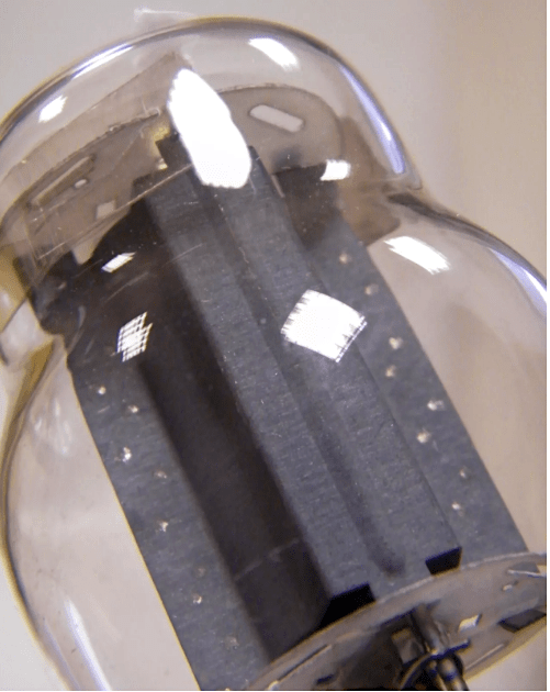

Funny how different people are, I find the angled plates clearly inferior to various T plates and ladder plates in 6sn7 tubes.

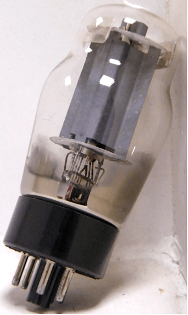

Somewhere between 10 and 15 years ago Antique Electronics Supply was selling these with the "bait" that "they couldn't blow them up no matter how hard they tried," so I took the bait. These poor guys have "seen the light" lots of times, and after lots of abuse, they are STILL ALIVE! Seen here at about 40 watts of dissipation. The coke bottle shaped tubes were replaced with some straight sided tubes that WERE far too easy to blow up. I bought a box full of "NOS" 6BQ6GA's from AES for under $1 each. A few were not NOS, so I took the crustiest oldies and stuffed them in an SSE and decided to see how much power I could extract from them. Let's just say that you can get 20 WPC from a 6BQ6GA, but you pay for it in lifetime. These lasted about 20 minutes before the THD started climbing, and a few more minutes before my bench power supply started complaining and smelling funny, so I killed the experiment. The tubes didn't seem to work very well the next day. I wonder why?Anyone tried the coke bottle shaped 6L6?
View attachment 1352547View attachment 1352548View attachment 1352549View attachment 1352550
As for the sound of the different tubes mentioned, all of them can be dropped into a Tubelab SSE with no changes, but the big boys (KT88 and 6550) will benefit from some more current which was afforded by a resistor on alligator clips connected across the existing cathode resistor. For chick singer and a guitar type of "simple" music the EL34 in triode was the clear winner. The big boys in UL had the edge when trying to rattle the neighbor's windows with DSOTM cranked to the edge of clipping into some 15 inch Hawthorne Silver Iris OB speakers. Cathode feedback was used without any other feedback in both cases. The coke bottle 6L6GC's were OK sounding in an SSE, but screamed pretty good in a cranked guitar amp, so that's where most of them went.
For daily listening I tended to swap tubes whenever I got bored with whatever was in the amp. I think that a pair of old Electro Harmonix 6550WA's got the most playing time.
A mosfet (a 'la Tubelabs Powerdrive) would do a better job than a tube but I like the delayed startup from IDH tubes, plus the fact that they don't fail as shorts like Mosfets do.Of course, it is elegant! Another huge advantage is good protection against thermal runaway, which caused by grid emission.
With a little trickery, cathode followers can be used to bias the output tubes into complete cutoff until they are warm and ready to draw plate current.
Probably not much of an issue with 6L6-like tubes, but handy for DHTs.
