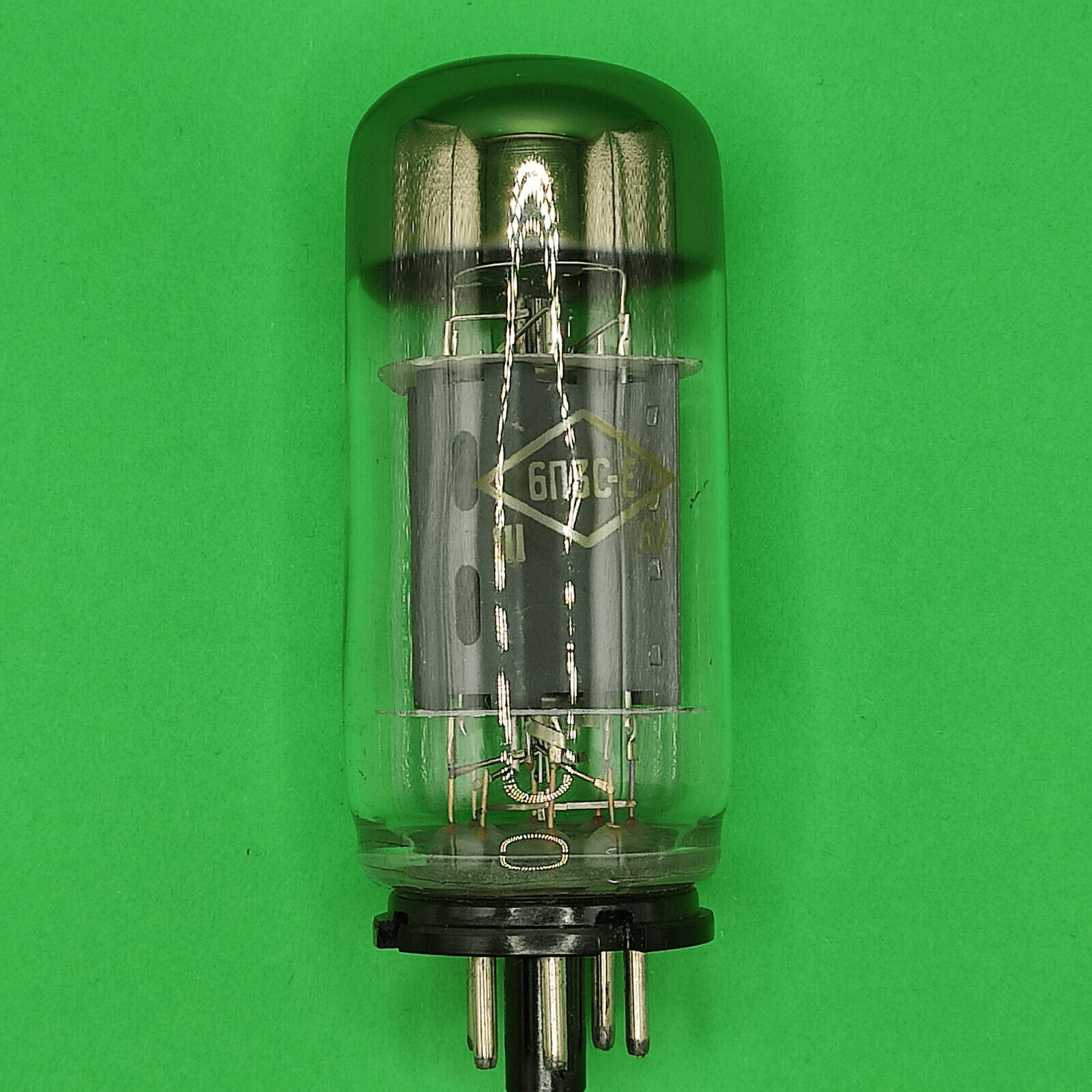

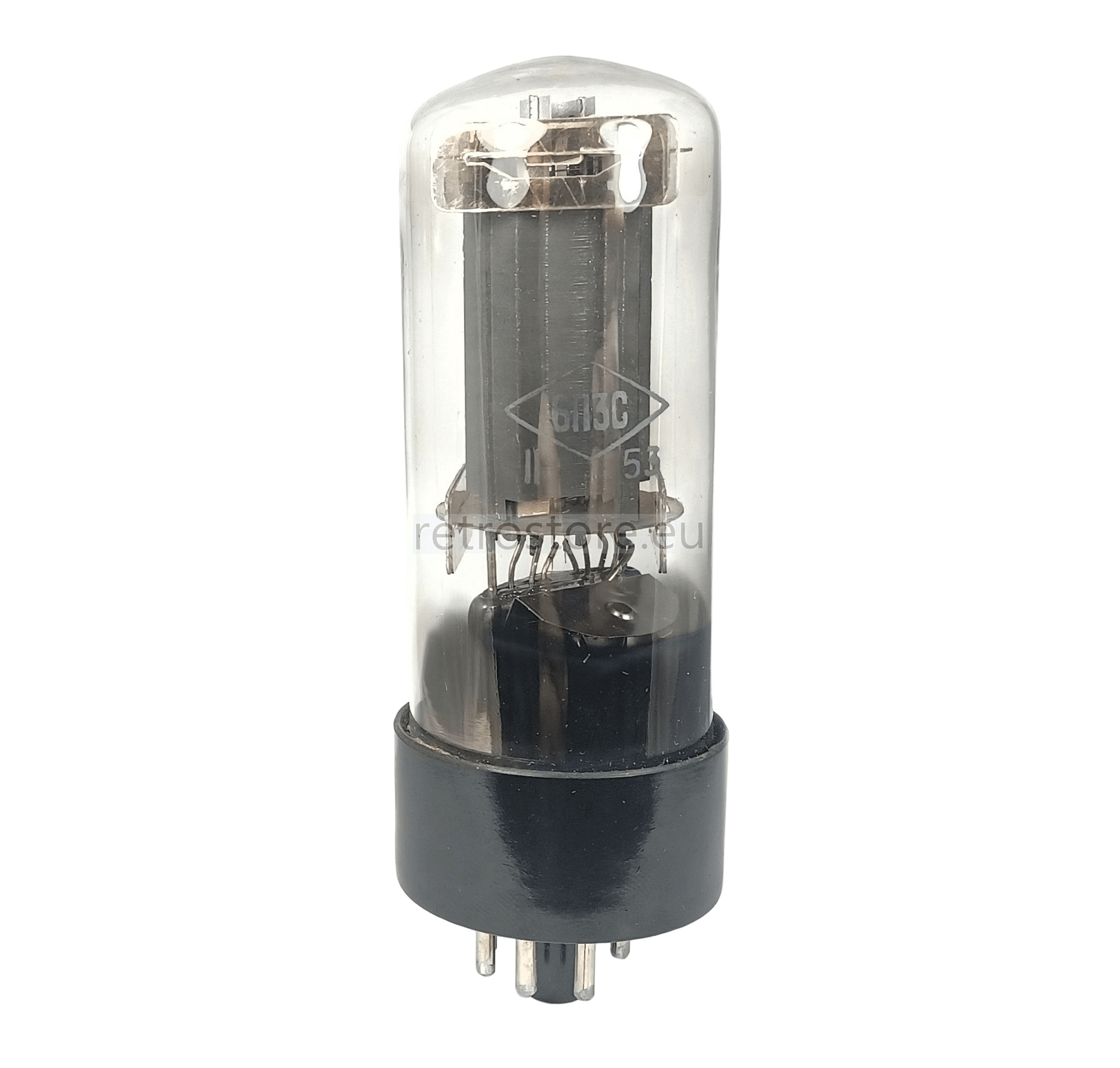

Does your Sovtek 5881 look like this? That's actually a 63PS-E

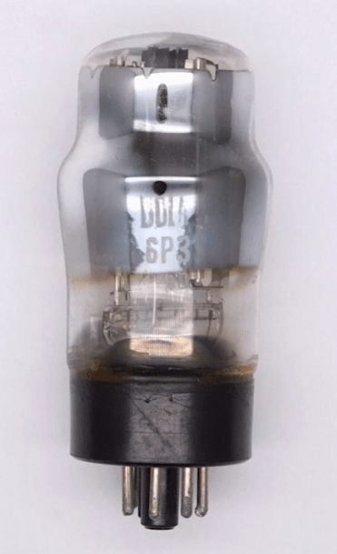

Or does it look like this? This is a plain 6P3S (no "-E").
If your "5881" is a 6P3S-E, then yes, I noticed that the high frequencies sounded kind of dull, but they're not measurably rolled off. I even noticed this in Fender guitar amps. The 6P3S-E would take the 'sparkle' out of the sound. Or you could say the 6P3S-E reduces some of the 'edge' and overly bright attack some.
From memory, I agree with the EL34-triode 'airy' assessment. I found the Russian 6P3S (no "-E") gave some of that, but without the edginess of the EL34 (or the 7591). The Russian 6P3S-E ("5881") was anything but 'airy'. At least, that's what my impressions were 30 years ago.

Thanks Rongon - that agrees completely with what I'm finding. The EL34 as slightly "edgy", agree there. Are there any EL34 types that don't have this slight edginess and have a better piano tone?
My tubes are the coin base 6P3S-E. And yes - dull in the extreme treble, noticeably on drumkit with snare rimshots and cymbals. This is a real shame, since the tone is lovely.
I'll have to try the Russian 6P3S (no "-E"). Maybe the Ruby 6L6 is the same tube?

andyjevans - You might want to pick up a couple of Russian 6P3S and try those. They sound quite different from the coin-base 6P3S-E type. I like them better, but they tend to red-plate with >400V applied to plate and screen (which is where most guitar amps use 6L6s). I figure the 6P3S is more of an equivalent to the old 6L6GA type, with max plate volts = 360V and max screen volts = 270V. The 6P3S-E can take 450V on both plate and screen and last a good long time with no issues. Very rugged.

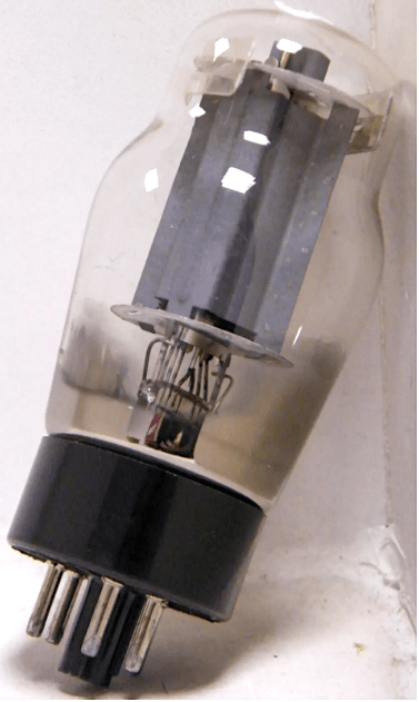

Nice looking tube.
And I expect the tube to be good "sounding".
Remember, the plate dissipation rating is 19 Watts, not the 30 Watts of the GC version of the tube (it is OK for me, 19 Watts is more than I stand in the plate, even if it is the GC version).
That IS a shame, as I've used them in my old Jolida 302b, triode strapped, and never thought they were dull sounding. They were my favorite over RFT EL34's and "super" 6BG6GA's. This is PP Class AB amp.My tubes are the coin base 6P3S-E. And yes - dull in the extreme treble, noticeably on drumkit with snare rimshots and cymbals. This is a real shame, since the tone is lovely.
