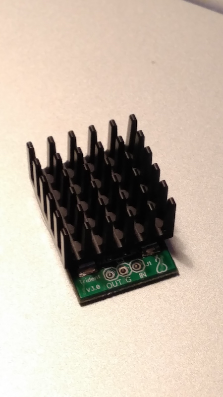

My Trident SR 1.0, 3.3 volt regulator has failed (.7 VDC out...) I assume it is the chip, perhaps a bad chip? Anyone other failure modes I soul be aware of? I cannot replace the chip because I cannot solder the power pad... so I guess I'll just purchase a replacement. My DAC runs a bit hot, maybe a small glue on sink on the chip would help?
I will send you a replacement. The 3.3V regs on the Buffalo should not be drawing anything near enough current to get particularly warm. Still, could try adding a small HS. This is one I had been experimenting with on a V3 Shunt Trident a while back...
